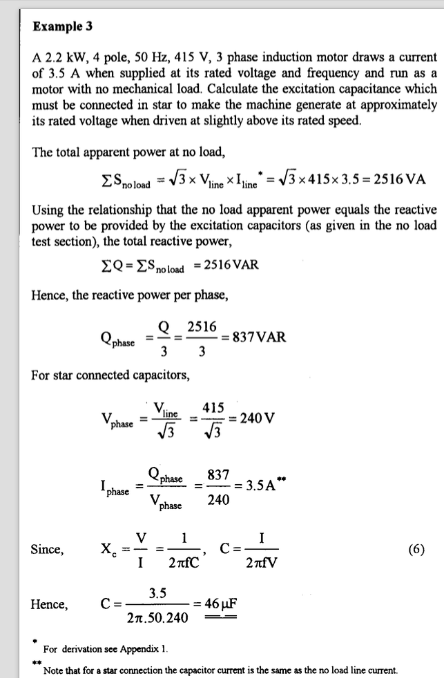

Got a question for someone who is a math wiz?
In Nigel Smith's book there are formula's for calculating capacitors for induction generators. http://www.fastonline.org/CD3WD_40/JF/JF_OTHER/BIG/Motors%20as%20Generators%20-%20N.%20Smith,%20%20ITDG%20UK%201994.pdf
I figured out the full load slip equation with no issues. However, How do I work the capacitor calculation on page 36??? The bottom part of the equation is what is causing me all the grief. What do the symbols mean exactly?

This is what I see as page 36
I think you want to know the capacitor needed.
The second last line produces the final equation to use
when you already know the current and the AC voltage.
In this case, he uses 3.5A as the current and 240V as the voltage.
50Hz is the frequency.
He then plugs these 3 values into the last line's equation.
C = 3.5 / (3.142 x 2.0 x 50 x 240)
= 47uF
I assume you have obtained the current for your situation?
You would use 60Hz and 120V, and just do the above calcs.

poida, You are a magician.
I wish they had just wrote the equation like you did there.
I most likely will have many more questions as I work through the book.
Now I need to remember how to work this old calculator. I keep getting 4.5uf. I haven't used this thing in over a decade.
My motor is 14 amps at 208 volts and is a 5HP 3 phase machine rated for 208/230/460v AC. The amps go down as the V increases. I am figuring the caps for both Wye and Delta at 208 volts. I get 120v from any phase to neutral or the star point depending on how you know the setup.I really should just figure for 240 volts since I will be seeing 230/240 in operation as a generator. Speed needed for 60hz will pretty much determine that the voltage is going to be greater than 208v.

Ok Poida, I ran the equations for my 5 hp motor and here is what I am getting stuck on now.
Even if I run the example equation,
In my ancient calculator I get a long arse number. 4.6417356e-5
How do you turn all that jibber jabber into something like the 47uf of the answer to the example?
For my motor I plugged in the following,
14/ (3.142 x 2.0 x 60 x 230)
I get 1.614406037e-4
So what am I doing so horribly wrong here?
Robert

poida
Joined: 02/02/2017
Posts: 1497
Posted: 02:48am 15 Aug 2019
Robert
The long number is just extra digits we can ignore for now.
4.6417356e-5 is about 4.6e-5 and the same as 4.6 x 1/100,0000
The unit is Farards in this case.
The "e-5" means divide the number before "e-5" by 10 to the power of 5,
or 100,000
4.6 x 1/100,000 is the same as 46 x 1/1,000,000 or 46 millionths or 46 micro somethings
So the 4.6417356e-5 is pretty close to the 47uF used in the example.
1.614406037e-4  in microFarards or uF is 161uF
Just think of it as 1.6 x 1/10,000.
We want how many millionths.
"Scientific notation" is what it was called when I was at school.
