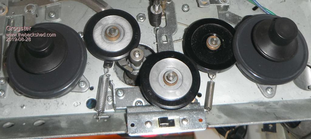

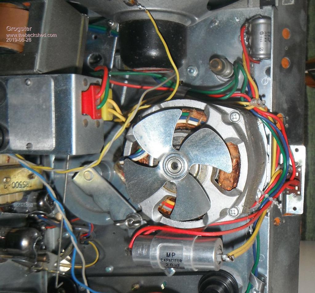

Inside the guts at the rear, showing the motor:
Other side of motor showing rubber drive wheels etc:
I note that there seems to be TWO start-caps on this motor, as the little slide-switch is a tape-speed switch, which changes the speed of the motor when it is running.
If I power-up the unit, the motor does not start and I have to flick the spindle(between the two rubber drive wheels), then it spins-up, but it is slow to spin up even then.
As I say, as soon as you put any load on it, it just slows down to a crawl and if you keep the load on, it stalls completely.  If I let go of the motor at that point, it DOES NOT spin-up again.  If I flick it manually, it does.
I don't really know the ins and outs of induction motors, so this is why I am hopeful someone here can at least tell me if I am going in the correct direction towards a fix for it.
I suspect the start and/or run caps.  My plan at this stage, is to replace BOTH the caps on this motor, in the hope that this will restore correct operation as far as starting of a stopped motor is concerned, but another question I have is: 'Does the start cap have anything to do with the torque of the motor once it is running?'  It could also be that the motor needs to be pulled out, disassembled, cleaned, lubed and replaced kind of thing.  If you have a crook run cap, will the motor still run but lack torque?
With the power off, the motor seems to spin reasonably freely if I just flick the fan at the back of it.  It does not seem sticky or anything like that.

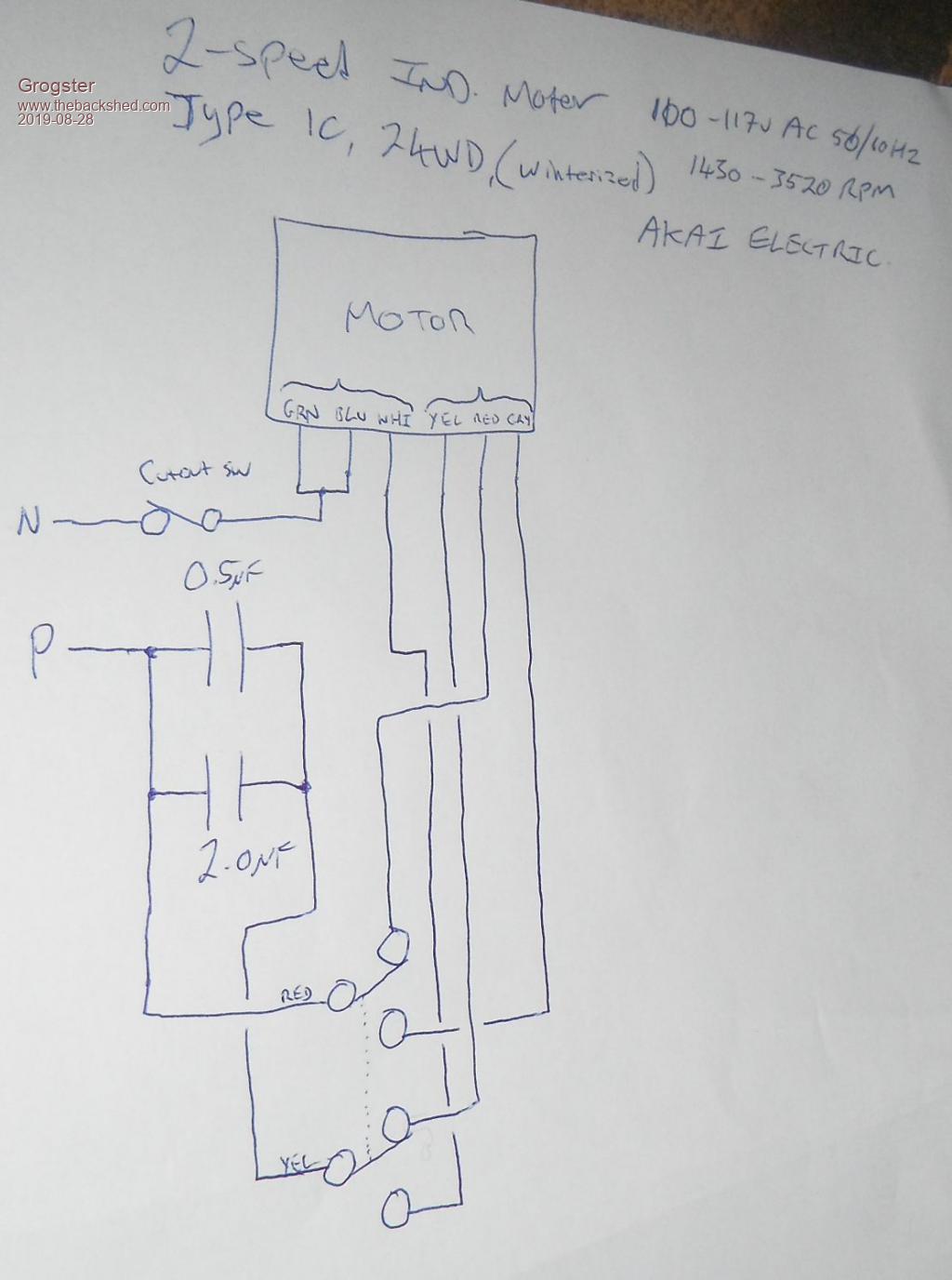

Here is a hand-drawn diagram showing how the motor is wired up:
Both caps are dated 1965, so I expect their dielectric has totally dried up and they probably aren't caps anymore.
This is where I plan to start, but some reassurance from those who know more then me about induction motors would be nice.
The 'Cutout sw' is a micro-switch that is activated by the tape-tensioner arm on the take-up spool side of things.  If the tape goes tight, this arm is pulled upwards by the tension, and trips this switch, which stops the motor.  I don't like switches in the neutral, but this is how it was built, so....
EDIT: At this stage, I am planning to replace BOTH those caps with one single 2.5uF cap such as this one.
Thoughts?

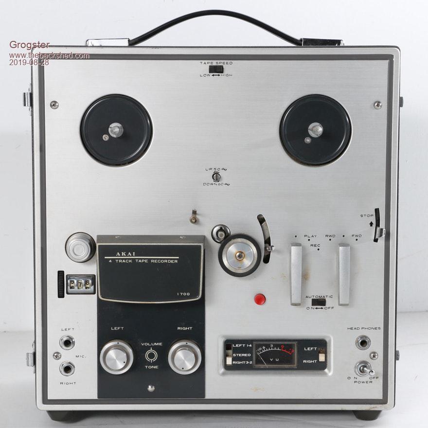

Tape recorder is GEC/AKAI 1700 series.  Here is a photo of the front of one - my one is currently in bits.

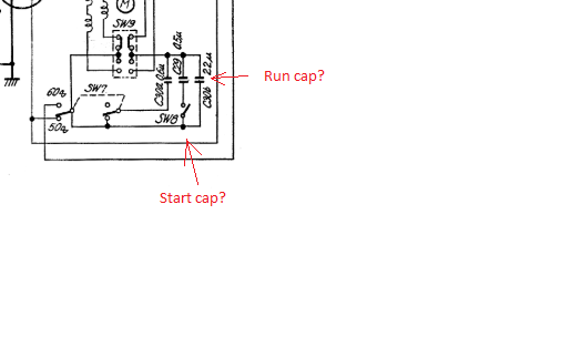

Are you sure that they get wired in parallel? The schematic suggests that C29 is a Start cap and drops out after the motor is up to speed (otherwise, why is there a switch?)
But in any case getting comparable values as replacements should do the trick. Just be sure that switch SW8 is functional.
Posts: 10071
Posted: 01:52am 02 Sep 2019
Yes, I was wondering that myself, but MY unit is NOT wired up like the schematic.
I have tested the caps connections using my meter, and they both are definitely connected in parallel.  The 0.5uF cap does not go through any switch.  That does make me scratch my head, as this does NOT match the schematic.
I note that in the schematic, they also show SW7 as changing things for 50Hz/60Hz, but on my one, there is NO SWITCH AT ALL on the frequency change thing.  It mechanically moves the main drive belt to the capstan flywheel between two different steps on the motor pully and the flywheel.
SW8 would appear to be the cut-out microswitch connected to the tape-tension arm, but this switch is in series with the neutral return from the motor.
