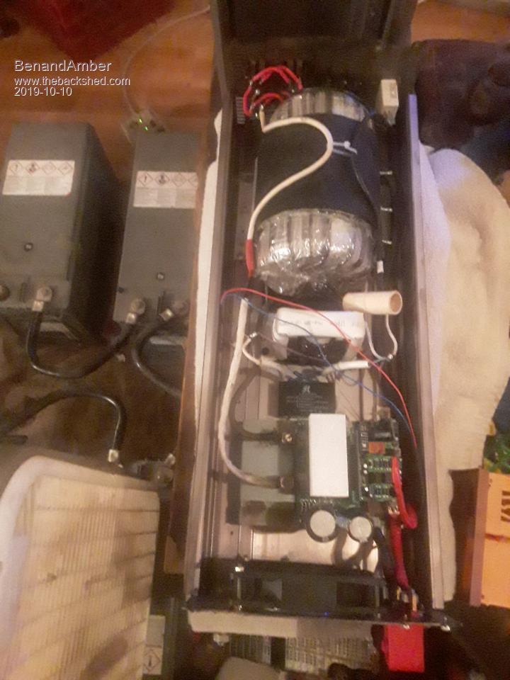

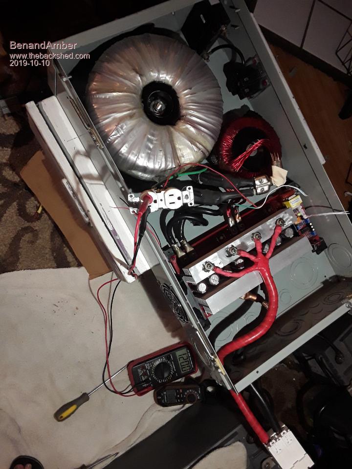

My big inverter has been doing great it will start and run anything and everything at once
It has the 10000w 24 mosfet china inverter board
It also has a Factory made over 50 pound 5000 watt toroidal Transformer
and the huge toroidal ferrite choke that me and amber made
I've had it hooked up with  solar panels make Sky Blue mppt charge controller and 8 batteries continuously in bus for several months now
The little inverter has been doing great also I gave it to my dad
Very impressed with it
It is the one that Poida the Great walked me through every step
It has the little $30 4 mosfet China inverter board in it

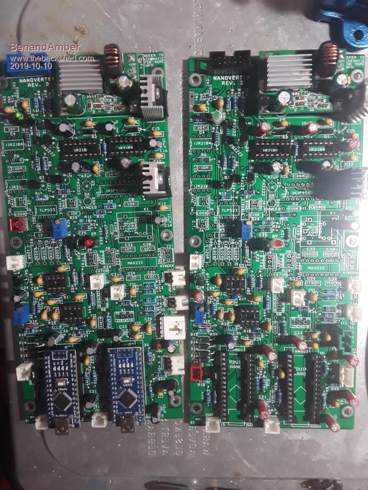

And the 2014 model Power Jack still waiting for The Nano to get programmed
I have 2 Nano boards built but have never figured out how to  program them yet

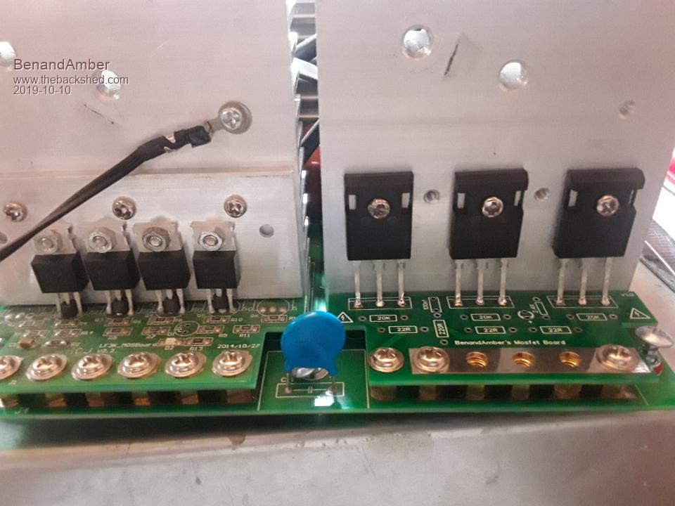

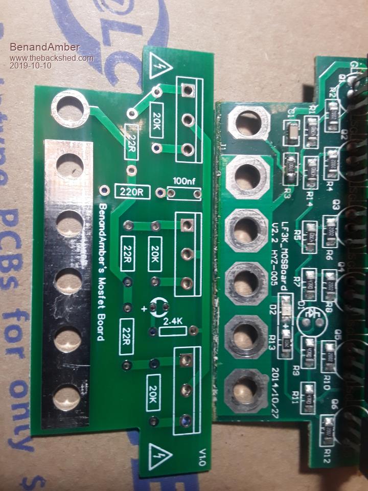

I sent a friend a set of the little Power Jack mosfet boards
for him to try out one day when he gets the extra time

Kentfield dude (the designer) was nice enough to make the file to have them made free to everyone

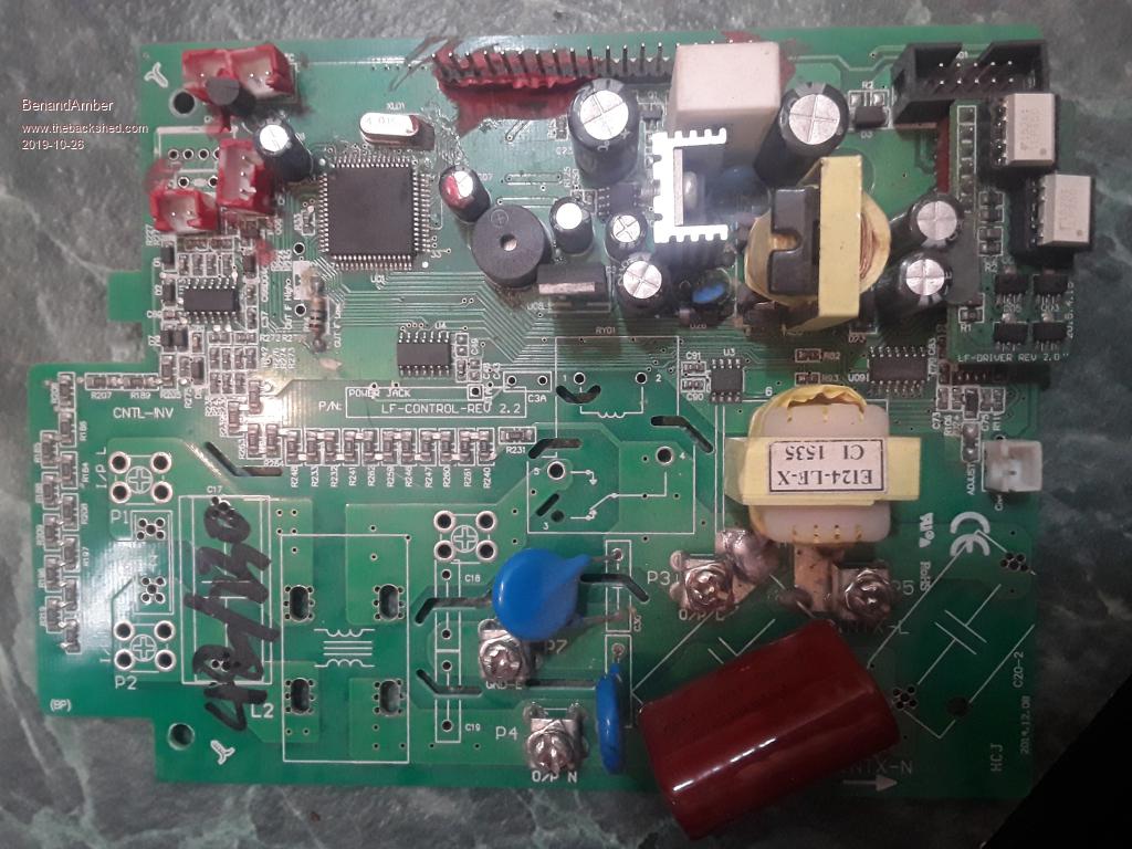

I have this old control board for Power Jack
If it might help with your testing Poida
It is 50 hertz in 230 volt

This would be useful for me.
I can't get any signal out of the self repaired driver board and I wonder if
I fixed it or there are other issues on the main control board.
Meanwhile I have had lots of fun playing with different ideas
using the powerjack power board and the little MOS boards.
The design of this makes it fast, easy and simple to change things over to the new test.
I will do some function testing using the little boards as you intended later when this board arrives. First test using one HY4008, then test it again using 3 HY4008.
All tests using the suggested component values Kentfielddude has on the silkscreen.
