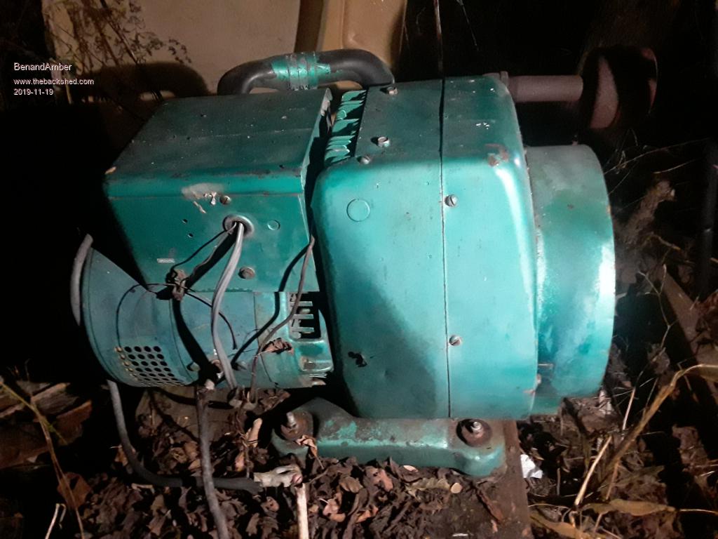

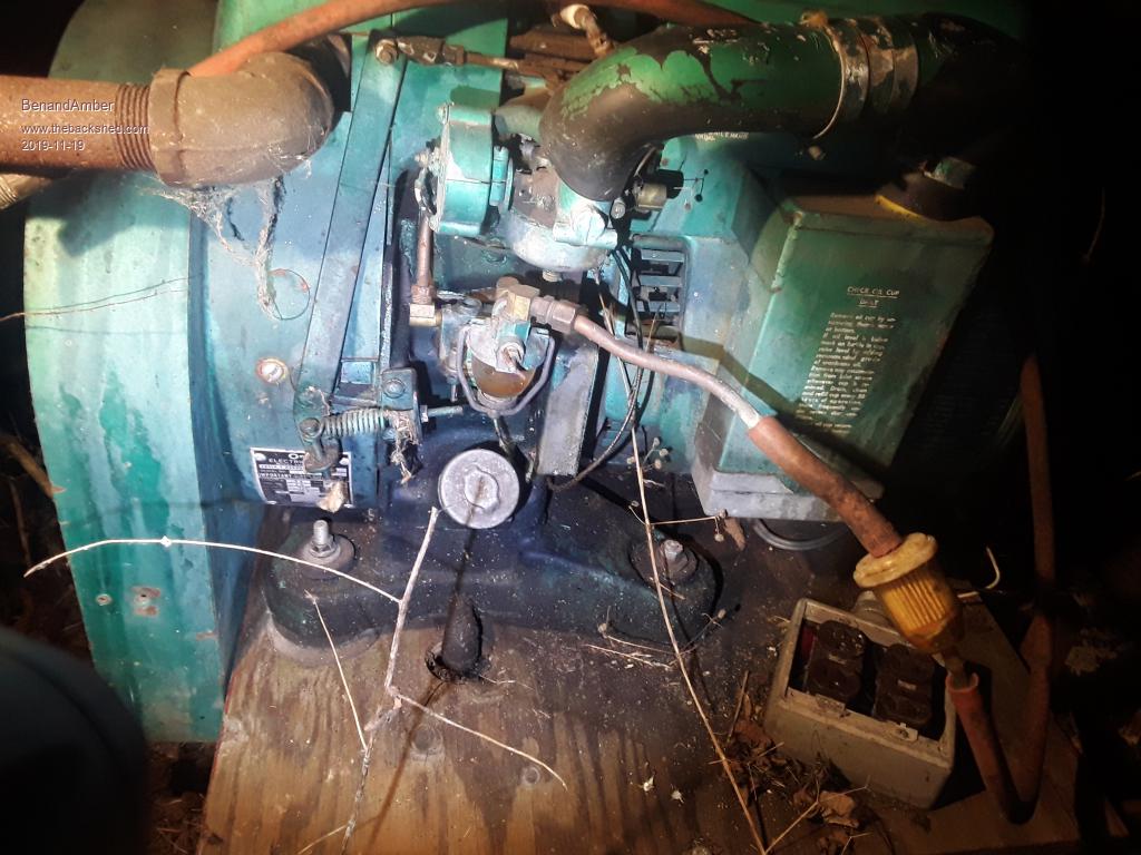

Hey Bernard, post some photos of it so we can appreciate it. I just love those old Onan's.

Haven't used it in a long time
I've had no use for it after finishing the first inverter build
Not that I can remember anyway
If I needed it it would start up very quickly
I drained all the gas out of it last time it was used
It takes a 12 volt car battery and it does charge the 12 volt battery
It has two outlets in one metal box
I have done absolutely nothing to it except putting new points in it and changing the oil
I would like to figure out how to change it over to a DC battery charger
It is 2000 watts 120 volts ac
It is ginormous and weighs probably three or four hundred pounds
It was built to last forever
It is on a four wheeled cart
it was on this cart when I bought it
It makes it easy to move around
