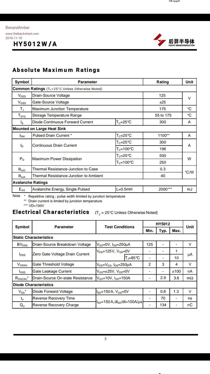

I just came across these mosfets
A few of you probably already checked these out
The reason I was looking was for those cheap little Chinese inverter boards
The ones that come with only four mosfets
The one that poida helped me with is still running perfect
These little boards are only thirty bucks on eBay
It would be nice to be able to up their output
I've even thought about putting two mosfet  in each single mosfet holes
I think this could be done by turning them around facing the opposite direction and putting them up through the bottom of the board
I don't know if this would work with only one resistor and diode for two mosfets
Thank all you guys in advance for your thoughts and discussions on this subject

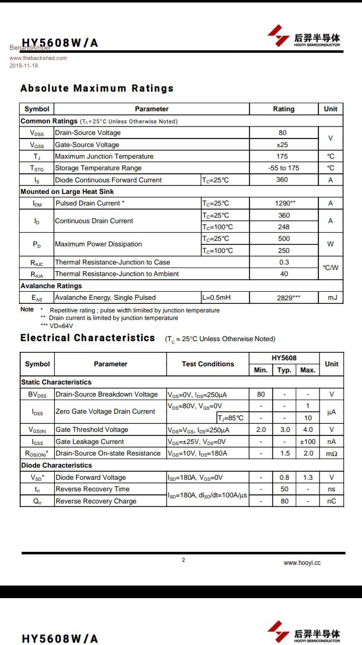

AU $22.42 | Aoweziic  2019+ 100% new imported original  HY5608W HY5608 TO-247 FET 80V 360A
https://s.click.aliexpress.com/e/ELtWNyNK
Costs about the same, and rds on is lower, not sure about current handling without real world use. But if datasheet is to go by, good alternative to hy4008s... didn't think that possible lol.

Noneyabussiness thanks for your reply 2000 Watts with 4 mosfets
I knew the hy4008 could do it for short periods of time
Good information to know that thay can do it all day
What mosfet do you guys think would give  the most wattage and use only 4 mosfets
How does the hy5608 or others compared to the hy 4008
