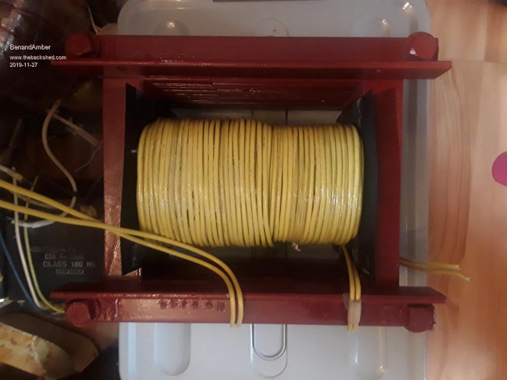

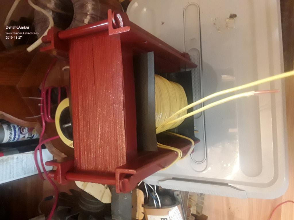

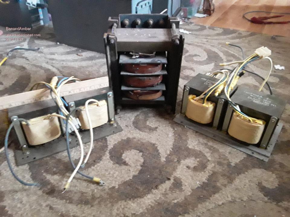

With the old wire this Transformers idle current was 0.07
None of the toroids I have are that low
I am rewinding it with two parallel 12 gauge wire
I think it's called two in hand
If the new Idol current is below 0.20 I'll be happy
It had 90 turns of the old wire on it
I'm over halfway done
I am going to put just as many turns as will fit
I will be leaving just enough room to squeeze in the primary
I weighed it on my bathroom scale and it's a little over 40 pounds right now
I am hoping for a 3000 watts continuously
Warpspeed will know exactly what it will do and he will not sugarcoat it
The Old Wire was in pretty rough shape
I reused this Old Wire after sprayed it with Transformer spray
I epoxied it as I was putting it on a toroid
I also brushed on a couple more layers after I was finished with each layer

We finished the rewind the idle current is 0.12

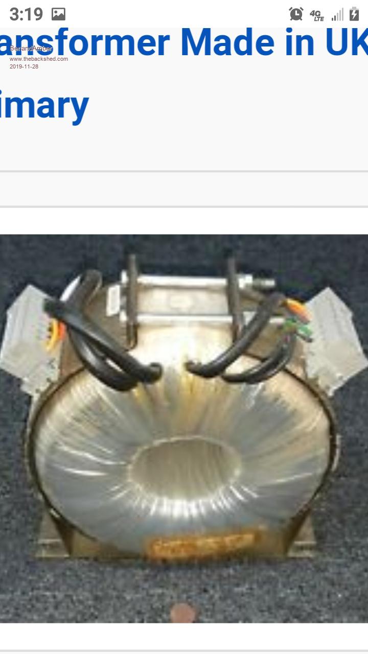

Also won the bid on a toroid on eBay
The guy didn't have any info on it he just knew it was 40 pounds

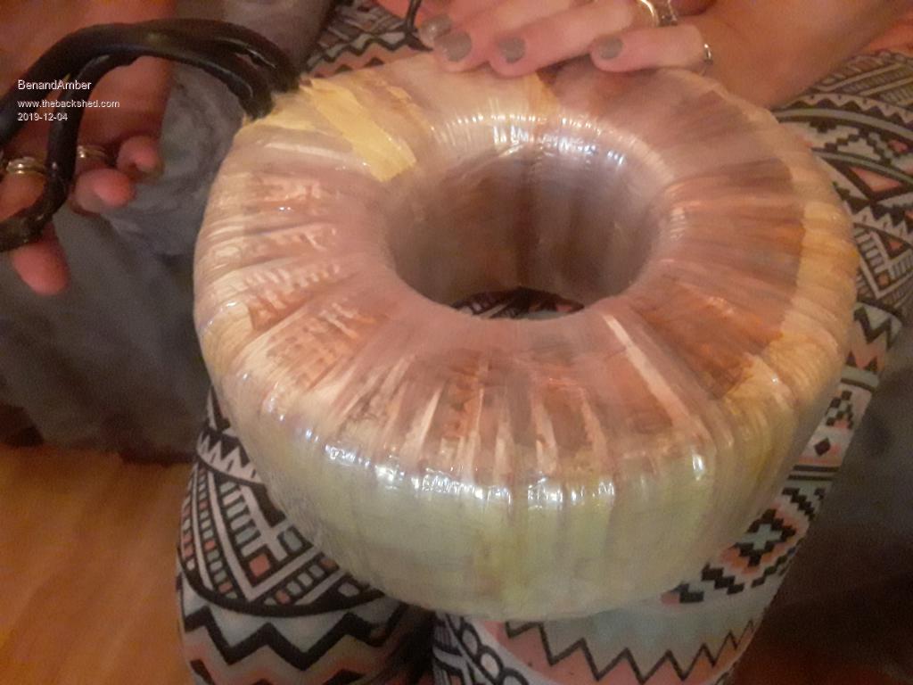

Transformer came sooner than expected
Top layer was a 12 volt winding
it had about five layers of tape on top
Second layer was a 220-volt winding
It also had about five layers of tape on top and underneath it
the last winding  has copper aluminum foil wrapped around it with some kind of ground wire
I stopped at one layer of tape above that
Idle current is 0.07
Seems to be a pretty nice Transformer
It supposedly came out of some kind of hospital equipment

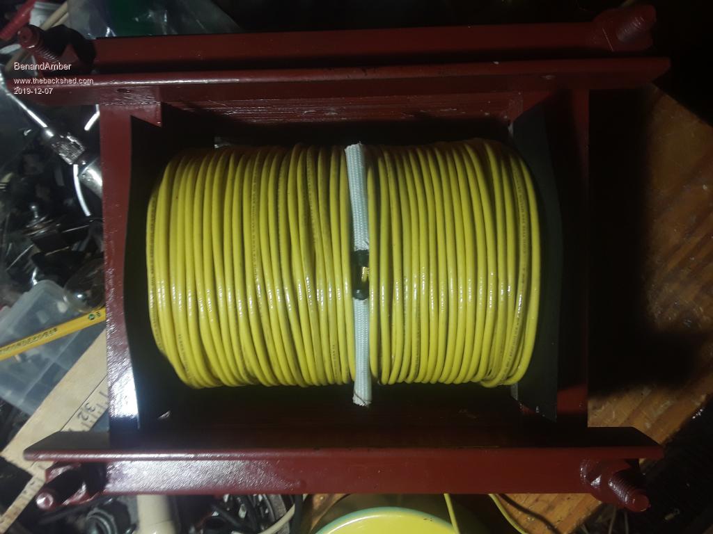

With my latest toroidal Transformer the one pictured above
I would like to try to figure out a way to match the copper weight of the primary low side to the secondary high side
The secondary is already wrapped on this Transformer
I would like match it without having to unwind it
Probably impossible but if anybody would know it would be someone on here
another thing I'm trying to wrap my head around is Tesla's hairpin circuit
if anyone has any information on these subjects I would greatly appreciate it
Thank you for your comment on the Square Transformer rewind noneya
It has a lot more wire on it since that picture was taking we filled it up as far as we possibly could still have room for the primary
Edited 2019-12-07 12:54 by BenandAmber

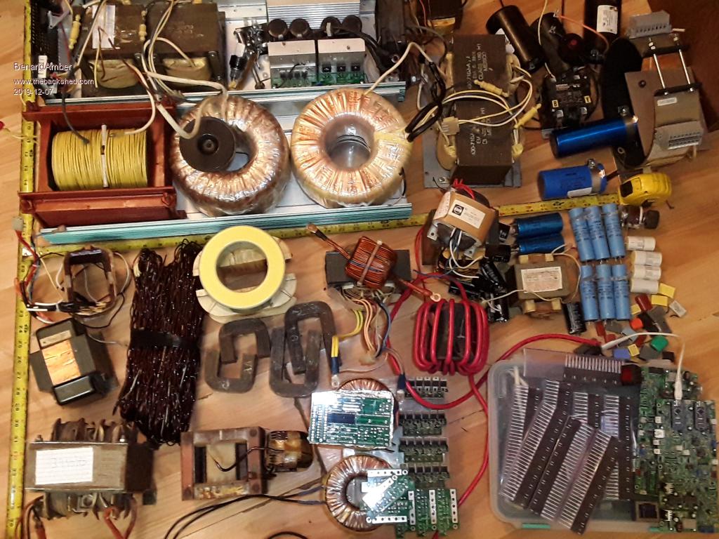

OK down to the fun stuff
In 1/2 of the inverter case you will see 2 APC Transformers
I have four of them they are identical
The fella on here that has tons of  capacitors in his solar set up has six of them
he said that two of them will do 4000w
In the top half of the inverter case you will see 3 Transformers
the square one is the one that  Amber and I just got finished winding few days ago
I thought I read somewhere that warpspeed said The more copper the better fill a Transformer up
so that's what we done
It is wound for a hundred and twenty volt secondary
It reads somewhere between 7 and 8 ohms across the winding
when powered up by 122 volts main Supply the idle current of the Transformer is somewhere around 0.11 to 0.13
Hope we didn't put too many turns on it
Any thoughts on that is appreciated
Moving on the toroid in the center is the one that me and Amber unwrapped a bunch of smaller toroids and made one large one
It has no primary on it yet
It only has the secondary
If I remember correctly it's idle current was 0.37 powered by 120 volt Mains
That seemed a little high to me
Each of the little toroidal Transformers it is made out of had two or three strips of silicon Steel
They were not made of one continuous strip of silicon Steel
So this big Transformer was made up of a lot of short strips of silicon steel
To make the Transformer thicker we built two of them and stackd them on top of each other and epoxied them together
We wrapped these shorts strips around thick-walled sewer pipe
this allowed us to pull extremely hard to make sure they were wrapped extremely tight
We also baked them in the oven and tried to match how thay are made at Factory
I think the higher idle current has nothing to do with the two toroids  being stacking one on top of the other
I think it has something to do with being made of so many short strips
Others on here will be a lot more knowledgeable than me about this subject
The first toroid the wife and I made was made up of 4 or 5 of these exact same small toroid cores stacked one on top of each other
It made for a very funny looking Transformer very tall but not very wide
It has a low idle current
it's a really awesome Transformer
I build a inverter with it and gave it to my dad he is still using it
I have a hunch that making a toroidal Transformer tall instead of wide makes for a lot better performing Transformer
Anyone that has information on my hunch please comment
Okay moving on the other toroid that is on the end is the most recent one we acquired
I am very impressed with this Transformer
it had several windings on it
Luckily the bottom winding is the largest awg (mm) wire and is a 120 volt winding
The idle currant at 122 volts was 0.07 amp
It weighed approximately 40 lb before I removed all but the bottom windings
As it is now it has one layer of tape
and under that layer of tape it has copper foil
this copper foil has a single wire coming off of it
Should I take this copper foil off??
is this copper foil wire grounded to the case when you build an inverter
As you can probably tell we have not yet wound the primary on it
Okay moving on the yellow ferrite toroid is the exact same as the one we wound for a choke for the 10000w China board
It is one giant ferrite
the choke beside the yellow toroid that is already wound  is made of four of the blue regular size ferrite core's
You can buy these already wound off AliExpress but they are very expensive so we wound our own
The one just like it on AliExpress they say it is good for 400 amps LOL
There is a audio Transformer that has covered windings on each of the two legs
It is made up of silicon steel but it is actually round instead of square shape
There are numerous other Transformer and inductor cores in this picture
We will be putting that power jack in the picture back together again pretty soon
As soon as I get the time to learn how to program those two Nano boards you see in the picture
If anyone has any suggestions tips or would just like to say which of these components they would use in that power jack
I would like to read about it
As you can see if you made it this far on this giant wall of a post
I like writing long posts and I like reading your guys's long post
You thought it was actually over didn't you just kidding lol
there's one last thing I would like to say
There is one thing in this picture that means more to me than all the others
it's a little green Square and it was gave to me for free
I will most definitely be using it one day hopefully  not too far away
The man that gave this to me is wiser than words can describe
he is very generous with his time and wisdom
I would like to give him a very special thanks !!!
And I would like to thank all of you guys on this form for sharing your wisdom thoughts and opinions
Thanks for reading and have a blessed day
noneyabussiness
Joined: 31/07/2017
Posts: 527
Posted: 08:11pm 07 Dec 2019
On the note of your new transformer,  leave the wires on there, wrap 10 turns of any wire and attach the 120v winding to 120v.. it will give you your turns ratio, and how many turns you need for your secondary... put the numbers (voltage on 10 turns with 120v side energized) here and someone can help you with it.. good luck with your endeavors..

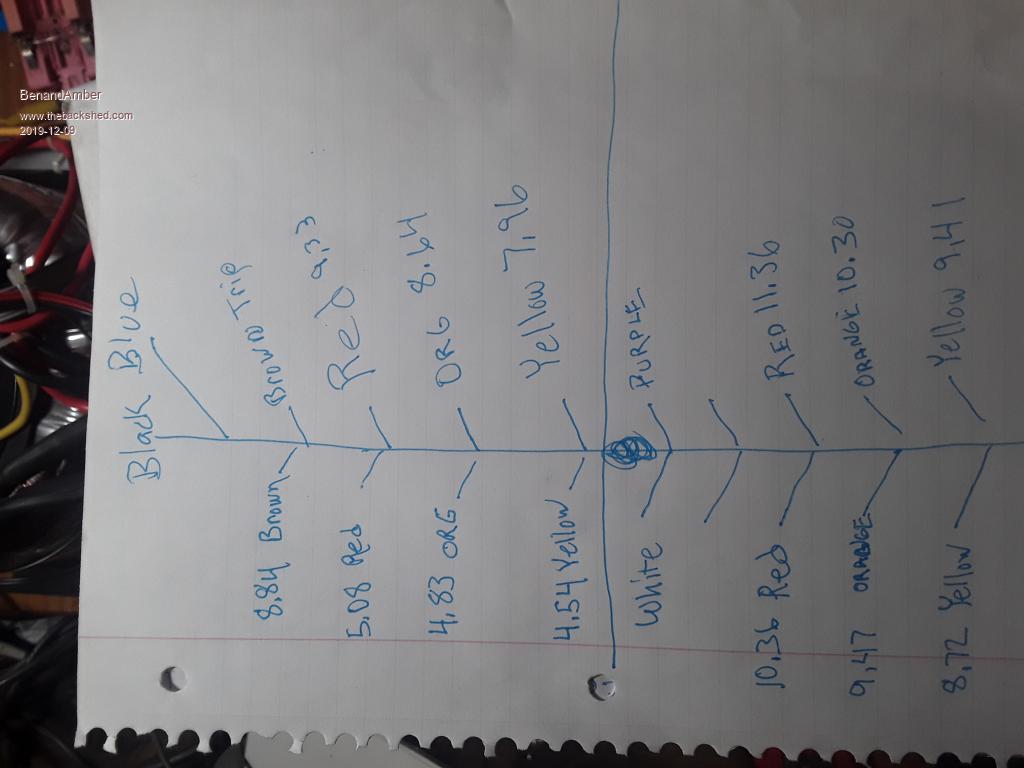

The chicken scratch in these two photos is an actual Factory built Transformer
This Transformer will not be used for a inverter
I am using it for a example to try to gain a better understanding
As you can see with my junky multimeter some of these lead combinations have zero idle current
The second picture is how I interpret these leads
it may be wrong
I was trying to understand which of these combinations would be best for a inverter Transformer
How do you know it is too little turns
How do you know it is too many turns
The formula 4 turns per volt I have been using has work well for me
I always add 10 to 20 more turns to it
I would like to understand turn ratios a little better for tweaking Transformers one way or the other
The wire combinations that have zero idle current do not turn the light bulb on
On the Transformers I hand wind the light bulb is always on dimly before I turn switch on
This post is kind of like learning how to fish instead of asking for a fish
Thanks and have a blessed day

PeterB
Joined: 05/02/2015
Posts: 669
Posted: 12:26am 10 Dec 2019
G'Day All
The rule of thumb I was given for 50 Hz transformers is 7 turns per Volt for 1 square inch.
To apply this you need to measure the area of the centre leg and divide 7 by that area.
for example, Some time ago Ben had a transformer with a centre leg 2 x 3 = 6 square inches. If you adjust things for 60 Hz it gives 1 turn per Volt and that is what Ben said he removed.
Another rule is, the primary and secondary should be of equal volume / size.
Another rule is fill the window. Thickest wire possible.
As for idle current, an unloaded transformer is a simple choke with an inductance of L Henrys. That gives a reactance of XL = 6.28 x 60 x L ohms and will result in a current of E / XL = 120 / XL Amps (that's for the funny US system).

Thanks Peter you were 100% accurate about that transformer
I stripped all of the wire off of it painted it with Transformer paint and rewound it with yellow wire
It was a 220 Transformer before and had three separate windings horizontally
I wound it as a single large 120 volt winding this gave it alot more room so I just kept on winding
I may have to take a few turns off of it
I'm trying to get my head wrapped around how this will affect it

The Square Transformer with yellow wire is wound in such a way it can be a single winding ,center taped ,or 2 in hand
Each end of the winding has two wires
12 gauge AWG type thhn
We Strung the pair of wires out  175 feet across our yard
that's around 350 feet of wire all together
We didn't count the turns we just kept winding until night fall
We cut both the wires so we could bring the transformer in
Later on that week we soldered both the wires back on that we had cut previously
Then finished winding the rest of the wire
Did I mention the core was epoxied together so we wound it like a toroid
No shuttle just pulling the wire through
Amber was ready to kill me !!!
I told her she was saying we needed to spend some quality time together
she just kept on say never again benjamin never again  LOL !!!
Now anytime I mention Transformer she gets her panties in a bunch
Just writing this has got her fired up
What would any good hillbilly do the Core was free wire was free had no use for either
Waste not want not right?
This might be a good time to look up the terms Jack leg or West Virginia hilljack
I figured this would give us a little bit of flexibility to experiment with because both wires are the  same amount of turns
As far as amperage that the two 12 awg thhn wires can handle I'm not sure
It would be 40 amps on regular household wiring on a shorter run
I have looked up so many amperage guides online and they're all different
Some say you use the chassis grounding guide
that's a little scary to me
Reminds me of a factory power jack Transformer
written down in my notebook i have what warp speed said about wire size and amps
off the top of my head I think it was 8 amps for every 4 millimeter squared
Don't quote me I would have to look it up I am probably wrong
I have went by the book on all the toroidal Transformers
Well close anyway
Just using what was free on this experimental Square One
Couple of nights ago I tried this formula on the internet for estimating wattage on E I Transformers
I'm not sure how accurate it is
it came out to under 1500 watts for this core

Not much going on on the back shed not in Electronics anyway
I think I'm going to juice it up a little bit next month
I want to buy one of them $30 4 mosfet China inverter boards
I am going to change out the mosfets to the highest amp mosfets I can find
Redo the tracks bulk them up really big and put some really big caps on it
I'm also going to use a oversize Transformer
I would like to see how high I can get the output wattage
Of course I'm going to do this on the smallest budget possible
I would like to get 3000 Watts continuous
I have seen 23 amps on the 120 volt output of the first one I built
It was very short like when starting a saw
I have heard people say that they will do 2000 Watts all day long if you have a good fan on them
I think first of all I'm going to learn how to program a nano I put it off for far too long
I also have those little power jack boards I need to try out
