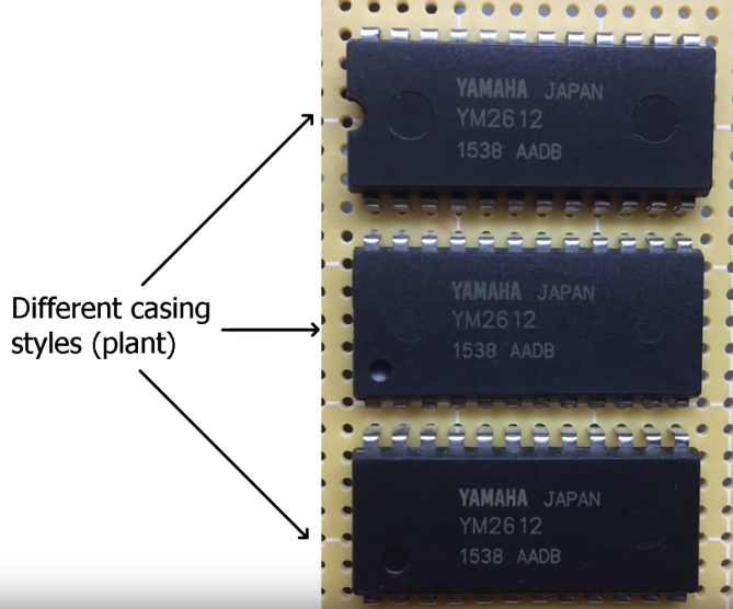

I have no problem with recycling - we should all be doing it, but this vid shows the scale of counterfeiting that goes on where components are recovered from old kit, "recycled" and sold as new stock... in itself that is bad enough but the chips often receive an upgrade in the process and often times they don't even care about the chip so long as its got the right package and pins... You want a 6116 2Kx8 static RAM? You could end up with a 16 channel analogue multiplexer in the same package badged up to look like a 6116.
Check this still from the vid:
three IC's. Identical part number, identical date code, identical batch - DIFFERENT CASINGS this absolutely cannot happen! and the sellers don't care they want your $$$ and will stoop to any cheat necessary to get them.
I know it's not a new phenomenon but it never occurred that a 6116 might be a 4534. You might get lucky and get what you want but new $ for old? and maybe "upcycled" to mil-spec or different speed rating? cheeky basts!
"enjoy" https://youtu.be/k72SFBOZ_lw

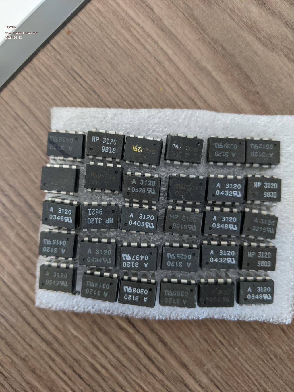

I have never bought chips from dodgy sources till yesterday actually! Always from Digi-Key, rs, mouser,element14.... We will see what comes in the mail in 3 months time.
when you are trying to get a new design going, you don't want that extra unknown variable in your bug fixing stage.
And if you want the design to work reliably over a long time, you just can't be questioning the quality of the components. Especially electrolytic capacitors and power components.
Now in the last week, as I contemplated building a 3 phase warpverter, I thought that since it will be just for fun and I won't be relying on it, won't be selling it, well, might as well try out cheaper components from AliExpress. Also I don't have a deadline to get something going, so waiting 3 months for some crap to arrive isn't going to annoy me too much.
Well the prices are good..... A tenth of the price of Digi-Key. But I'll be checking every component before it gets soldered, that's for sure.
I bought 60 X hcpl3120 opto drivers at $2.18 per 10 pack! The RS price is $2.90 just for one of the suckers!
Same for IGBTs and MOSFETs.
I still can't bring myself to buy electrolytics from anywhere but the quality places. Even for this hobby project. I've seen too many dry out and fail.

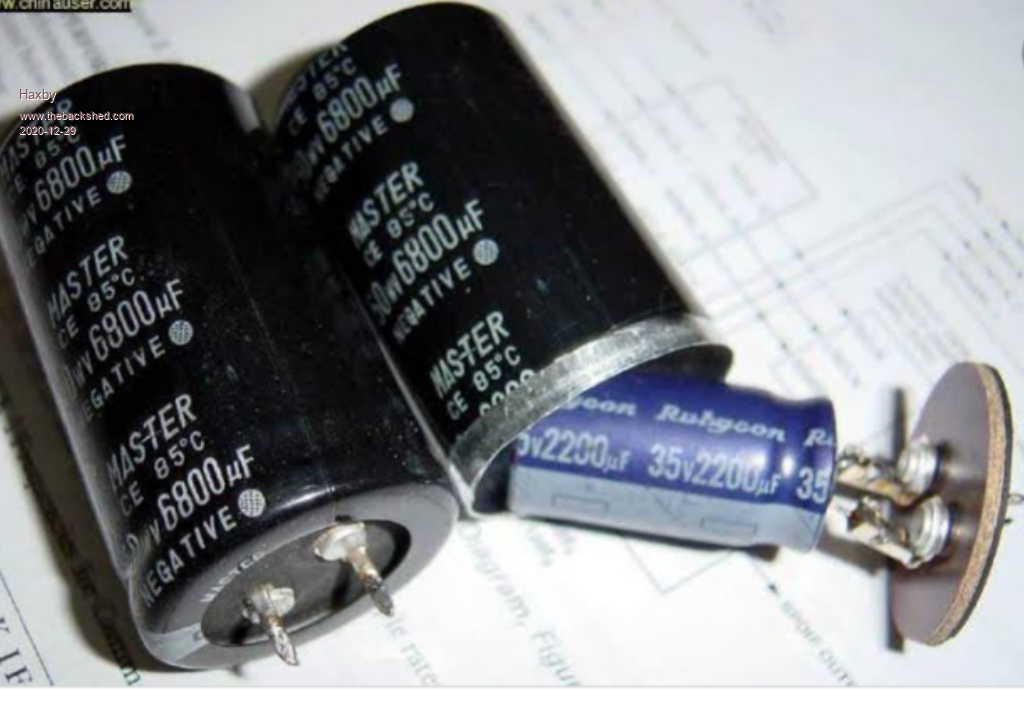

Haxby
Joined: 07/07/2008
Posts: 427
Posted: 02:25am 29 Dec 2020
Reminds me of this gem:

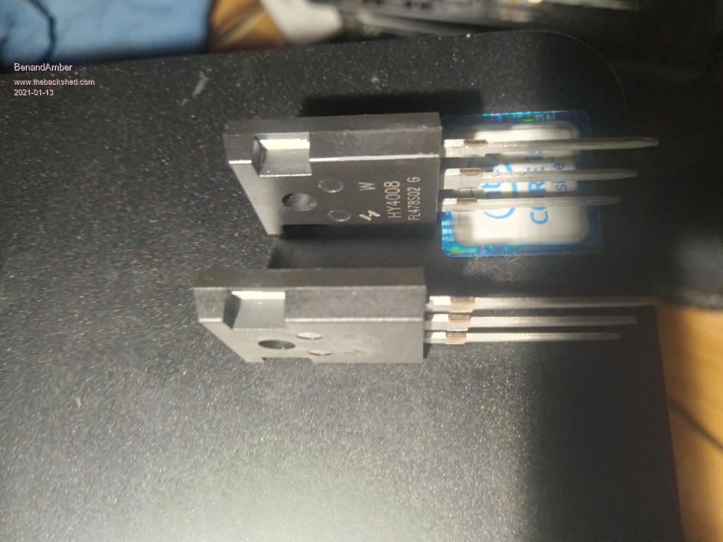

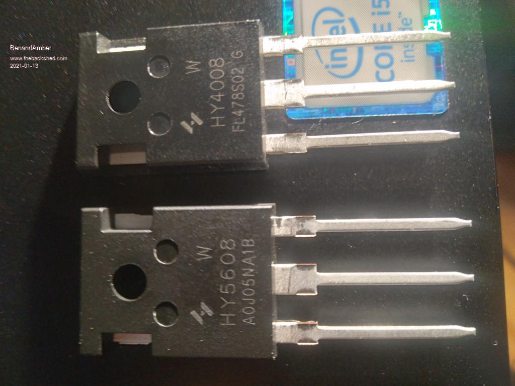

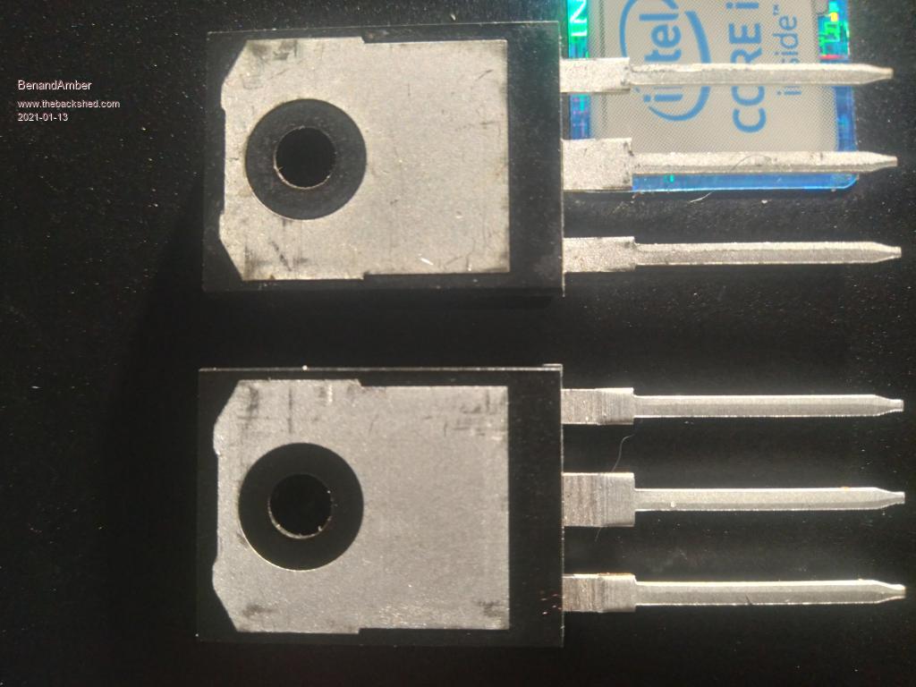

BenandAmber
Joined: 16/02/2019
Posts: 961
Posted: 04:06am 29 Dec 2020
Guess i have been lucky
I have never received a fake
i could be to ignorant to know the difference lol
I just ordered all they had of the hy5608 360 amp
I use the same store as most of you guys did on the hy4008 i think it is aztec
everything els i have ordered i make sure there is over 15 good reviews
The little 4 mosfet china board is getting a up grade with the hy5608
I want to see how much wattage i can get out of it just for kicks and giggles
I will video testing it if anyone wants to see
I will also be using hy5608 in one of my PJ inverters "thanks kent"
It has a GS control and wi fi board
I beefed up the as4 tranny with a extra 12 gauge winding on the high side and a all new bigger low side winding
The core gets hot spots at around 3500 watts
So it had to go also
Not much PJ left that is a good thing!! lol
Back on subject i have had the wrong part come two times
Both times i was not mad not about the very little money
i was mad about the shipping time to reorder the right part
Both times the seller was so good to me i felt bad about being mad and did not want a refund
Please keep in mind i use sellers that people on hear told me to
or who have over 15 good reviews
One time the price seemed to low so i texted the guy told him i didt want to wast his or my time and he gave me a link to real ones
So i think if you do as stated above and its just a hobby to ya you will be mostly happy
If you are a EE and programer working for a inverter company ordering less common parts like maybe some of the other post on here you may not want to take chances
Over all i am happy ordering from aliexpress and ebay But i do order from digakey when it has to work first time

Posted: 10:53am 29 Dec 2020
  Haxby said  Reminds me of this gem:
    The dirty basts!  Anything for a buck.
