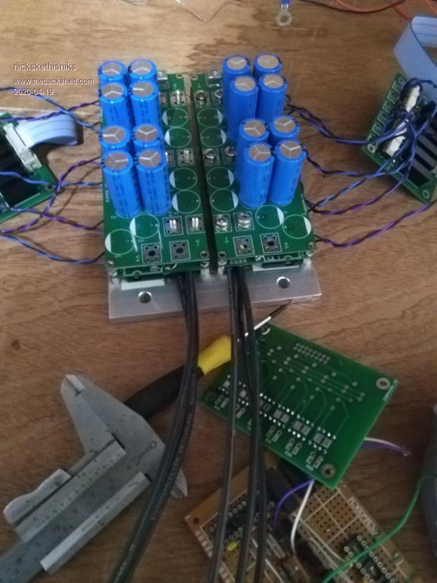

Dual powerstage:

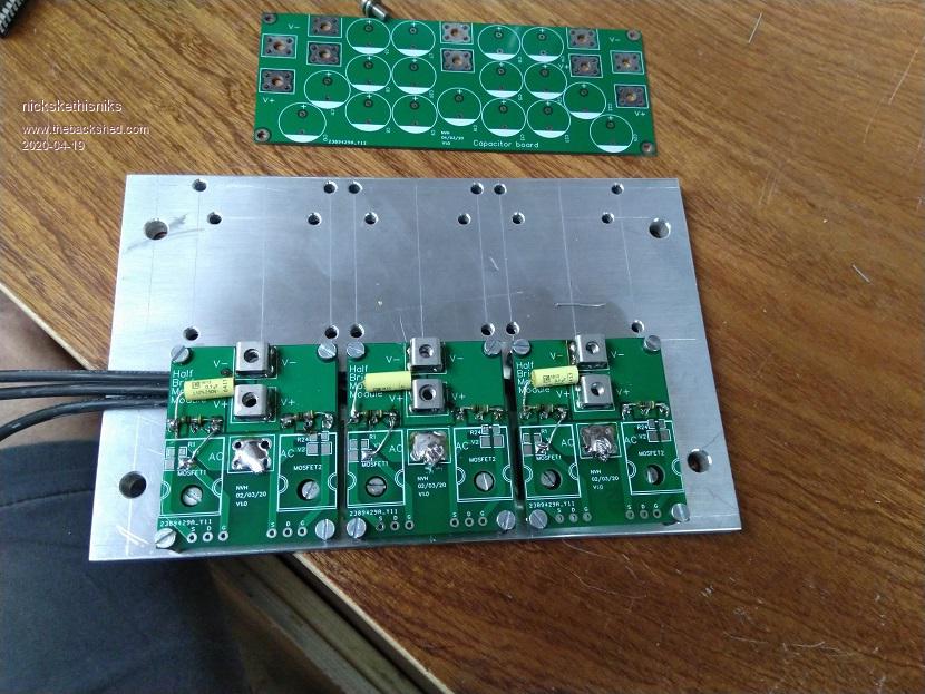

Mosfetboards:

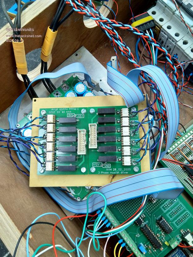

Mosfetdrives:

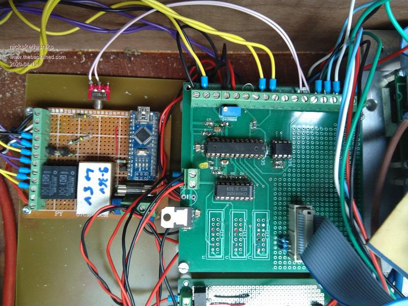

Brainbord:

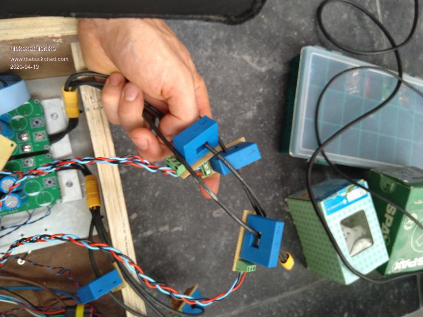

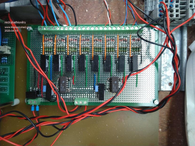

Board for conditioning the hall sensor signals:
Hall sensors:
