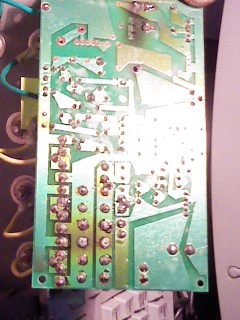

Hi, my cheap Peoples Republic wind gen has had a few hic ups lately, apart from throwing ONE of the plastic blade ends off in a bit of a blow we had, and before we could get it down, it threw another, and when I finally got it down, the third one was missing. needless to say that shimming the rear bearing carrier with the side of a coffee tin was not unexpected..
Then, a couple of months later after takeing 4 mt off the tower height,(so it made it easer to get down and up with only my partner and I),I finally got it running sweet, but the abuse that it had endured while trying to get it balanced, manifested its self at 3 30 am ( in a bit of a blow ) by deciding to shed all three blades, and if you are only 15 mt from it when it happens, it is one scary sound to wake up to, one blade buried its self within 1/2 mt from the house, and the other two were picked up some 40 mt from the wind gen, in diferent directions. so after cutting the blades, redrilling them and getting it balanced again it was back up and working fine,
bit more wind speed needed to get it going, but we have plenty of that here back to its 30 volt at 6 to 10 amps, and the 24 volt battery god was happy once more.

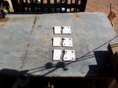

Then, (in a bit of a blow) I was not quick enough to get it pulled out of the wind, and the regulator box decided to have a BBQ on its own, I wasnt invited till the chips were well dome fuses blown and relays fried
NOW, come on Ozie wake up, sorry I have been so long winded, this is my question...
1) would the bridge rectifiers be any good to remove and use to convert the 3 phase to dc 24 volt( it is or was a 24 volt unit, 500 W wind gen)
2) I have a 60 amp solar charge controller, could I feed the output from the bridge rectifiers straight into the charge controller, or do I need some other electronic wizardry between them?

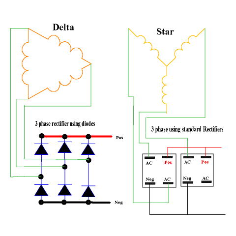

Yes you can use the bridges as rectifiers or spend a few dollars on some 35A 350v bridges. They are a little more solid than the dinky ones in your current controller. Use heat sinks (modest for your requirements, but still necessary.
Either way connect up as they currently are, or like this (from windstuffnow.com)
That takes care of getting it charging. Now we need a diversion controller like this oatley controller and then a dump load for it to drive ... say 8 x 50w car headlights connected in series/parallel for 24v.

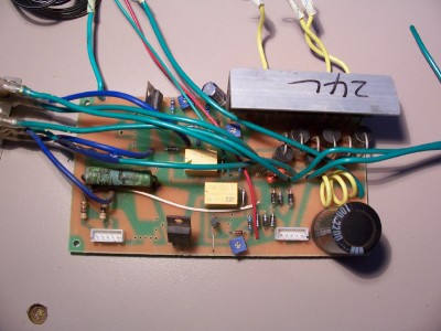

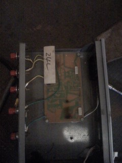

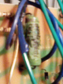

Your photo's of the innards were blurry, but you seemed to have shown a cooked resistor (probably the load sense resistor) and some blurry diodes, and a cooked relay.
Could you get a pic of the whole board and innards, maybe Gordon will recognise the topology and we can move forward from there.

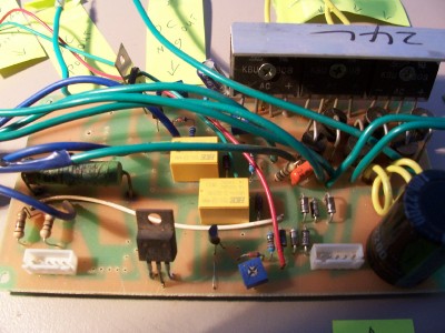

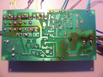

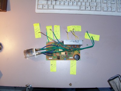

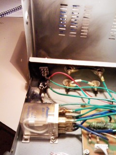

Hi Oztules and Gordon, here is a few clearer (I hope ) photos. I had a look at the Oatley ones and I think I could put one of them together... at a pinch..
the mill had " FD500" on the side of it

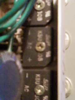

the square yellow things are "hrs1h-s-dc24v 1a 120vac 1a 24vdc"
the big cap is "100v 2200uf(m)"
the six round things are"6A10 hch"
the small blue cap at the back is"35v 220 uf"
the three rectifirers are"kbu808"
the three transistors are" 2n 5551 b998" the front one has had it's face blown off
the orange resistor is" 1uf j 63mkt"
the front 3 leled thing is " .013 AN7824"
the other 3 leged thing at the rear left is" nec 2p4m p92"
I can't read anything on the large green resistor

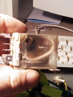

the relay is " asiaon jqx-12f 30A-AC power relay" and has dc24v on the coil inside
if you need to know colors of resistors etc let me know.

Posted: 11:53am 10 Aug 2008
The board if fixable. So far it looks to be a voltage regulator, perhaps some diodes (6a10's have been hot) a 160v npn tranny and damaged/dead load resistor that provides the power to the voltage regulator.
There are no exotic parts on this thing.
I would have a better idea how it worked if I could read those carefully done tags that show where the wires come and go to, but never mind.
I would probably go for 2 or 3 of the big 35A rectifiers rather than the oatley 3 ph rectifier. Bit expensive for my taste. Like I say, you are only rectifying small currents (comparatively).
If the bridges in the unit are ok, you can use them as is. Just get rid of the 6A10's, and you can hook up to the dc there to the batteries. (perhaps cut the track to the yellow 24v relay to isolate the whole lot... but new 35A 350-400v ones would still be better.
For the dump converter, read this and see if you can do it. Ghurd sells them assembled I think, there may be others over here, The oatley one seems a little expensive and incorporates a backemf controller similar to the chinese one.... which got us into this mess in the first place.
If you have a third party dump load car lights etc) it is very difficult to come undone. It means the fet (from the diverter) will be switching resistance only, which beats the hell out of trying to handle high inductive loads of an overworked windmill..... which I assume didn't help that relay any. (If I could read your tags, I would know what this relay actually did.. is it kill function, or part of the backemf dump system..).
I wouldn't get another chinese one, as from what I can read on the net so far, failure is the norm rather than the abnormal.... but the mills seem ok (maybe iffy bearings) although you only hear about the ones that fail I guess.

Just for intrest sake, from the top left going clockwise the tags read...Auto/manual switch...dc out pos...dc out neg...wind gen in...fuse...fan and Amp meter...red and green leds and volt meter...

I did what you said, and took out the yellow relay, and while the iron was hot, took the rest of the stuff off too,What should I have left in?
As is, it put out 30v and with a little more wind, went to 53v, no load. I will do some more testing tomorrow,

Thanks for all the help oztules, where would I solder the dinkey little amp and volt meters onto the board so I can get some idea what is going on?
Grolly
I have bought the farm...now I AM powering it...
Posted: 10:18pm 12 Aug 2008
Grolly,
Trying to look at your board, I have a suspicion that the amp meter has a shunt across it in the form of that yellow loop of wire. So, the dc pos going to the battery needs to be cut, and the meter put in series with this line with the yellow shunt directly "shorting" across the meter. The meter will read the tiny voltage drop across the yellow shunt (coil).
At least that is how it appears. The volt meter just goes in parallel with the battery lines ie across the b+ b- .
Will draw a diagram if this is not clear. An off the shelf amp meter would likely not need the shunt.
Do not put your amp meter in series without the shunt as it will cook it in seconds... if it works as I suspect.
Looking at the pics again, the skinny wires support this theory.
...........oztules
