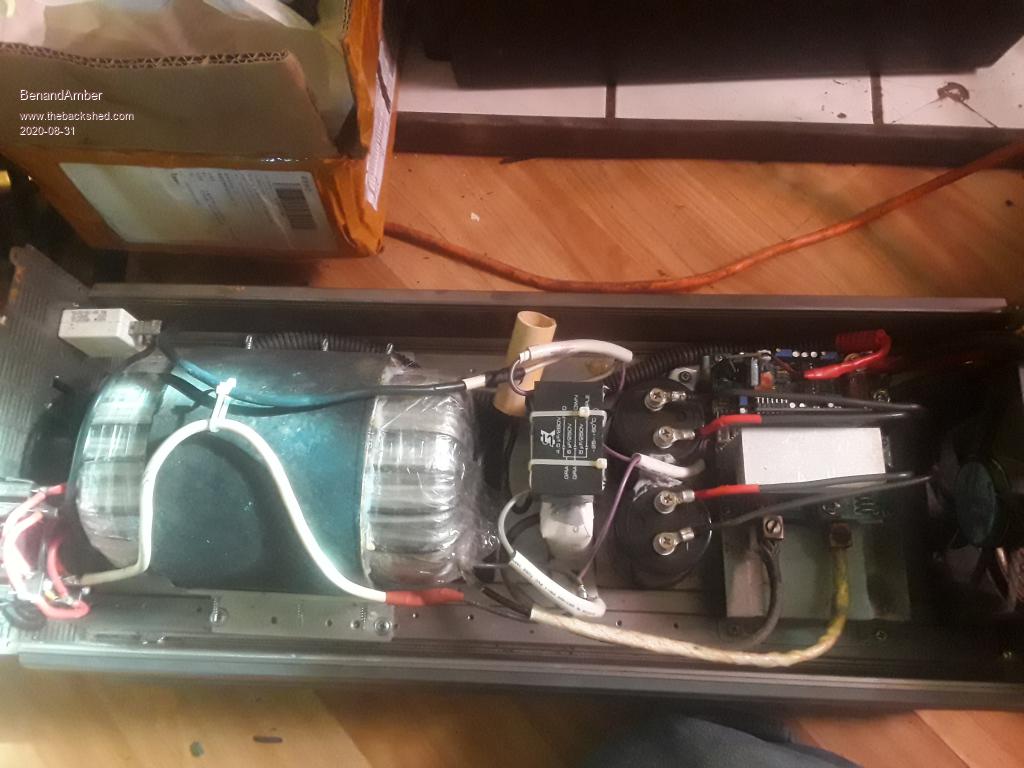

BenandAmber
Joined: 16/02/2019
Posts: 961
Posted: 09:27pm 30 Aug 2020
Thanks for the info  Revlac and Nicks!!
All the batteries are the same color and same writing on them
The dell laptops rate the life of the battery in them
All these batteries tested good or excellent before taking them out

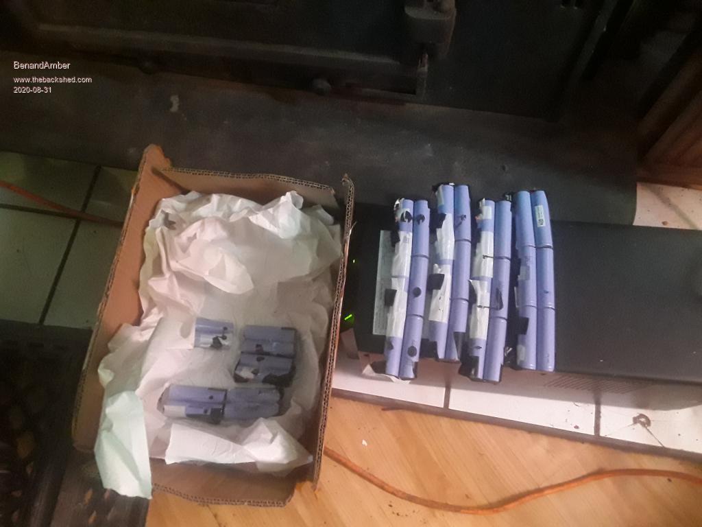

Thay are still paired up three in a row
Me being scared of these batteries is a under statement
I store them in that box with paper in between and taped in that wood stove

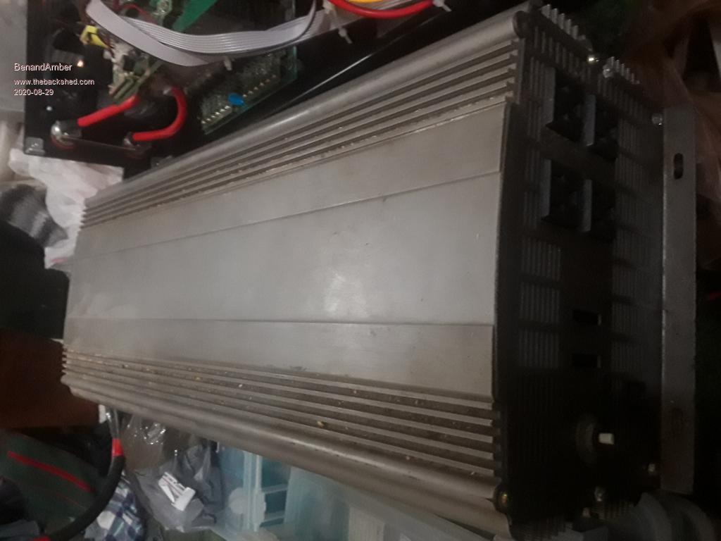

Had to clean the dust and wood chips out off the first inverter
Its idle current is 0.29 on the 48 volt battery side
I am really happy with it
I still think their may be a advantage
to a taller and skinny toroid Transformer
One day I will test this theory
Edited 2020-08-31 09:06 by BenandAmber

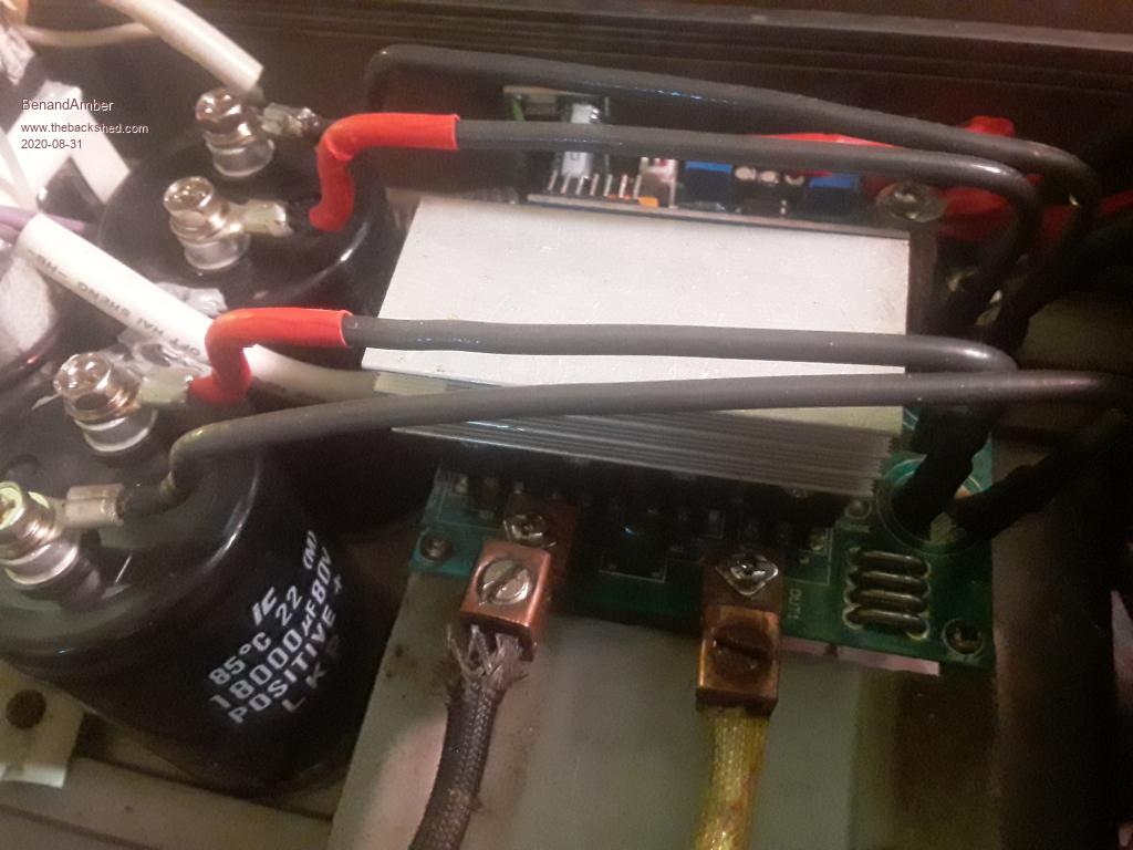

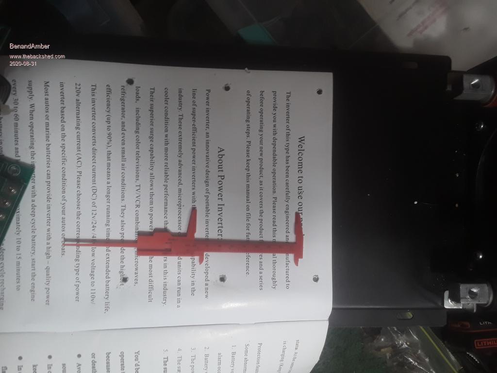

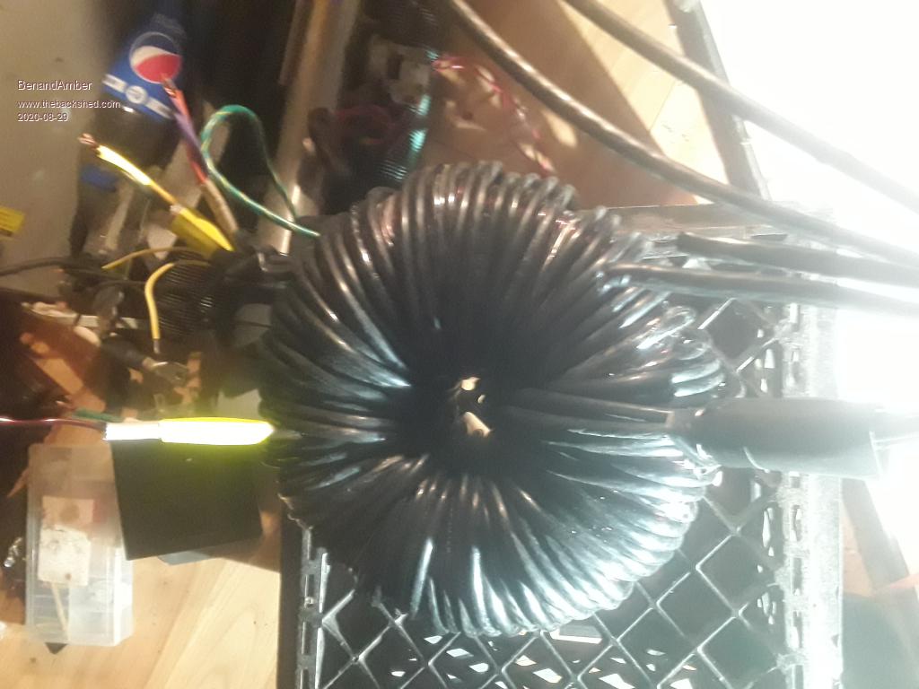

BenandAmber
Joined: 16/02/2019
Posts: 961
Posted: 07:39am 31 Aug 2020

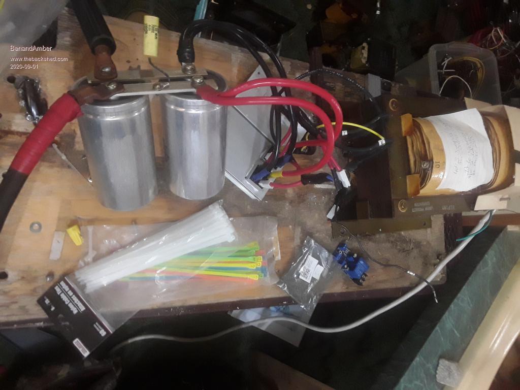

I bet I am the first person to find a use for a power Jack manual
My experimental Transformer primary wires
I put the current toroid there so when I solder leads on the secondary I won't forget to slide it on
I am going to have to put hood scoops on both sides the tranny is a little to be
Edited 2020-08-31 17:44 by BenandAmber

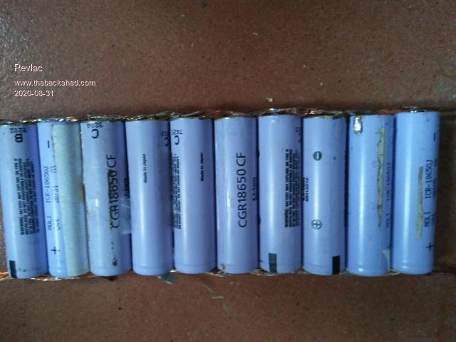

Joined: 31/12/2016
Posts: 1309
Posted: 12:07pm 31 Aug 2020
This is a set of 10, there would be 13 sets like this, I did them this way so I could stack them up depending on how many are available.
They should have wire strip spot welded joining them together, I soldered copper wire on to all of them and that apparently is a bad thing to do, I'm a dumb arse and Didn't know at the time, after doing this on over 2000 cells its never being any problem.
About a BMS, I have a bit of a dislike for the ones that cant be user configured to suit the type of batteries to be used.
I think you will need to find a suitably one because that will be a small bank to start with and I guess battery voltage will change rather quickly and get out of hand, were as a large bank like the one I have It could go for a week or 3 before things start to get out of hand.
Over the time I have run my setup I have only had 2 cells fail, over time I could see one pack of 100p the voltage was getting lower over 2-3 weeks until I give that lot a boost to bring them back up.
The first one was removed as soon as it was found due to a slightly higher temperature than the rest, the second one I left it in the pack for at least 3 months and no change, decided its time to remove it, removed the set of 10 to find 5 of them just slightly worm, separated them let them sit and the good ones cool and the bad cell was getting hotter and voltage dropping off, so the rest of the cells help keep the temp from running away on that cell, that's probably why all the battery packs I'v seen, the cells are packet tight together and work like a heatsink.
Now, for me this reveals a problem with using a not so smart BMS I believe it would hide the voltage drop on that pack and no one would know there is a problem there.
For large single cell battery bank 16s 1P this would not be a problem.
Now if there Is a BMS that can be user configured for the cell voltage required and if it could read the amount of power going in and out of the cells and do a comparison, this would be great, then the user can see there is a problem and perhaps fix it.
Also it is worth building a fireproof box to put them batteries in and they can go crazy without damage to anything els.
I have been really brutal with a few of these batteries from notebooks and never had any fire out of them yet, cant say the same for nickel iron or a few others, had a serious meltdown with them just on a light trickle charge.
That's all for now.

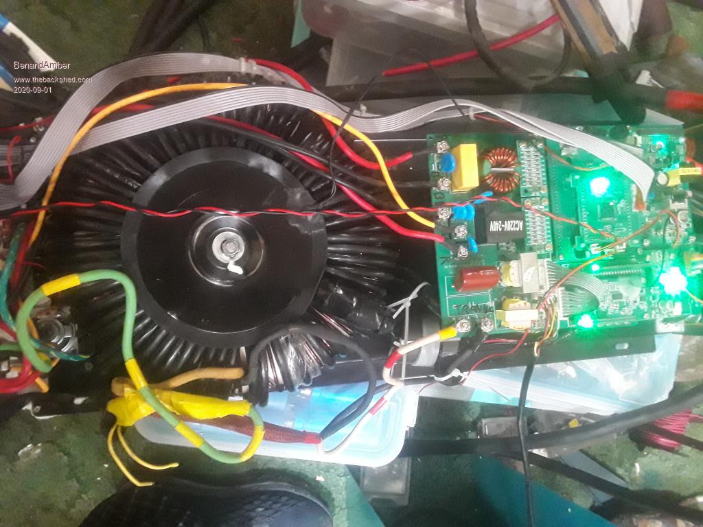

BenandAmber
Joined: 16/02/2019
Posts: 961
Posted: 06:21pm 31 Aug 2020

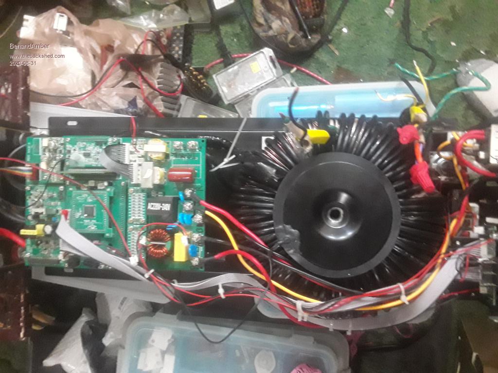

This is that power supply I made no box yet
It can be wired for 120 or 240 volts it can put out 40 or 50 amps on 240
I have a little adjustable turn off board
for it also to use it as battery charger
It breaks one side of circuit on the high side
Here it is powering the experimental tranny in the power Jack
I have to build a good choke idle current is over two and a half amps
Edited 2020-09-01 13:25 by BenandAmber
