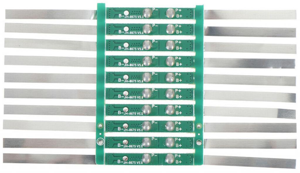

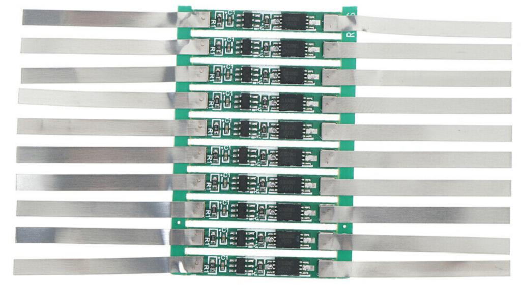

These are the protection strips I have
As you can see there are 2 nickel straps that go to the batteries one neg pole the other pos pole, one strip per battery,
I intend to fit one to each battery then link all the P- pads together and the B+ pads and use this as my bank so higher capacity but still nom. 3.7v.
Do you think this is the correct method?

Ok so everything is parallel, it may be ok, provided the components on all of the strips are identical or they might sort of, fight each other.
I have never used balances before on any of the (2000 or so) 18650 cells I have in use.
They will help increase the capacity of the 20000mah pack, make sure the voltage is the same when connecting them together.

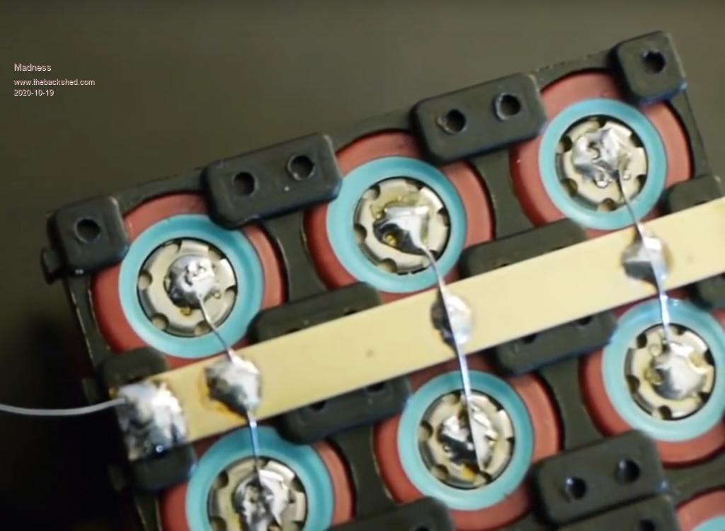

The way Tesla and many others are doing it is to fuse each cell, if one goes bad you don't have a fire risk.
