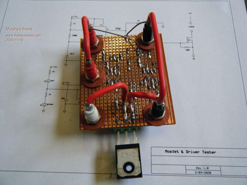

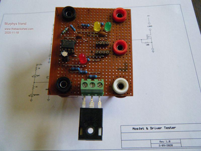

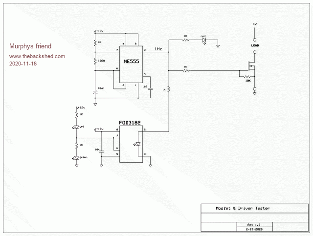

Here's a handy little tester to check if that Mosfet or driver is still working. It's just a basic Go/No Go test not a switching speed etc. test.
The neat thing is while the LED shows what's going on when the Mosfet Drain is linked to the 12 or 15v supply, the Mosfet can also have a different, more powerful drain voltage supply to test it for switching some serious current. I use a 12V halogen spotlight for this.
The driver tester IC socket can accept FOD3182 or HCPL-3120 drivers, the latter requires 15V at the Vcc input.
The LED's turn on alternating if the driver works OK.
The driver socket can simply be not fitted if that function is not required.
My thanks go to warpspeed for suggesting making such a tester.
Its a simple Veroboard job but the Mosfet tracks need to be beefed up if high current testing is required,
