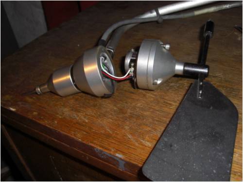

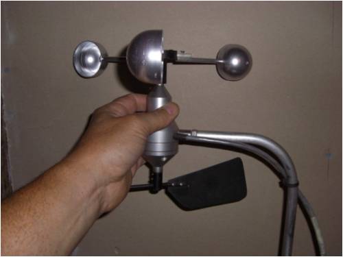

Hi guys ! Am trying to get data from a rebuilt professonal anemometer I found in a skip. It only had one cup when I found it so I have replaced all three with measure cups from "Vanish" wash powder and some alu tube(see attached pics)
My electronics experience is limited - but I have a multimeter whch will measure Hz and also output via a RS232 to a pc. I was intending to record this data on an old toshiba laptop. BUT ! when spinning the spindle by hand I can record some mv changes but no HZ data. I think reading the meter specs the problem is it will not record less than 10 hz/sec and needs >200mv and I get a lot less than that.
At present I am not interested in the wind direction but have indentified which pair of the six wires does what.
I have a digital bicycle computer I could use but I was intending to use that to record rpm on the mill. Any suggestions ?Edited by Bernie the Bolt 2008-09-28

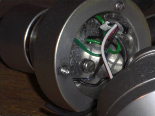

Hi Gill,
Here are pics, the green wire and the black wire going through the hole come from the windspeed sensor. The other wires are from the direction sensor which I am not concerned with.
I am guessing there is a small magnet and a coil inducing a small pulsed output ?

Bernie,
Pictures of two wires is no better than saying there is two wires, still without a pic of the device, that is a start. It tends to eliminate some photo electric and hall effect devices. Your idea of magnet and coil is less likely though still possible.
What do you get if you put an ohm meter to those wires and turn the cups? This might indicate a reed switch if it pulses on and off.
Is there any indication of cogging?
If your idea is right I think an amplifier like Glenn uses in the piclog project will be needed.
Cheers Gill _Cairns, FNQ
