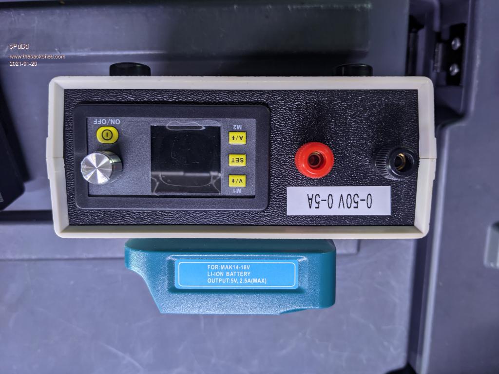

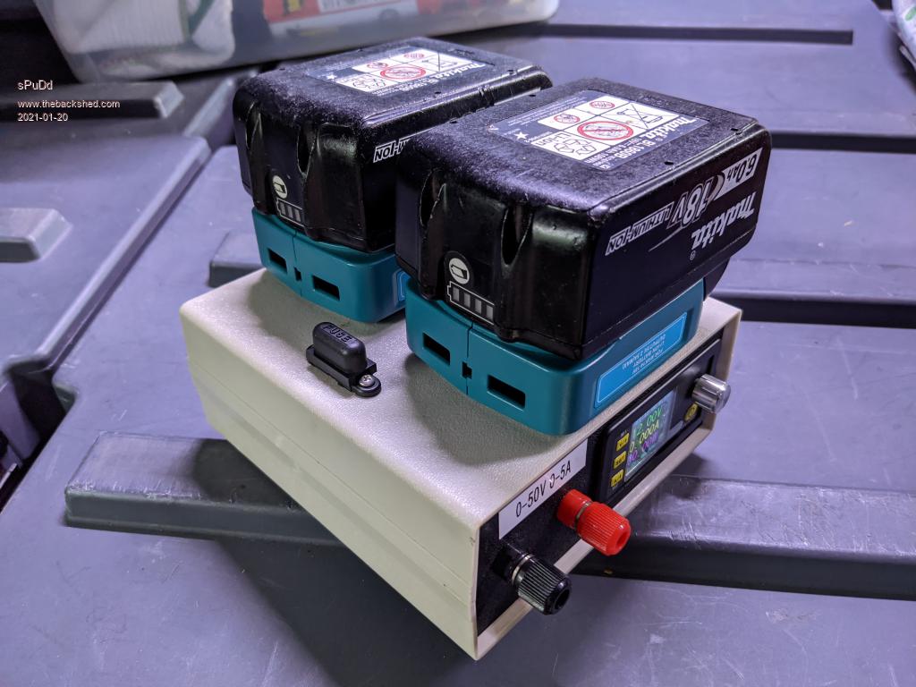

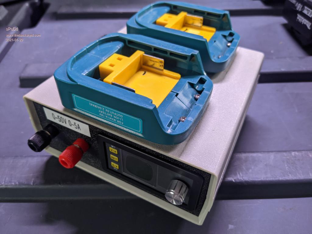

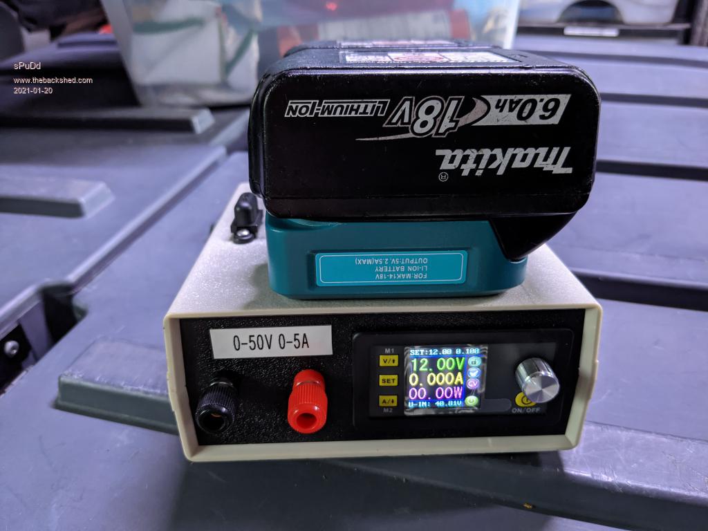

Gizmo,
  it makes sense that it would use a boost DC driver for the LEDs. Can you try driving the LEDs with your bench supply? Maybe a few batteries in series with a resistor if field testing is difficult.
I made a field battery powered test supply using a DPH5005 50V 5A buck/boost PSU from the usual suspects driven by two Makita 18V battery packs in series. It's proven to be very useful at work and home.
Project case, Makita knock-off USB adaptors, inline fuse, all good.
It should work ...in theory

sPuDd
Joined: 10/07/2007
Posts: 251
Posted: 11:28am 21 Jan 2021
BenandAmber,
   I've never seen a 120V capable flea-bay buck converter in anything less than a few hundred watts sized. I'd suggest just using the little AC mains rated ones as they run fine on AC or DC. Example:
AC/DC Buck Converter 12V out.
Cheers on the little field PSU. Only took about an hour to fit it into the case & wire up. I'm on the Makita platform so I used them, but the same thing would work with any brand, or even some other kind of portable battery.

BenandAmber
Joined: 16/02/2019
Posts: 961
Posted: 09:09pm 22 Jan 2021
Wow thanks for link
i have about 10 not like the link but out of wall worts
they do not work for me
i still have them some where
i will upload a pic one day but in the mean time will order a few of these
thanks
i like your build really nice and not sloppy
i love seeing others nice builds
