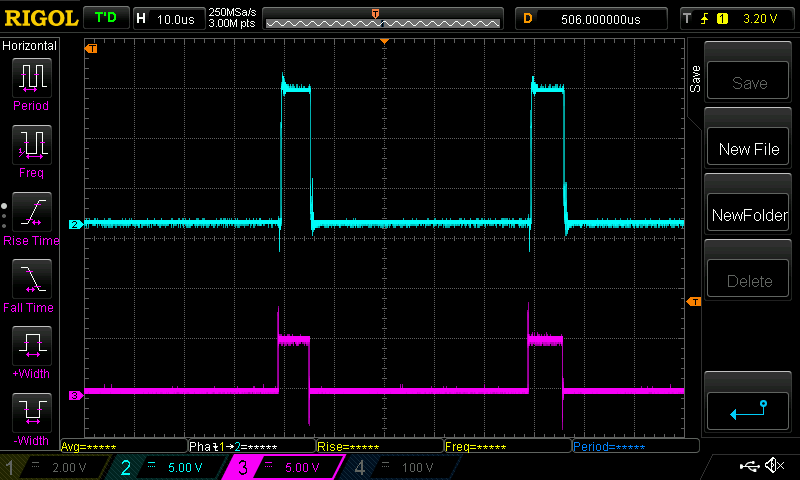

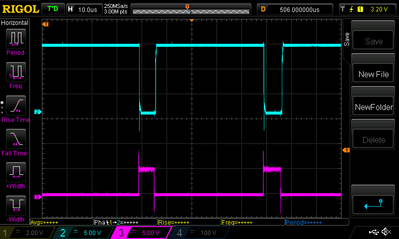

How to check for correct IR21844 operation:
All measurements are with respect to DC ground on the nanoverter.
Disconnect the 10 pin ribbon cable. No need to blow more FETS.
Power nanoverter board so that 15V is on the DC-DC converter output.
I use a bench supply and connect to dc-dc outputs.
No need for 50V battery etc.
have nanoverter on "off" state.
Pin 1 is PWM in. put DSO probe on that. You should see 5V very short pulses, at 20 kHz.
While DSO probe on pin 1, start nanoverter. The run LED should light up.
You will also see the increasing PWM width as the soft start is run.
After a few seconds, the PWM width will be nearly 99% and stable.
Verify this for both IR21844 pin 1 inputs.
In turn, check the gate drive outputs for both ICs.
with nanoverter "off", check no output on pin6, low side output.
This must be zero when inverter is off.
Then start inverter, you must now see an output, inverted compared to pin 1.
This output needs to be 15V, the same as the IR21844 supply voltage.
This proves 2 things.
- the shutdown pin works as intended
- the low side output drive works
Do this for both chips.
Next, ensure the powerboard DC cupply caps are discharged.
Then connect the ribbon cable.
Now we check the highside output.
(we need the power board to be connected to give a "ground" for the charge pump
to function.)
Again, with inverter off, check for zero output on pin 12 (high side output)
start inverter, and now note PWM output on pin 12.
Again it needs to be 15V. This time it is a mirror of pin 1.
Not inverted.
This proves a few things:
- high side output works
- charge pump works
- again, that shutdown pin works
During these tests, look for poorly shaped squarewaves.
I have seen poor shapes such as a 1/2 high start and a curve up to full voltage
as the "squarewave" when testing damaged gate drive ICs.
You will need a nice, fast squarewave.
It will be likely
you will have huge over and undershoot on these signals. This is normal
and due to poor DSO probe technique.
I have blown up gate drive ICs about 4 times when playing with the test nanoverter
and each time I do the above before I even think about damage to the power board.
Once you have proven the nanoverter is working properly, then look at dead FETS, dead totem pole transistors, dead charge pump diodes on the power board etc.
Purple is PWM IN, pin 1
Light Blue is low side output, pin 6
and now Light Blue is high side output, pin 12
The 5V pulse is converted to about 15V on both outputs.
