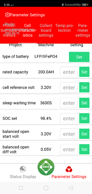

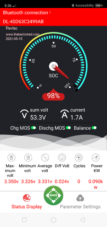

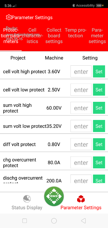

Posted: 10:17am 15 May 2021
The voltage can be set on the second and third page on the phone Bluetooth  APP (program), however they are set at the factory and they don't recommend changing it, unless the particular battery/manufacture recommends different settings.
Nothing stopping anyone from changing it though. Password is used to change settings.
Found it best to set the SCC to work with those settings.
At 16s the batteries do most of there work at 53v and lower depending on quality and who made them, I guess the FLA batteries will kick in a little lower than that, then should work together under load.
The BMS, I have managed to trip the cell over voltage protection a few times while setting the SCC, the BMS just stopped the incoming charge to the battery until the problem is fixed or some voltage is taken from the batteries, at this time the SCC was supplying  the rest of the system, the inverter with power and everything kept running, as it should, the BMS will still show voltage and allow power out, I have heard some other BMS units will completely shut down in this condition.
If you want to change from a 24v system and a 48v system and back, you would need to buy a BMS for each.
