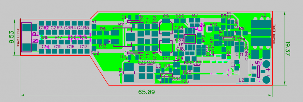

or make one.
this will perform well
Check out the testing he did with it.
Then a more experienced E.E. had a go and improved it
and it works really well

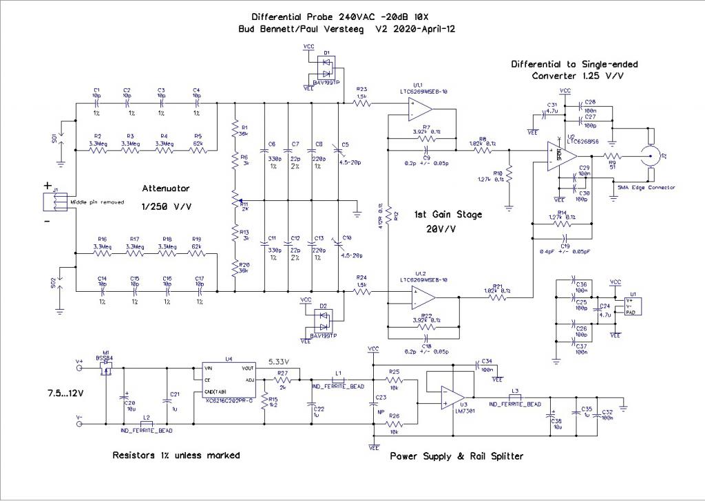

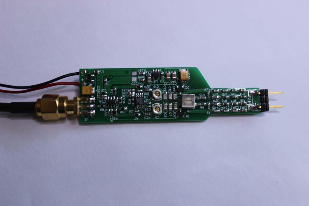

It looks like this:
All SMD of course.
here are the files for the project including the BOM.

  poida said  or make one.
Looking at the schematic of this probe it does not seem to have galvanic isolation.
Can this DIY probe be safely used with the grounded oscilloscope to measure signals on the  the inverter (both primary and AC side)?
I can source components for two probes for less than $120-140, just not sure of safety of it.

  Quote  Looking at the schematic of this probe it does not seem to have galvanic isolation.
It doesn't but that is not always necessary. As long as the two attenuator divider chains have an adequate voltage rating, as this does, it should be safe.
Provided the attenuator end is  enclosed in plastic to avoid accidental contact I would use one.

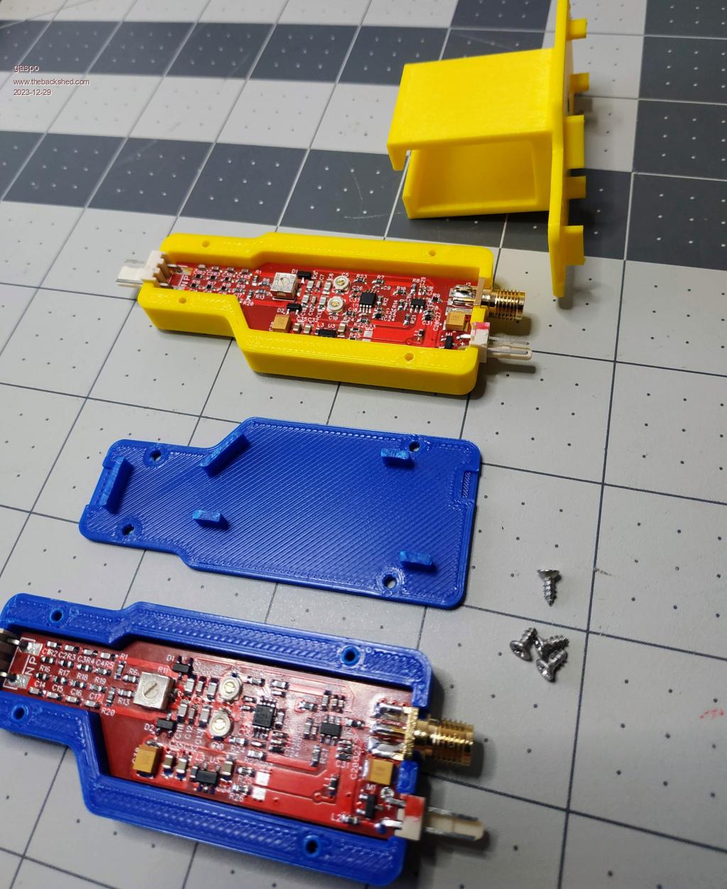

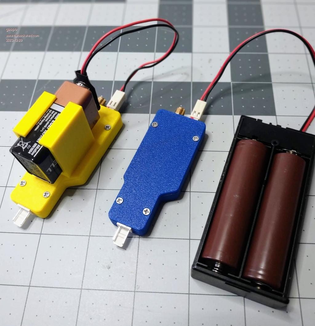

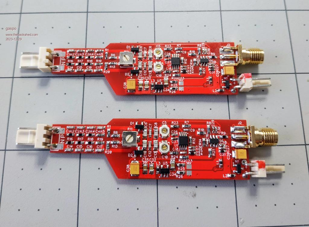

I've finally built the two probes shown in the previous post, and they appear to be working. However, I'm a bit confused about their measuring capabilities.
According to the specifications:
- Common Mode Range > ±340V (240VAC produces a sine wave with a peak-peak value of 679V).
- Differential Voltage Range > ±25V for 240VAC common-mode, ±25V for 0V common-mode.
I have a question about the "Common Mode Range > ±340V." Although the probe has a 1/250  attenuation for working with mains, the signal between the inputs should still be within ±25V; otherwise, it may get clipped.
My main question is how and where to connect the probe inputs to achieve a 240VAC common-mode and then measure it accurately. Additionally, I wonder if I still need to use a voltage divider in front of the probe to ensure the signal remains within the ±25V range.

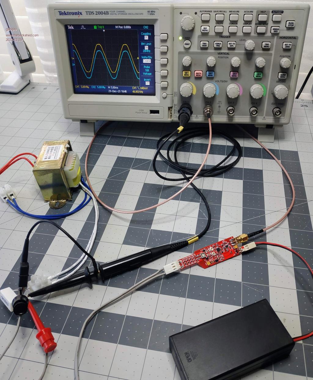

  Quote   I wonder if I still need to use a voltage divider in front of the probe to ensure the signal remains within the ±25V range.
That is my understanding of how it works.
To check connect the inputs to a 30V transformer, if it clips you have the answer.
  Quote  My main question is how and where to connect the probe inputs to achieve a 240VAC common-mode and then measure it accurately.
If it does clip in the above test a 10:1 attenuator will be needed to measure a differential of 240V. 1M ohm across the probe tips with 4.5M from each tip to the 240V. For a 50Hz fundamental that may be enough but to accurately read harmonics and spikes small adjustable compensation capacitors will be needed across the 4.5M resistors.
Use a square wave to adjust them to remove any rounding or peaking of the edges.
Edit
Or use a standard probe on the output of a 24V transformer. 20VA or larger for best accuracy. Waveform distortion can become significant under 5VA, though a resistor in series with the primary reduces it at the expense of phase accuracy.

  phil99 said  If it does clip in the above test a 10:1 attenuator will be needed to measure a differential of 240V.
Yes, it does clip the signal when the measured Vpp > 50V. If I still need to use the external attenuator what is then purpose of probe's built-in 250:1 attenuator.
Is there a special way of connecting the probe or setting up the circuit in "Common Mode" to be able measure up to ±340V peak?

  Quote   what is then purpose of probe's built-in 250:1 attenuator.
Without it the op-amps would have 340V on the pins. They don't like that.
The probe allows you to measure small differences in voltage on a live circuit.
Eg. Many domestic pump controllers use 5V and 24VDC supplies derived from 240V via a series capacitor and bridge rectifier. The DC "ground" is live so this probe would be ideal there.
If the voltage difference between your mains neutral and earth is small you could use a regular probe with the earth clip removed. The scope ground will be via its mains earth. Not perfect but often good enough.

  phil99 said  1M ohm across the probe tips with 4.5M from each tip to the 240V.
Thanks Phil, I'll use the voltage divider you suggested.
Posts: 3412
Posted: 03:31am 30 Dec 2023

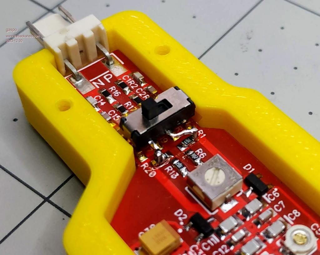

I forgot to say 1he 1M is the total resistance across the probe tips. The probe's attenuator looks to be about 20M so the added resistor will be about 1.05M
Edit
A simpler option may be to add a 8.8k resistor across the op-amp end of the existing attenuator, multiplying it by ten.
Top of R1 to bottom of R20.
Put a switch in series with it for two ranges.
Edited 2023-12-30 13:46 by phil99

  phil99 said  A simpler option may be to add a 8.8k resistor across the op-amp end of the existing attenuator, multiplying it by ten.
That is a good idea; it can be integrated into the enclosure. Just need to apply some 5-minute epoxy to keep the switch in place and prevent it from leaning on the tiny SMD resistors. I used 2K on one end and 6K8 on the other.
Posts: 3412
Posted: 05:58am 30 Dec 2023
Looks very neat.
I hope you checked the accuracy before gluing it, in case the resistor value needs tweaking to allow for tolerances.
If it is already stuck measure any error to calculate a correction factor to apply to readings.

I'll glue just the switch and leave resistors accessible for adjustment if needed.
With the current value of 8.8K the scope measures about 1% more than what the DMM is showing (187Vrms vs 185)
