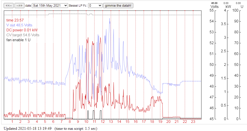

Last Saturday is typical. The Red line is inverter DC input power.
The light Blue line is battery voltage. Upper Grey line is constant voltage charge target. Black line is fan command, non-zero means it is running.
So from the above it would be sensible to make an inverter that is running
at it's most efficient when producing about 500W.
It spends so little time at the high levels I can afford to have it at a lower efficiency during those peaks.
My estimation of efficiency is something like 93% at 500W and maybe 91% at 2.5kW
(there are times when the inverter power is zero. This is when the battery voltage drops to below low voltage cut-off and so the inverter is switched off)
So, what is your load profile?
All day at 3kW?
All day at 500W with short peaks of 3 and 5kW?
All day at 150W, just a fridge and some lighting, then you cook at night
using electricity. 1 hr at 4kW...

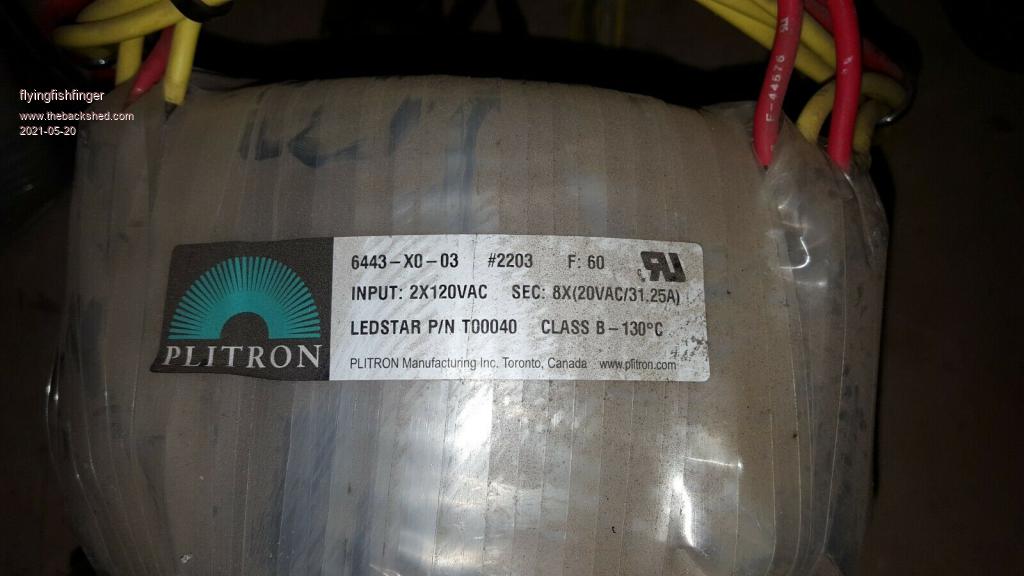

Oh, found something interesting: 5KVA transformer. It's local enough that I could make the drive to pick it up, so it really only would cost $60.
If we look at the last two pictures, they are of a beefy toroid. Could this work?
The ratings on the non-toroidal one are much better, though. I can't quite tell if I would get the toroid or the "square" one, but I have inquired...
R
Edited 2021-05-19 02:47 by flyingfishfinger

The toroidal in your link looks like a good start. It's all about the core dimensions and material quality. You won't really know what you have till you take it home and do some tests. If I was you, I'd buy 2 of the toroidals, take them home and run some tests. Unwind/rewind if necessary. Warpspeed is our resident transformer expert and may have more to add.

It almost seems like I could use the first one as-is, but I'm probably missing something relevant.
EDIT: Here's another, , 4.5 inch diameter, 2.5" tall. Too small?
R
Edited 2021-05-19 06:15 by flyingfishfinger

flyingfishfinger
Joined: 12/09/2020
Posts: 120
Posted: 04:43pm 19 May 2021
  wiseguy said
Its worth the $60 from a learning/fun perspective and if you go to pick it up you can have a closer look at all those toroids he has lying around whilst your there, maybe you will strike gold !
Apparently they're all the same.
  wiseguy said
I should also add and clarify that our inverters have mostly (all?) used toroids. In that respect you will be a bit of a pioneer.
Too bad, would have been nice to be a "pioneer" :) I think you mistook the first set of pictures. He's out of "rectangular" transformers, only has toroids left:
I was able to find a datasheet to go with it as well, attached. How much of this could I use as-is?
644303-1_toroid.pdf
