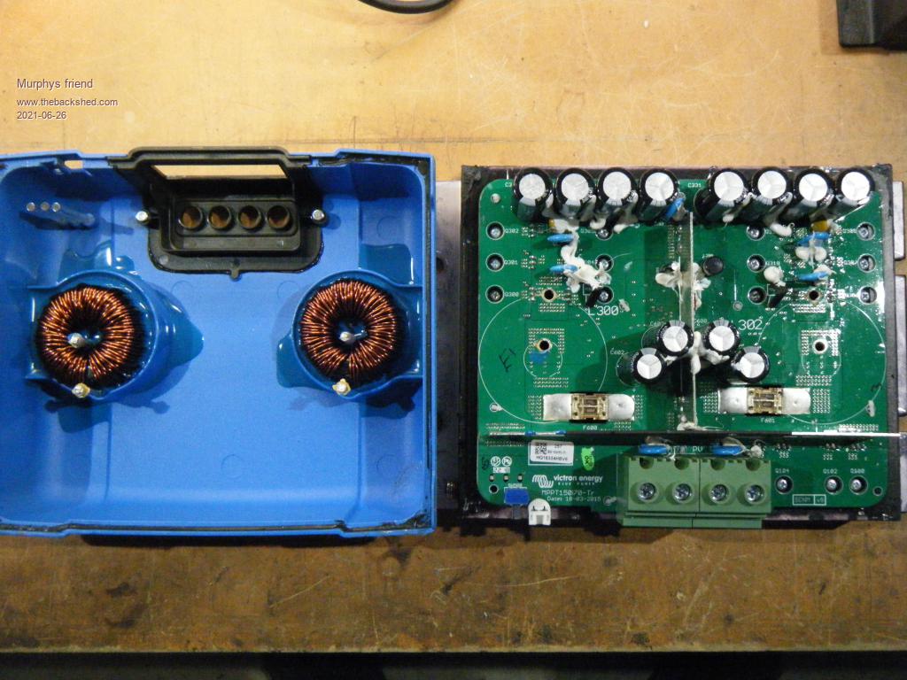

When I fitted extra solar panels on my caravan I knew the existing wire to the roof was too small, so an easy fix was to connect the 4 panels in series and use a MPPT controller with a higher solar input voltage.
The one in a blue box was recommended and I bought a 150V solar to 24V/60A version.
This worked very well until today when I checked the batteries (2 x 12v lithium in series), they were down to 12V - not good .
Disconnecting everything I found the MPPT was putting  out only 12V instead of ~27V.
Assuming some link inside had come adrift i tried to open it - bad mistake . These things are designed to self destroy if one tries to open the case.

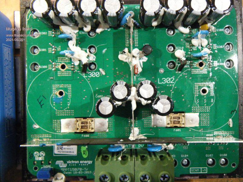

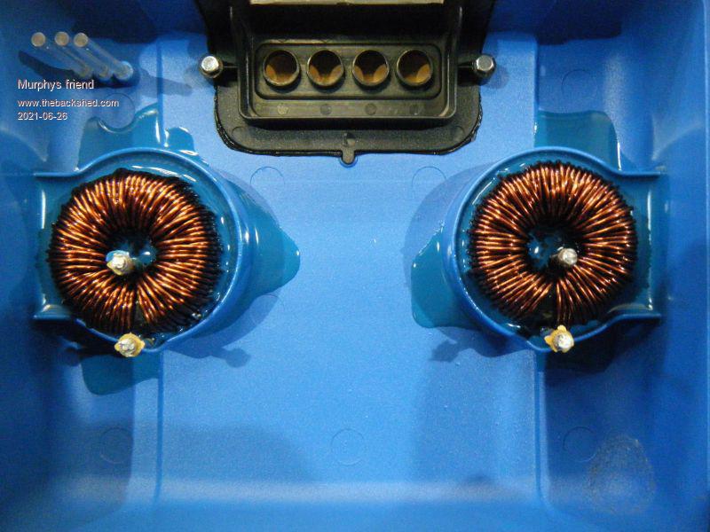

From the pictures one can see the choke wires in the lid have ripped out of the PCB.
The only way they could have assembled this unit was to pour liquid resin into the cups in the blue lid and screw the thing together. Once the resin has set it cannot come apart without destroying it.
I certainly would not recommend this brand to anybody. Having spent a working life repairing electrical/ electronic equipment and coming across something, which was rather expensive, made unrepairable really bugs me.
I believe Poida also had a bad experience with that brand.

That is crap but look on the bright side, it was obviously Cactus before you opened it.
Is the resin such that you could melt it with a heat gun and replace the chokes or is it the proper chemically hardened type?
Either they have a way of opening them or they just chuck and replace the things with no way to repair themselves.... which would indicate what their true value is worth and how cheaply they have them manufactured.

I don't know how many of those MPPT units shown above are likely to be around  ...  but it could be very handy for future reference if Murph could take some measurements.
First thing I'd do is drill through the coil holes and out the back of the case  ...  then others could know the exact location to drill from outside in the future.
How I would tackle one in future would be drill in through the case from behind the pcb  ...  at the four solder points for the inductors. Maybe a 8-10mm hole depending on the distance from case to pcb  ...
...  then unsolder the four legs  ...  and fight the lid off.
I can see some transistors or mosfets in close proximity behind there as well  ...  but once you know where things are and have taken good notes and measurements  ...  it's amazing how accurate you can get.

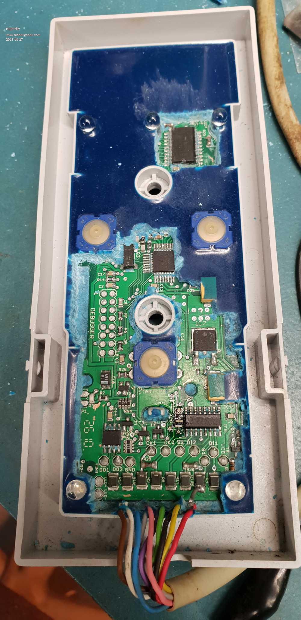

I first did some fully encapsulated boards about 40 years ago  ...  and after cutting a couple apart, discovered I could simply drill an 8mm hole, pick out the epoxy resin down to the board  ...  and resolder the dry joints on a particular electro.
I did heaps back then and saved a lot of people a lot of money.
There aren't that many different encapsulated boards that come in  ...  but there is one particular board that I have fixed hundreds of  ...  and they really don't take much longer than normal boards believe it or not.
The first one I saw kinda got sacrificed and over time I fully denuded it  ...  and any time I have a tricky fault on one  ...  I get that one out to guide me as to where to dig and concentrate my efforts.
Something I find amusing is that of the handful of techs I know around the world who fix this brand of equipment  ...  none of them will attempt this particular model. I keep egging them on and could get them a huge head start from where I started  ...  but somehow in their head, they believe they will be too hard to fix.
Only last week I had a board arrive that I'd never seen before. I haven't fixed it yet, but Ive made good progress. Of course, as a one off it wouldn't make sense  ...  but there are thousands of these boards around and sooner or later there's likely to be a steady stream if I can make them work.
The mess at the end of IC5 is the remains of a network resistor that I chipped  ...  so I temporarily stuck in some 0805 resistors on edge.
I very rarely find any chips that have had their numbers removed, don't remember the last time  ...  it's really only micros that are programmed that are a worry  ...  but in the vast majority of cases they are still ok  ...  except for the ones I have already mentioned.
Recently I had a couple of tractor column displays come in for repair  ...  I don't normally do that sort of gear, but they caught me at a weak moment. Apparently replacements are $5k  ...  and in both cases there were some 'beads' that were open cicuit and some were high resistance. Probably less than a dollars worth of parts to fix them both  ...  and they could have easily ended up in the trash.

  rogerdw said  I don't know how many of those MPPT units shown above are likely to be around  ...  but it could be very handy for future reference if Murph could take some measurements.
Good idea Roger but perhaps not easy with this MPPT. The inductors have 3 twisted wires (~1mm dia each) to connect to the PCB. The PCB is only 8mm above the heat sink so one would have to drill through the heat sink to get to the solder joints .
I could tell you exactly where the centers of the two torodial chokes are so one could drill a pilot hole through the blue cover and then use a hole saw that cuts bigger than the choke diameter to free them from the lid. Sounds messy .
When looking at the PCB underside, where all the SMD components are fitted, I saw nothing obviously busted. I assume it was a program failure that suddenly failed to recognise I had a 24V battery connected and decided to charge it with 12V instead - which is what I measured at the battery terminals. Solar input was 80V BTW.
This did no good to my expensive lithium battery but, fortunately, it charged up OK today with perhaps one of its nine lives lost.
