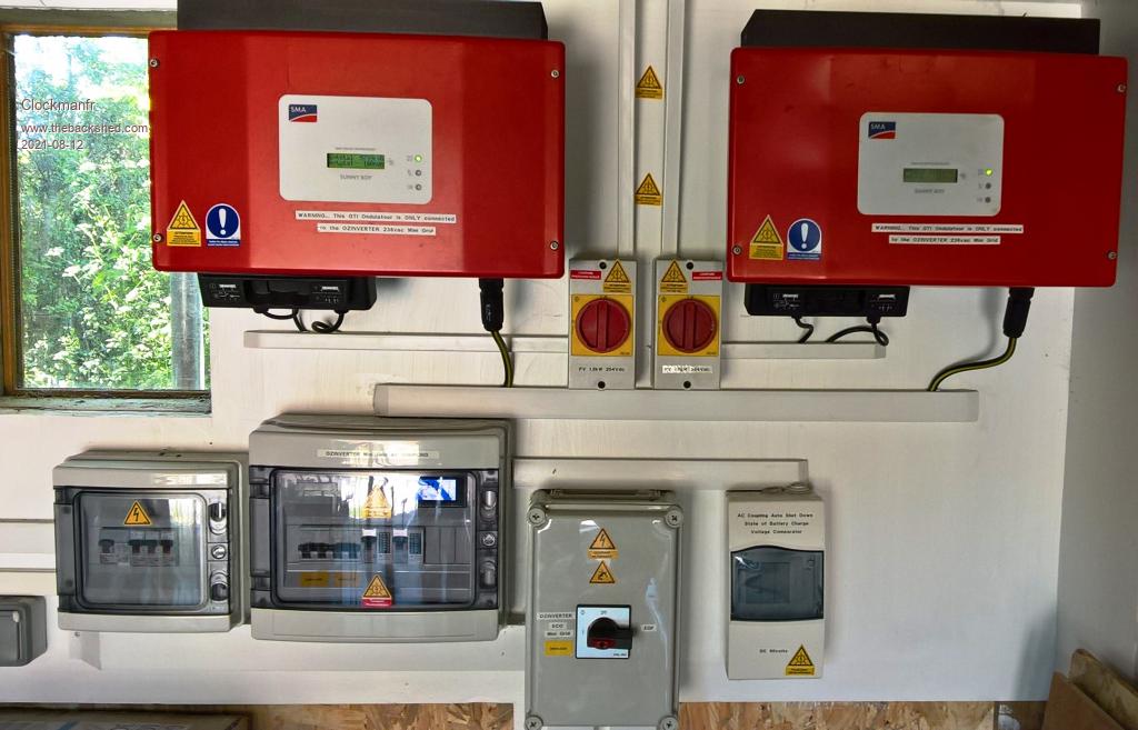

Here's a photo of 2off 1.8KW used SMA old toroid type recently installed on another of my buildings, these feed into the OzInverter created Mini Grid.
