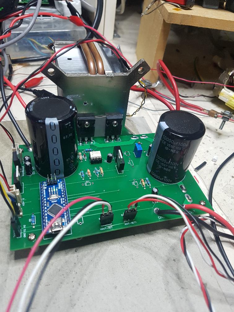

I have a need for a sort of dumb, slow is OK, close enough is good enough
power supply that can do 10 or 15 Amps at up to 100V
55V at 10-15 Amps for inverter testing
100V at 10 Amps for mppt testing
54.6V for ebike battery charging at 5A or 10A or even at 1C which
would be 20A
I based it on the mppt but only need 1 FET and one diode.
It incorporates the Hall type current sensor short circuit protection
I have just developed.
Runs on a Nano (of course) which lets me make it more than a charger or
simple PS. It can do constant power if I want (mppt testing...)
Only bits I needed to buy were the Allegro current sensors.

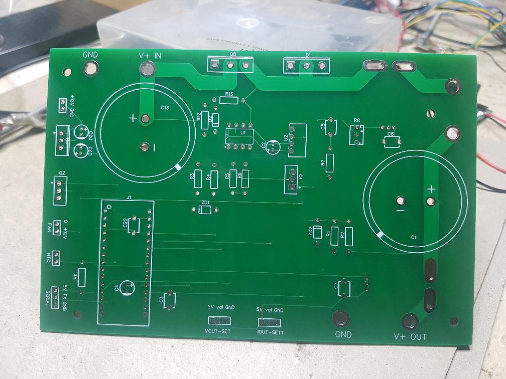

6 days from uploading to jclpcb to having the result in my hand.
It looks like this.

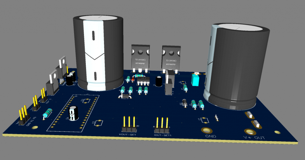

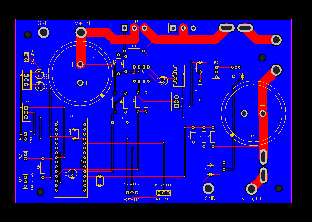

the actual pcb is:
the result will be:
the schemeo:

I just wanted to tell someone that I find it astonishing to have a
pcb for my power supply within 6 days.
No hassles. Just $38 for 5. This is cheap and good quality and fast.
This completely nukes any idea of home brew pcb production.

It works.
about 95% conversion efficiency (+/- a couple, likely minus)
30.3V 2.63A in
12.7V 6 A out
The heatsink still cold as after 20 minutes
All I need.
Of course the conversion efficiency will drop a lot when I feed it 100V
and draw 12V output.
I am thinking of switching the various secondary winding's into
the input as the set point voltage changes.
This to keep Vin a bit more than Vout and so conversion efficiency
very high.
