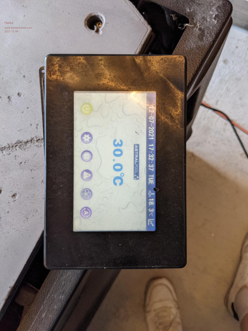

Hello again all,
Yesterday I picked up a "faulty" pool heater from Facebook Marketplace.
It's a heat pump system that cost over $7000 when it was installed only 4 years ago.
I didn't think I had much of a chance getting it going again, as I figured if the compressor was gone, then it would have been a write off.
Actually, driving home with it in the trailer I was wondering what on earth I was doing mucking around with it at all, paying for someone else's rubbish!

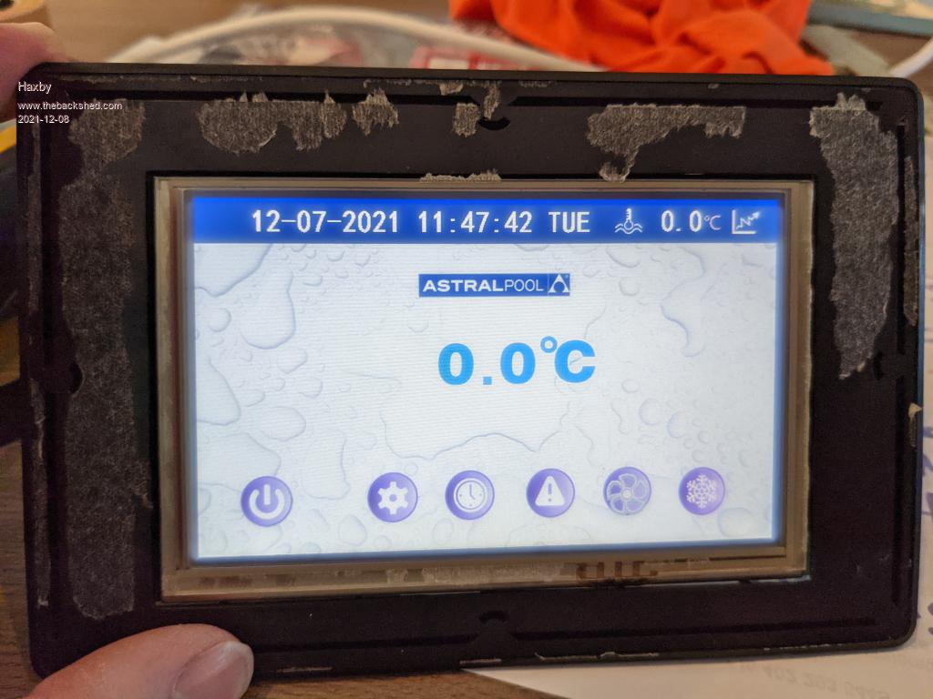

Well To my delight, after tinkering with it all day yesterday, I found that it was just the touch screen that was faulty.
Specifically the LCD display works, but it doesn't register finger presses. Maybe some water got into the plastic film and corroded it.
Fortunately only one row on the X axis of the touchscreen does still work, and also fortunately, the power button icon is on this row....
So I CAN turn on the heat pump but I can't use any of its many features.
I connected it to a temporary bin filled with water, and the system very quickly heated up the water from 20 to 35 degrees... Within 3 minutes!
The suppliers (astral) want $1300 for a whole new screen but I think I can do better.

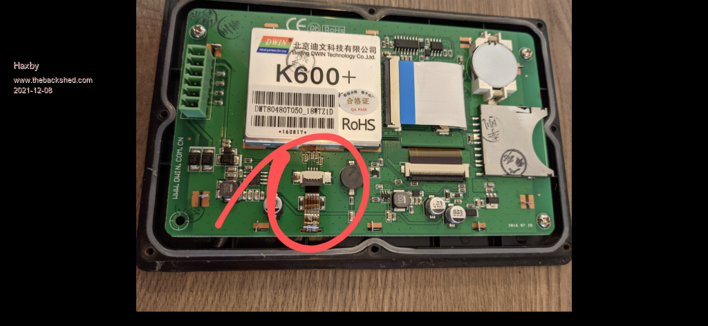

I'm not sure if it is capacitive or resistive. Is there a way to find out? It all looks ok. There is a 4 conductor cable that connects the touch screen film to the motherboard.
Could I connect any old 4 wire touch screen to it?
The touchscreen cable says T8888 with the next line being SF1632 but I can't find a replacement. It's 5 inches diagonally.
Even if the replacement doesn't physically fit, all I really need to do is change the setpoint temperature once in a blue moon, so a dodgy solution would be fine in this case.

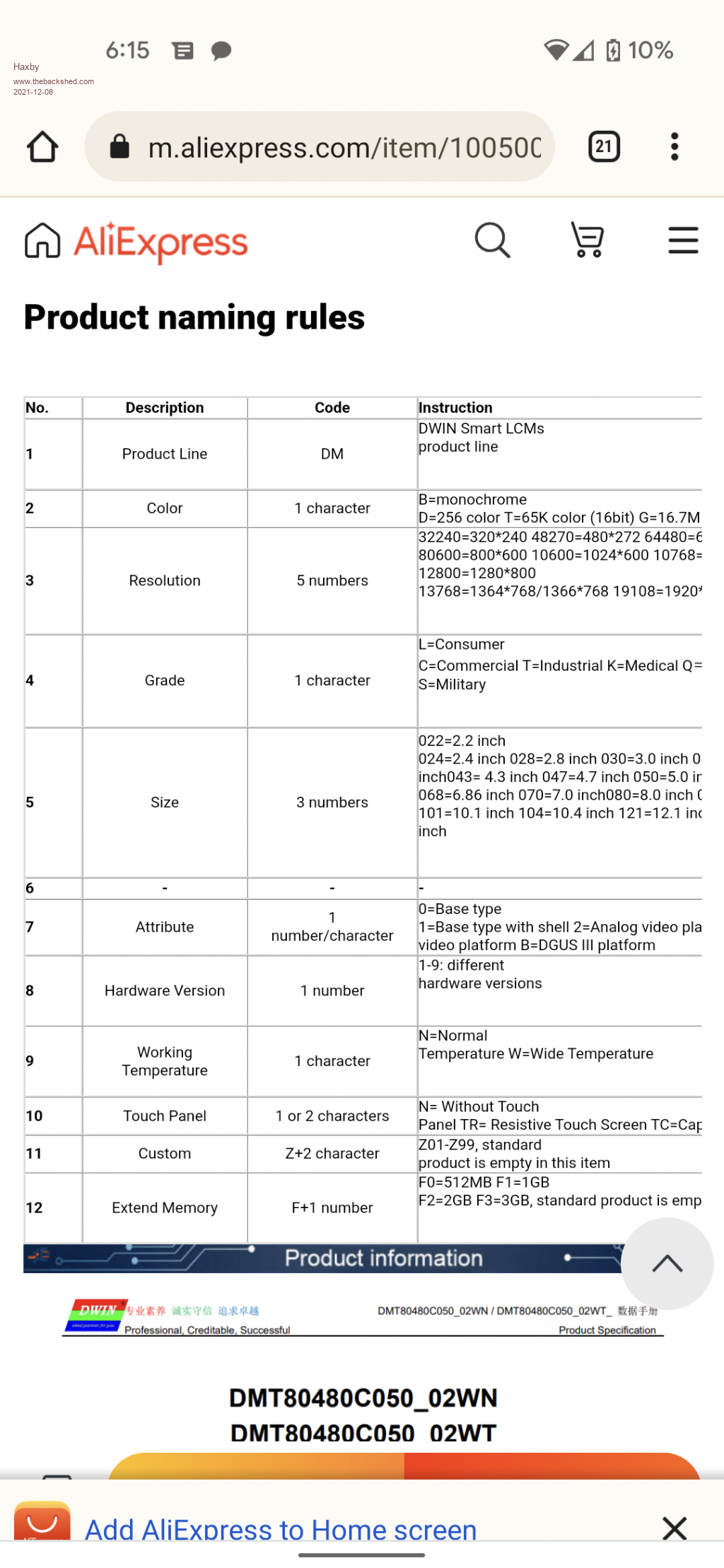

disco4now
Joined: 18/12/2014
Posts: 1157
Posted: 05:41am 08 Dec 2021
This looks like it.
Looks like touch pad is available separately, here Not sure if size is correct.
Edited 2021-12-08 16:11 by disco4now
F4 H7FotSF4xGT
morgs67
Joined: 10/07/2019
Posts: 78
Posted: 07:00am 08 Dec 2021
maybe this
is closer. There is a decode of the part number in disco4now's link
cheers tony
Haxby
Joined: 07/07/2008
Posts: 427
Posted: 07:20am 08 Dec 2021
Thanks Tony and disco. That's all good detective work!
The decode of the part number just raises more questions as none of the links nor the LCD in my hand have a part number that has "TR" (resistive touch screen) or "TC" (capacitive touch screen)
Mine just has a "T" in that place which could be either
See my photo above for the part number.
Also below for the decode:
