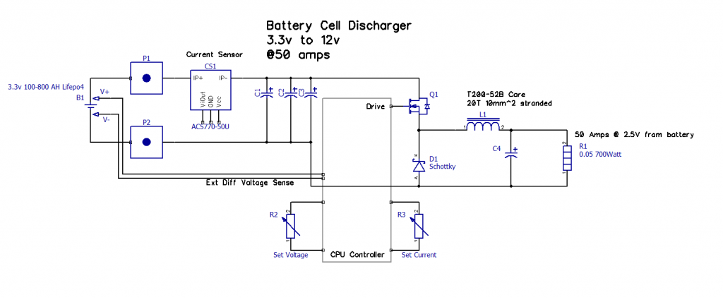

Think I might make something using a simple buck converter, to load up the battery under test with any current between 0 and 50 amps, set by a 10 turn panel mounted pot.
Same for the battery voltage end set point, use a similar pot to present a reference voltage to the cpu; cpu will have a 4-wire differential voltage sense connection to the battery terminals to exclude voltage drops in the high current wires.
Something like this, block dia.
Building it this way allows connection to different battery cells without having to alter the load resistor too much. The cpu can lower the current as the battery gets down to its end point.
I will get 7 of those 100W 0.33R aluminum shell resistors and place them in parallel bolted to a sheet of alloy with a small fan.
About to send some pcbs away, so will make up a design for this in the next week or so.

Something similar like I do, did you also consider the boost converter topology?
Electricity is very precious for me in winter so I made a small boost converter, also because my Chinese module died and I wanted something stronger.
This way I can test batteries on an efficient way, I just connect for example a 12V battery to the boost converter and dump all it's energy in the 48V main battery.  The pwm is created by a TL494 wich can be shut off by the bms or something else. In my case it limits the input current and the output voltage.  I did try it on 3,2V lifepo4 cells too and was amazed by the current handling, 40A input with TO247 components no problem, wires need to be thick and short or it's limiting the current just by wire resistance alone.
