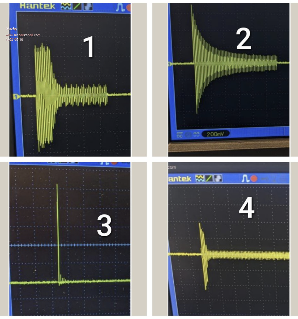

This will give you a feel for startup currents. My resistive heater had no discernable startup current but other appliances can be brutal!
Startup currents as measured by my current transformer, on 240v mains, using an oscilloscope set to a slow scan that can show resolution of hundreds of samples in one 50hz sine wave.
Graph 1:
2.2kw belt drive induction motor on a 50L air compressor:
50 amps for 300 milliseconds after startup
Graph 2:
Universal motor on a 255mm miter saw. 50 amps tapering off as it spins up in free air over around 500ms
Graph 3:
A big 2.5kw isolation transformer with no load connected. 100A for just one half of a 50hz wave! This one trips my RCBO when I plug it in sometimes. The transformer is of unknown origins.
Graph 4:
One leg of a 3 phase 2.2kw induction motor with 2kg of flywheel attached. 45 amps for maybe 150ms.
Edited 2022-05-16 13:35 by Haxby

Haxby's pictures tell a very good story what your inverter has to cope with to start different loads.

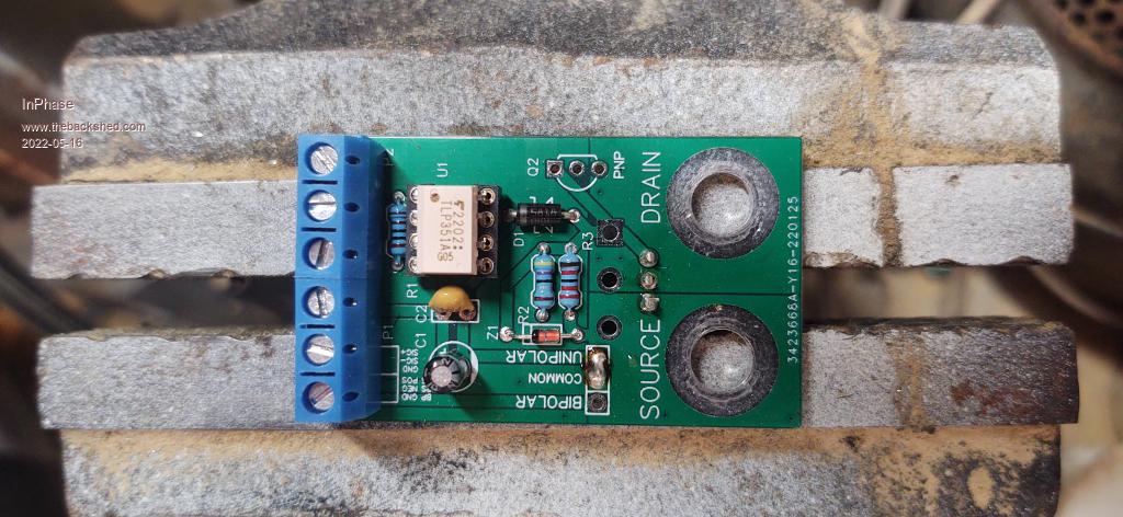

By the way, TLP351 on each fet sounds to me like a bad idea. They take up to 700ns to turn on and only 0.6A. I'm not an expert on these designs yet so maybe more experienced members can confirm, but you need all fets within the same half bridge to turn on an order of magnitude or two faster than that.

Those TLP351 opto drivers have a +- 500nS variance between devices, if you use one on each mosfet then it is hit and miss whether they all switch simultaneously.
Their 0.6A output is also rather low to be driving high capacitance input devices.
If there is any large variation in timings then its quite conceivable that when placed in high stress, like turning on a high surge current motor, one mosfet will fail, followed by the others in cascade.
I would test each opto driver in a circuit with a 20nF cap and paralleled resistor to make sure they are all transitioning within 10's of nSec of each other.

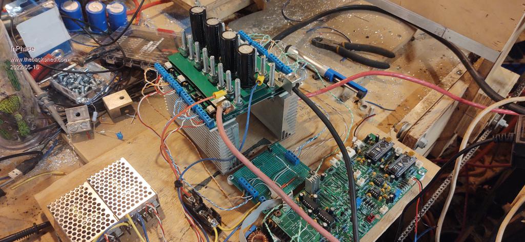

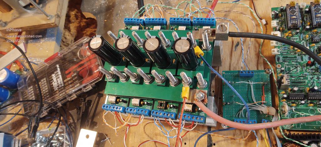

Also, sorry Haxby. I keep replying and not specifically answering your questions. I do not have a differential scope probe. The best I can do at the moment is measuring the two signals at the input of the opto couplers.
Here's a couple of pics of the assembled unit and the FET unit it is based on. Keep in mind this is just a testing setup. I originally had the FET boards made to make use of high side switching for a few high current projects and I liked them enough I thought it was a good idea to use a bunch in parallel. I didn't even consider the propagation delay of the opto drivers. Back to the drawing board I guess!

Ok so you are running 4 X 2 fets. Yep; likely the timing is out between the pairs.
As for the fet types, I'd suggest ordering some beefier ones. Either from a reputable local supplier or from aoweziic on Ali express.
