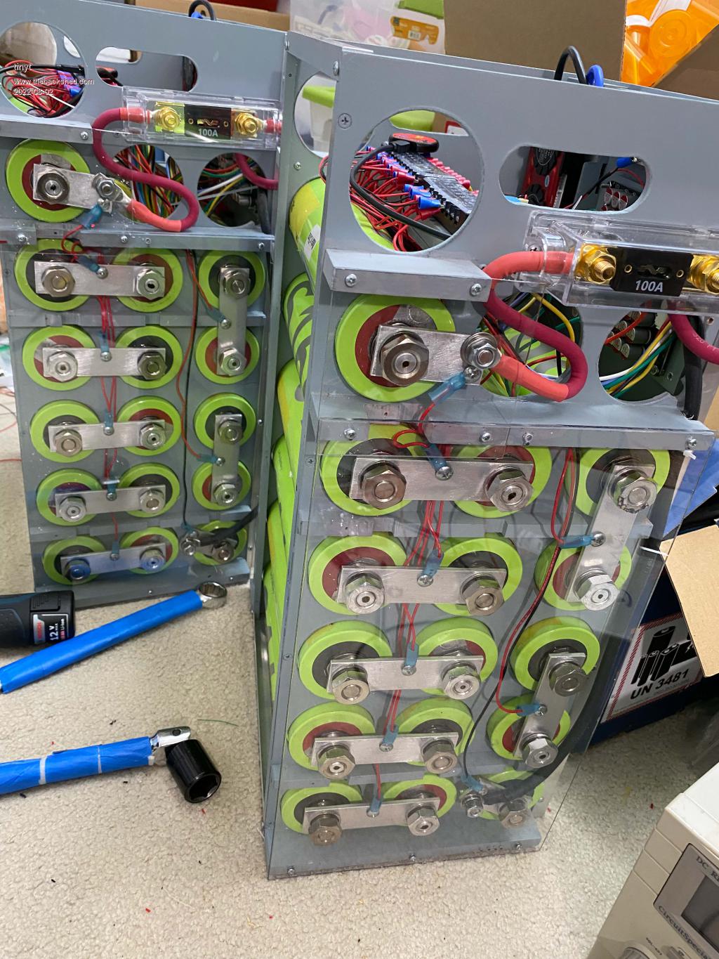

Here is what I am working on, 2 racks, each rack has 16S S168 (55Ah) LifePo4. I am still struggling how to make the Daly smart BMS work. Bluetooth always disconnects after about 3 seconds, when it is connected, it shows eep error or something. Will be replacing Daly with JK, I hope it is more stable and user friendly. I also have replaced the ANL fuse with type T which is what the experts recommend.
Edited 2022-08-02 23:27 by tinyt

Thanks mason, I have seen that before, my problem is not a dead blue tooth connection. Bluetooth connects to the phone ap when the bluetooth module button is pressed. It is just that after about 3 seconds, the ap freezes waiting for an OK response to a disconnect request. Maybe it is in my cellphone or something. Also, when the ap is active, it shows an eep error message sometimes. And this happens to the two Daly smart BMS.

Nice, Quite a bit of work there, I see you have a active balancer on each rack as well, no problem.
I have 3 Daly BMS units, one is 175AMP in the shed and has run well, no problem, the other 2 are 200Amp and work a little different, perhaps the firmware is different.
There all have the Bluetooth dongle (no switch on it) and the phone app is ver: 1.91 on an old unused phone (no sim or network for years) the the Blue tooth app run perfectly for 18 months, always on and could check the BMS anytime, until one time it started to jam up, turns out it was the phone that crashed, restart the phone and its been going ever since.
I tried the app on my own phone and it was ok until the auto update brought the BMS APP up to version 1.92 and it then wanted to have location information turned on or I Couldn't use the app .....bugger that, stuck with the old app on the old phone.
the Daly BMS has a sleep timer default is 3600s, but I have no idea about you error message.
Might find some resources here https://diysolarforum.com/resources/categories/bms.6/ there is some JK info as well.
Cheers Aaron

Thanks for your info and link. I am also a member of that site and have downloaded some of the resources. The sleep timer on my 16S Daly is set to 65535. I did some more Daly testing ang just found out that when I turn it on by momentarily applying 58V charging voltage, it turns on but also turns off after about 3 seconds. Must be some incorrect parameters that I have set or that eep error or could be wrong BMS, the marking is LI-ion not LifePo4. Will keep testing, will also try the PC resident PCmaster software, maybe I will post my problem at that site later.
