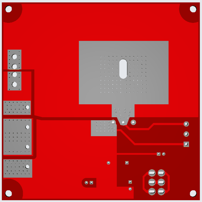

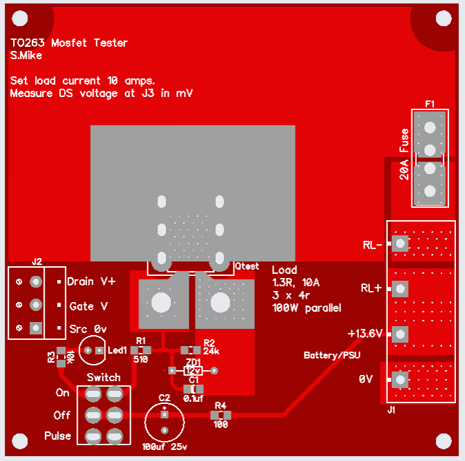

I need to test 100 or so used TO263 mosfets, purchased off AliExpress very cheaply. Expect some are not working, but as they have been snipped out of old equipment, they appear original, so hopefully ok. Main requirement is to measure the Drain Source resistance under load.
So I need a test jig that clamps the surface mount device to measure, these devices are quite small and fiddly, unlike the TO247 devices that have long legs to clamp too. Have   made a 100 x 100 pcb to accommodate all the bits.
A 12 volt variable PSU will be used to power it and 3 x 4r 100W metal shell resistors in parallel as a load. If I use 10 amps as the load, then its easy to convert the mV drop across the Drain-Source pins to ohms. Mount the pcb on an alloy heatsink with the power resistors, may need a small 12v fan, will see.
Using a large copper pcb terminal with a 4mm bolt to clamp the mosfet down and couple of 4mm brass bolts with copper washers and a knurled nut to clamp the other pins
Alternative to to wait 18 months - 2 years to get an order off Element14, its almost impossible to get any semiconductors now, even some resistors are 12 month back ordered.
No circuit for this, pretty simple, may make a clone for doing TO247 devices.
Edit: updated the gerbers to have incorrect J3 wording changed to J2

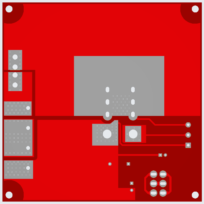

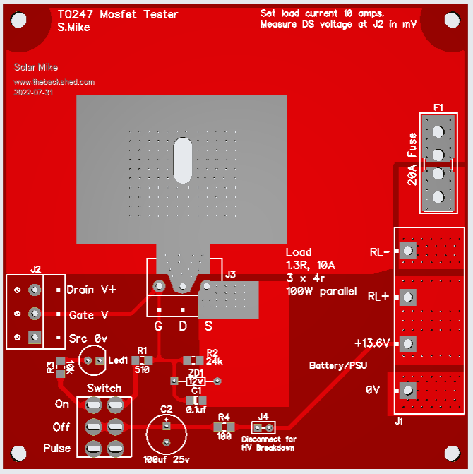

TO247 version, was only a few minutes work to create.
The mosfet to be tested sits on a 3mm thick copper spacer clamped by a bolt and wing nut; pins clamped by 15A rated 3pin socket.
Gerbers_Tester247.zip
Have a few dodgy suspect fake to247 devices here from past inverter builds, be interesting to check them out.

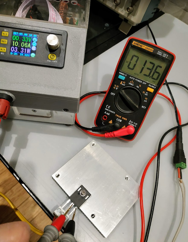

For now I use something simpler for TO247
PSU set to 10A CC and 12V adapter for the gate.
The HY5608W measures nice 1.36m?.
Edited 2022-08-01 23:51 by gaspo

Roger, its 'very' important to place the probe tips exactly at the same place each time. As seen in Gaspo's picture, right against the Cmos body.
If you have it on a heatsink it should not get warm enough to change the reading if it's on a heatsink (good idea with 10 Amps )

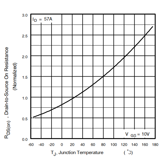

Rds(on) is greatly effected by temperature.
For example, the IRF3710 (100V, 57A, 23 mOhm) has this as it's
Rds(on) v temp
"Normalized" means the left hand axis is "1.0" = 23 mOhm
and so "2.0" = 2x 23 mOhm or 46 mOhm
at 25C it's at 1.0 or 23 mOhm.
At 80C it's 1.5 or 50% more resistance.
These temperatures are at the junction. Not the case temperature.
The junction is always a lot hotter than the case.
Again, looking at the IRF3710, the thermal resistance from junction
to heatsink (with a good flat surface and thermal grease) is 1.25 C/Watt
so with a huge heatsink at 25C, the junction will be 1.25 C hotter than that
for each Watt dissipated.

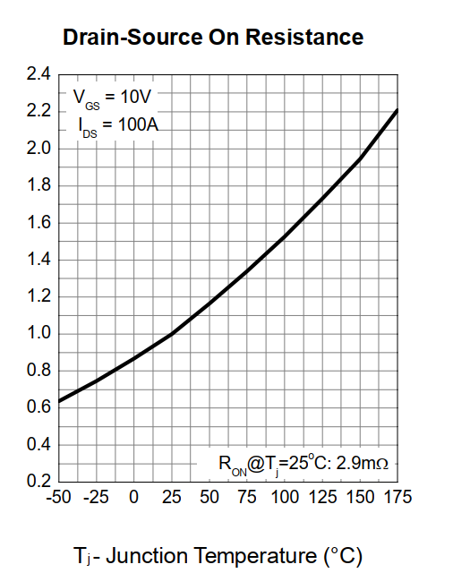

HY4008 is better, it's 0.4 C /Watt junction to case.
But it works both ways, a little heat or cool applied to the case
goes straight to the junction. You saw this with the small heat and cool tests.
here is the HY4008 Rds(on) v temp curve.
It's nowhere near as sensitive as the IRF3710 but it's still
going to change due to temperature
