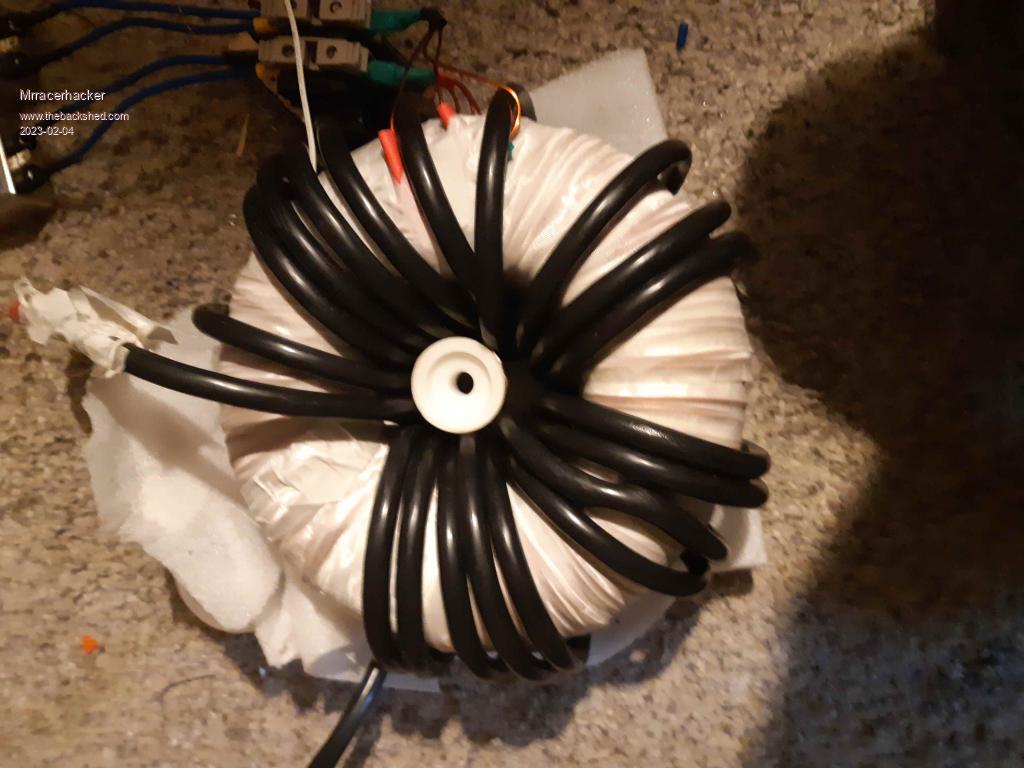

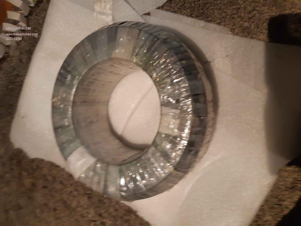

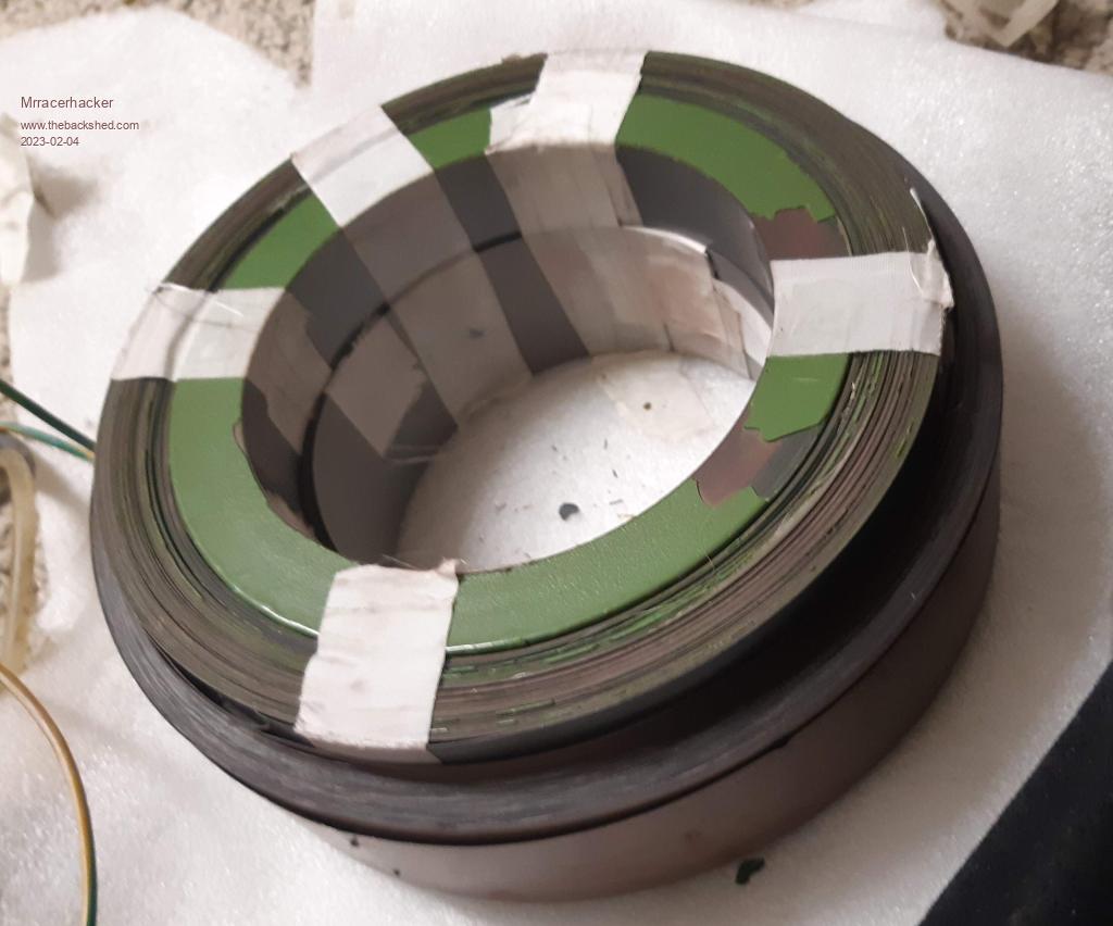

Had a long time project, taken a few months to get where i am think started a bit after summer with reading, but do got the time so thought why not, at the moment its not more than a ups setup, but thinking adding some wind/solar in later time had 3 cores of various sizes, unwound them and got wrapped them together, not the best job, cast in a bit of epoxy then wrapped with mylar wrapping

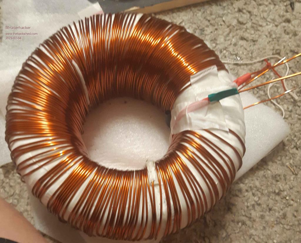

then went for a few layers of "glass fiber transformer tape"  and some more reinforcements on the egdes, would prob recommend just grinding a chamfer, learned from earlier mistake, better if you got "smaller" cores its good go for as big as hole size as you can id say, makes it easier, this is 130mm ID 230mm OD and 90mm H, Core is around 1,4V per turn which gives 169 for 240.
onle last layer unsure if i got another pic should have somewhere of the last layer, but alas, it is 1.8mmX3 which should be good enough for 25a not that i need that much. primary cable is 50mm2

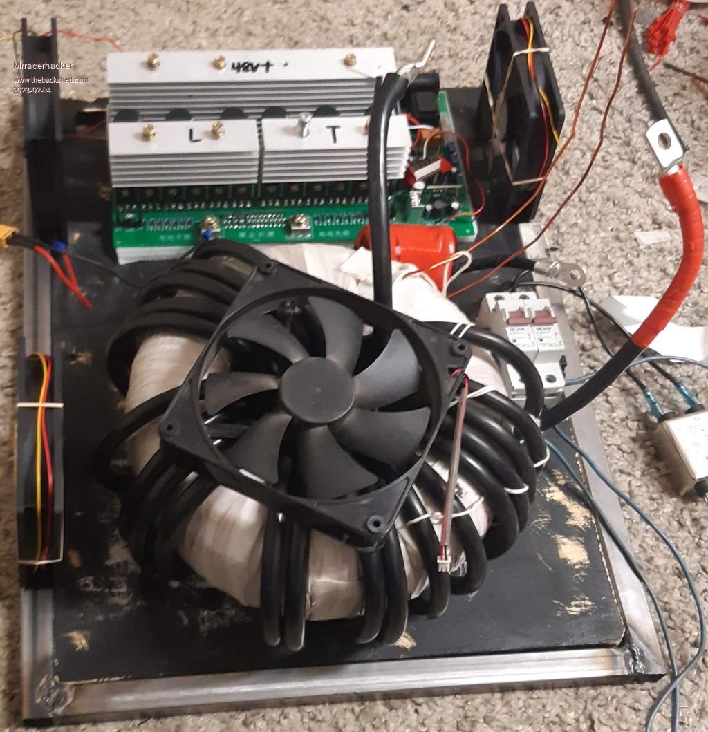

this is ca the layout, working on the enclosure now. got the plates cut just need to weld them up but not pictured yet
got alot of 48v batteries from ebikes which i want to use, but thinking lifepo4 in the future safer that. done some testing on the bench with other toriods and such, tho know i should make a choke, got  one but thats just one bought from china
need to find the right inductance to reduce the humming, as it do hum a bit, but not too bad, but know it can get better, do have a few caps i can change out

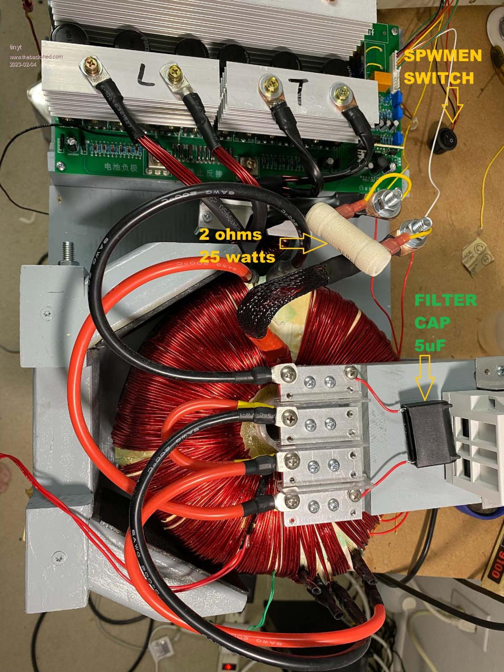

I have a similar setup. The toroid is a modified 5kva.
Looks like we have the same inverter power board from aliexpress which uses a substitue EGS002. I have also modified it slightly, also I am now using EGS002.
The 2 ohms in the picture is temporary which I added at first power on just in case there are shorts, it is now removed.  I have also changed the 5 uF capacitor to lower idle power (very slightly).
This is still a work in progress.

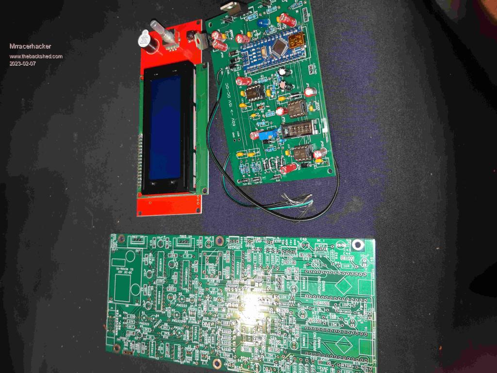

got my boards yesterday, soldered up the picoverter, nanoverter for later usage, no magic smoke when ran at 15v which is good

If you have a CRO or DSO, have a look on a few pins on the IR2148
when you press the "run" button.
Check Pin 1 for PWM output from the nano, should be 5V pulses
Check pin 4 for the low side drive, should be the inverse of pin 1
and at 15V too.
Notice that the two gate drive chips are not aligned the same way.
One is up and one is down.
Vfb will be a bit tricky to set.
I always use a bench supply so I can take it up
from about 30V seeing the output AC voltage. The trimpot needs to be set
to your desired output voltage and sometimes the trimpot is set already
to make the inverter output way too much.

Got a Cro will take a look. gate chips are okay, this ver got them inverted, can take a pic of the board when im home, but pretty sure as inverted VSS points

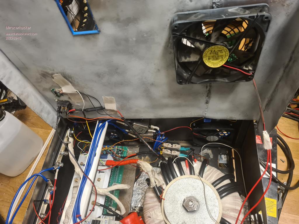

Bit late, forgot to upload some pics, been running here and there for the last year, tho no real high load, idle is at 36w if i recall right, should rewind the choke for another one one day, should should tidy the wires a bit better but goes so far, next for this one is i think getting some transformer varnish under vacuum and coating the transformer.
Welded steel box out of scrap sheet
