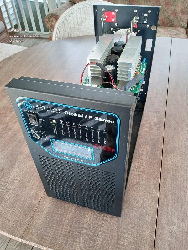

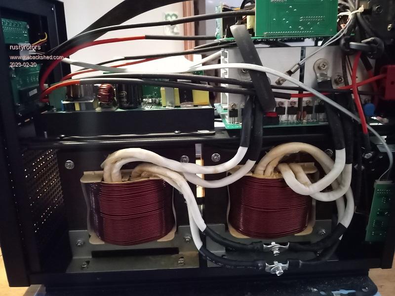

so i bought this aims 24v 6kw inverter/charger about 10yrs ago.. i quickly discovered it pulled 180W at idle, which drained my battery dead in a day, very disappointing. it was also stuck at 50Hz if no grid power was connected, and i need 60Hz offgrid here in USA. i contacted aims to find out how to configuire for 60Hz permanently, but they said they could not help, they no longer have the schematics for the older units. so its basically unusable for my 2kw full offgrid solar setup. it also had the breakers wired incorrectly, would have been a fire hazard    so it sat unused until recently, i discovered this forum, been reading how to build a diy inverter. my plan is to retrofit it with an EGS002 board for better efficiency, and ill have a nice backup inverter
here it is with cover pulled. i measured the draw on the trans individually at 115V.. 55W each no bueno. the fans drew 35W and ran constant. i yanked all the guts out, but kept the mosfet board.

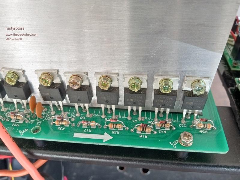

The mosfet board had 24 IRFB3206 fets, each with 47 ohm gate resistor, no reverse diodes. To work better with the EGS002, I swapped the gate resistors for 30 ohm and added 1N4148 reverse diodes. i figure that should keep current draw from the IR2110s under 6*12V/30ohm = 2.4A

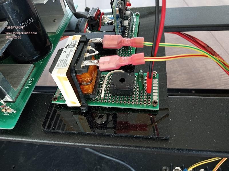

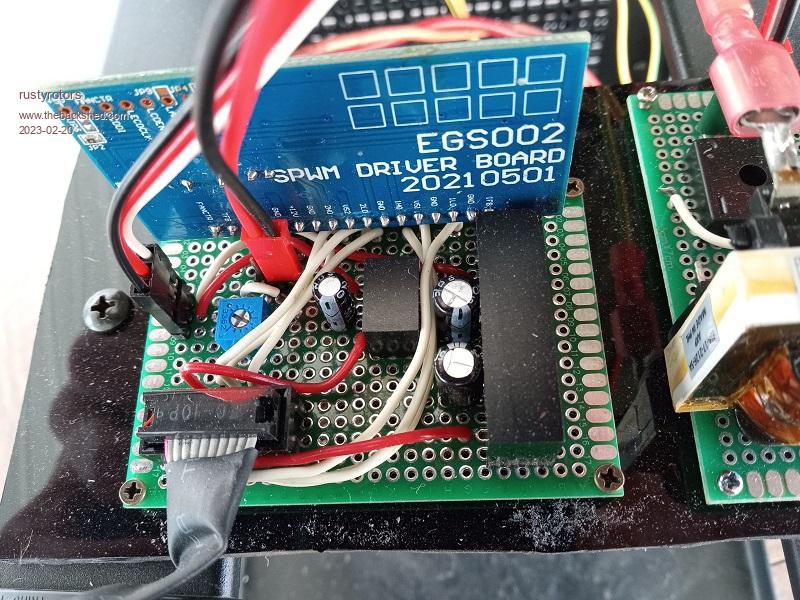

Adapting EGS002 board
first had to fix the snap crackle pop bug on the EGS002.. i removed U4 and shorted C19 and C24 to disable overcurrent protection. i made this super minimal board for adapting the EGS002 to the aims mosfet board.. it has 5V and 12V supplies and a pot for adjusting AC output voltage
24V to 12V supply, 3A
https://www.digikey.com/en/products/detail/mornsun-america-llc/K7812-3AR3/13168201
24V to 5V supply, 1A
https://www.digikey.com/en/products/detail/cui-inc/P78E05-1000/9649654
it gets 24v power from the aims mosfet board idc connector, still need to should add a fuse inline somewhere, for got to put that on the board. Voltage feedback uses a 230V to 5V trans and a bridge rectifier i had laying around

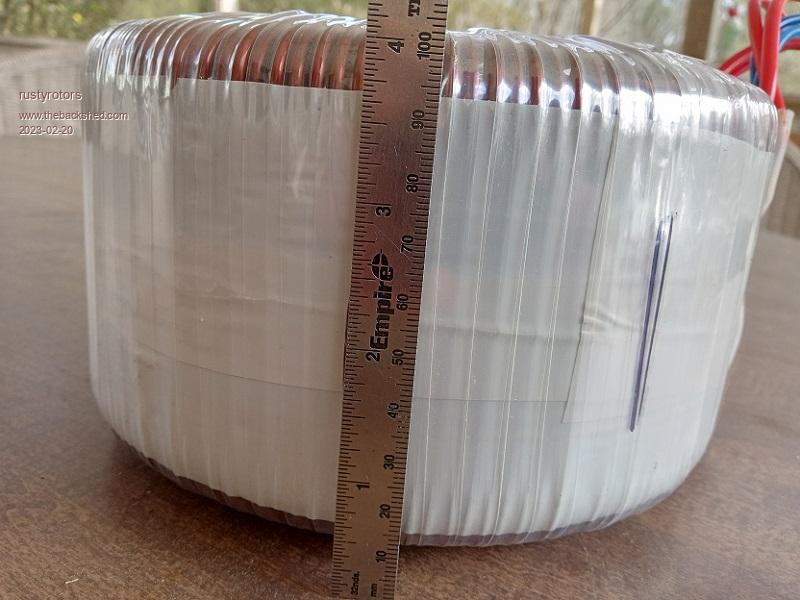

Toroid transformer
i came across these on ebay..
search for "5000 step up down transformer." they have big toroids in them with two 115V windings in series and a nice case for $100, convenient for USA split phase. all you have to do is add a primary winding for inverter use
https://www.ebay.com/itm/124889104671

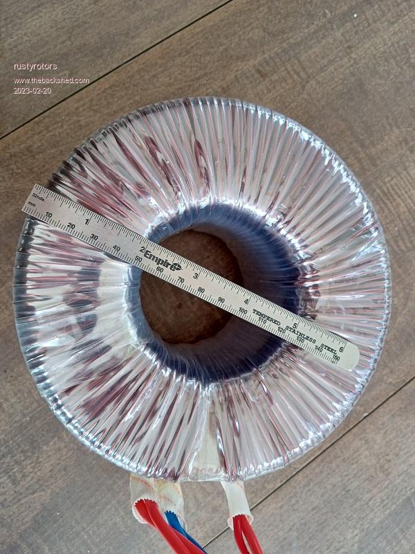

Here are the specs I measured:
core area 45x90mm, 36cm2
12AWG windings
146 turns per 115V winding
0.5ohms in series
0.8 Tesla
10W idle at 125V
it took about 18 turns of test wire for a 14v primary. it will probably be good for an easy 2kW. I ordered 30ft reel of 2AWG for the primary.. next have to wind that on and make a choke
12AWG windings
0.5ohms in series
0.8 Tesla
10W idle at 125V
Nice find but 0.8 Tesla seems a bit low.
Do you mean 2kW at 125v?

Based on your core area (1.77" x 3.54"), the inner most layer is (1.77 + 3.54) x 2 = 10.62 inches per turn.
The picture shows a wound toroid height of about 4 inches, the outer most layer will be 12.46 inches per turn. I used autocad to get this.
Above values will be shorter since I did not include the rounded corners.
Average of the above is 11.54 inches. Using this average and for the total of 146 x 2 = 292 turns, the total wire length is 292 x 11.54 = 3369 inches or 281 feet.
Magnet wire table for AWG 12 shows 1.588 ohms per 1000 feet. So, winding resistance will be 1.588 x (281/1000) = .446 ohms. Actual value would be lower since I don't know the radius of the rounded corners of each turn.
At 5000 watts and 230 volts, Current is 5000/230 = 21.74A, copper loss will be (21.74 x 21.74) x .446 = 210.8 watts.
At 2500 watts and 230 volts, current is 10.87A, and copper loss will be 52.7 watts.
I could be wrong.

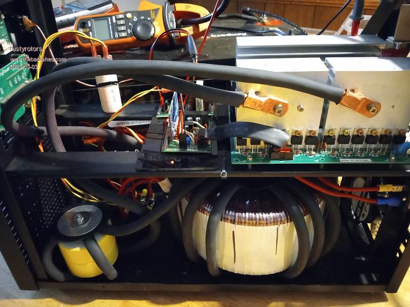

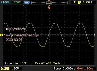

She runs! The choke is 5 turns on a stacked pair of powder iron T250-26 cores. used about 27ft of 2AWG welding cable on the trans primary and the choke. 2uF cap resonates about 90Hz. pulls 18W at idle, fan adds another 2W
yea i need to invest in a proper crimper
Edited 2023-03-03 06:41 by rustyrotors

i bought a proper crimper and redid the lugs. and i finally put a decent load on it, 2500W oven for about 20min, i could not feel any heat increase in the transformer. there is a fan blowing directly on it. i do need to add a second fan for the FETs they got hella hot. i tried my 115V air compressor which pulls about 2500W as well, surges almost 7kw on startup.  after about 5 seconds the egs002 shuts down, blinks 4 times, undervoltage warning. i am thinking maybe i need to remove a winding off the primary, get it closer to 13V
