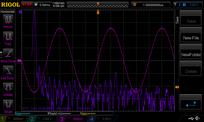

If you have a modern DSO, then you probably already have the FFT function
my DSO shows this:
the FFT is the Purple trace, the waveform is the Pink one
The 50Hz peak is the first peak you see, lined up at the top
of the display, one horizontal division across.
This is where nearly all of the voltage or power is contained, in the 50Hz part
of the waveform. This is not surprising, we can see the nice 50Hz sinewave
in the Pink trace. But there are some small deviations from a 50Hz sine..
These can be seen in the next and much smaller peaks.

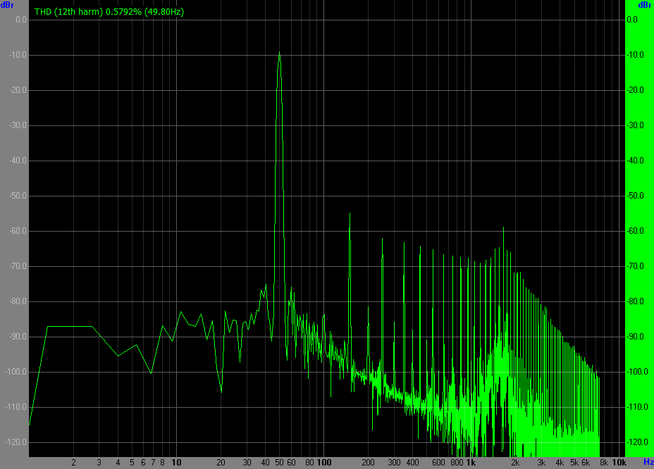

I found some nice and free (as in free beer) software that uses the PC
sound card and can show very detailed FFT plots.
The PC sound card seems to me to like an input up to 0.5V peak to peak but no more
or else it will overload and show the harmonics due to the distortion of overloading.
VASilviaBETA.zip
Once I set up something to give me 0.5V peak to peak sample of the AC output
I got this:
This is a lot better than the DSO due to far, far better signal to noise
We get better S/N due to the 16 bit sampling resolution of the sound card
(the DSO only has 8 bits) and there is something called "process gain" that comes from sampling the signal for relatively long time.
This result benefits from both of these things.
The noise level seems to be about -80db to -90db
This corresponds to a voltage level of the noise of about (0.5 / 10,000) V p/p
We can see the first harmonic is 150Hz at about -55db and when using this graph
it's really clear and easy to see.
The DSO can do it but it's no so easy to work out the frequency value.
The program also can calculate THD
In this case the X axis is log too, so its easier to see the low frequency
peaks since they are separated more.
This test used the symmetrical output firmware for the picoverter.
pico_2_heavy_filter_bv_better_stop_prefect_symmetry.zip
To make the above graph, set the sound card to sample at 22,050Hz and the sample
size to 16K, and choose the Blackman (exact) window. ensure the AC signal is
0.5V peak to peak (NOT 0.5V RMS! That will be too much, since
0.5V RMS is 0.71 V p/p)
And most importantly, use the "Line In" jack of the PC. Some laptops do not
have the Line In input jack and if you use the microphone jack you will
overload it and enjoy a heap of noise even when you reduce the signal enough.
Line In is the way to go.
0.5% THD is audio amplifier quality output. And this is an inverter..
