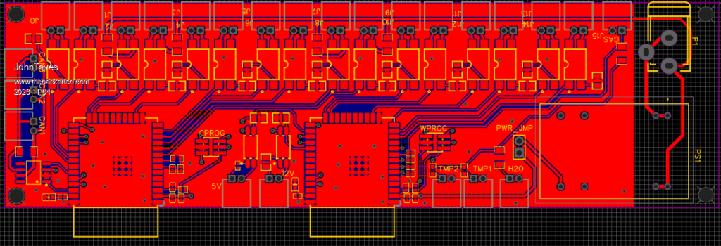

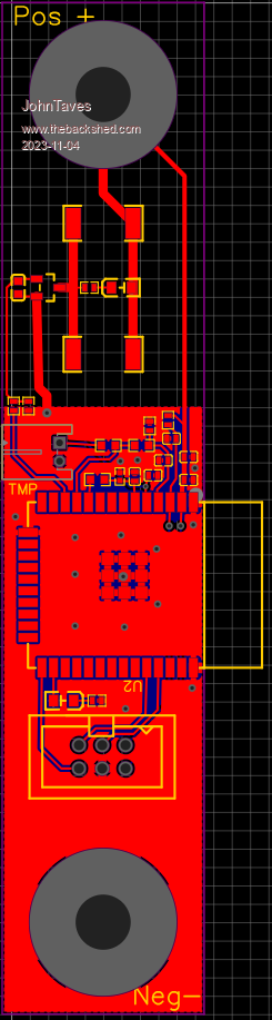

I made two esp32 based boards. One, the cell module, measures the pack voltage and temperature, and sends the info via bluetooth to the controller board. The controller board has a pile of SSRs to control things, a CAN connector, and bluetooth and wifi.
The cell module, has the form factor where you simply bolt it to the terminals on a prismatic cell that you buy from alibaba. The temp sensor does require you to wire a thermister and tape it to the cell. This board has 2 20ohm resistors in parallel that the software will turn on, potentially for hours, to give that cell a haircut if it is the first cell to reach the top V. The software can ensure that no one cell is always the one to reach the top V. These report their measurements every 2 seconds, and are asleep between measurements. After I implemented the sleep feature, I was unable to measure the amps. Prior to that it matched the expected ESP32 drain of a few tens of milliamps. Nobody will get excited about the ability of the esp32's A2Ds, but I find them totally acceptable for measuring cell voltage. They seem good to about +-.01V. I figure that I have no need to run these cells up to 3.65V which is supposedly the max. I stop at 3.5V so it makes no difference if the cell was really 3.52 or 3.48.
The controller board has 2 esp32s. I got tired of trying to get a single esp32 to do both the wifi and bluetooth. There are 16 total SSR outputs that are used to turn on/off loads and charging. There is a CAN bus that I use to capture the data from 2 Reidon SSD digital shunts. One shunt measures the pack voltage and amps, and another measures the solar amps.

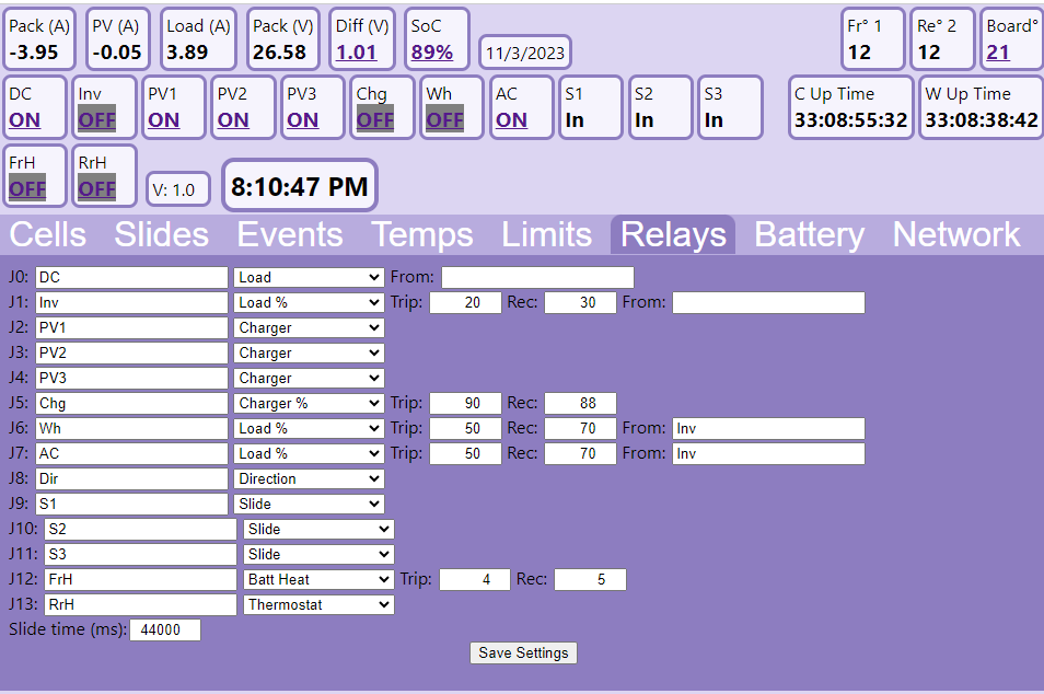

The software provides a web page where you set the # of cells and the various cut-offs and recovery values. The temperatures and gas and water levels are shown on the web page (the screen shots are from an earlier version, so no water or gas level).

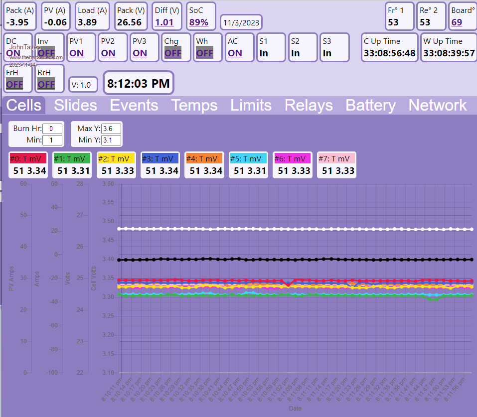

The software does coulomb counting to monitor pack state of charge. I have it set to stop charging at 95% and turn charging on after it drops below 90%. This means that the pack is almost never at 100%. I have my settings such that 100% is when any one cell has hit 3.5V and the pack amperage is less than 12 (I have an 2p8s 280ah so 13kwh total).
It will turn off the main cabin air conditioning if the pack state of charge goes below a certain %, and same with the electric water heater, which reverts to gas.
When any one cell drops below the minimum voltage, the DC/DC converter is shut off along with the inverter resulting in only the current necessary to power these boards.
Because the coulomb counting will accumulate error, I occasionally run the pack to 100%. The software has not been fully implemented where it will monitor what cell hits the top and then turn on that cell's drain resistor to give that cell a haircut to ensure that it will not be the one to hit the top next time. I just do this manually. Whenever I hit the goto-100% button, I check afterwards to see what cell was the top dog, and turn on its resistor for several hours.

You probably have a new battery and cell capacity deviation is no issue, but I think your system can benefit if you could start balancing once a certain difference occurs between cells. And not wait until a cell hits 3.5V to start balancing.
It will run the resistor for as many hours as you want, regardless of cell voltage. The first cell to hit 3.5V tells me what cell to give a hair cut to.
The idea is that I don't want the same cell hitting the max every time. That is more important than attempting to squeak out the maximum capacity. I have never run my pack to the bottom. I have no idea what cell capacity deviation I have. I suspect my use case is pretty common. If the battery is getting low, I use gas heat and limit the high energy devices, or I find a way to plug in. If the mix of battery capacity, solar array size, and weather means I am spending too much time running gas, the solution is to add more PV panels and Li cells. It does not make much sense to attempt to recover some capacity, that may or may not exist, from the pack.
