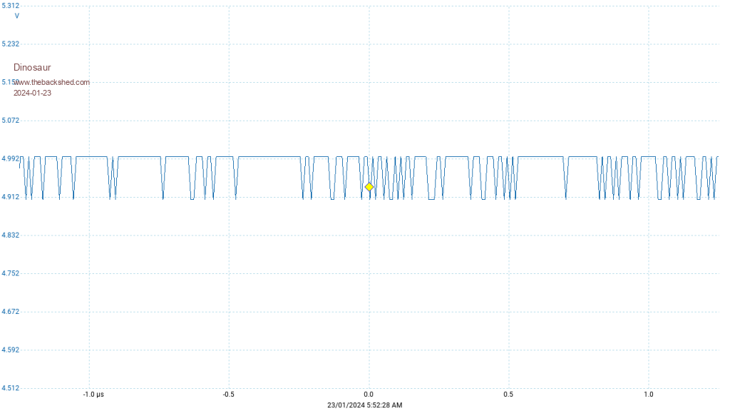

Before going down the path of using a dummy load, I thought I would hook up the cro and see
what the Switched Mode PS was producing on the 5vdc rail.
Even though I am getting a stability of about 4mA , I suspect it is because the spikes on
the 5v rail are being averaged in my 60 sec readings.Although there is an occasional high positive spike.
Adding a cap to the PS output didn't affect it hardly at all.
Coincidentally I read this article this article this morning on Hackaday.
The switching regulators I am using are from JayCar and can be seen here . There is no spec advertised other then Amperage.
My question is: Are these spikes caused by the Pico pulling on the 5v rail, or by poor choke
design on this step down converter.? I would have expected a more symmetrical noise if it was the step down converter.
Worth noting that I have tested this on a 13.3 v DC supply as well as a 12vdc wall wart.
My load current during this test was 40mA on the 12vdc.
I have observed the same waveform on my PicoScope 2000 and on an older crt cro.(can't remember the name,workshop is a 5 min walk away) with different probes at 1:1 and 10:1.
