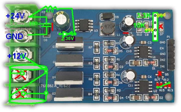

Looking for a ready to use power board, I found this on ali:
It has 2 half bridges with 3205 mosfets (80A max), and their respective 2104 drivers, a switching input for each half bridge, and a common enable input. Also found on the board is a XL7005 switching regulator, which  outputs 12V for the 2104 drivers.
Cost of the board was less than 10€ with shipping.
Only one half bridge would have been sufficient BUT has a very high current ripple. Two half bridges driven at 180º phase difference reduce this ripple dramatically. Furthermore, if the inductors of the 2 half bridges are coupled, you can decrease their size.
Here we use a SMPS common mode choke which is easy to find or recycle from a broken PC supply, it has to be used in differential mode.
Of course, the current will strongly depend on the battery unbalance, as well as on the circuit and battery resistance. To not destroy the switches (mosfets) by overcurrent, some sort of current control has to be implemented. Starting/stopping the DC/DC is sufficient and very simple, there is no need for duty cycle correction whatsoever.

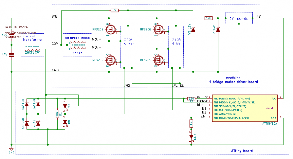

I ended finally with this simplified schematic
There are only 11 components on the additional attiny board, including the microcontroller.
      - 4 diodes to rectify the current transformer signal, one of them is a shottky, put on the direction signal to avoid it to dive below -0.5V
      - 2 resistors as current transformer burden. 10k to set the starting (Imin) level, the other one which can be disconnected sets the overcurrent shutdown (Imax) level.
      - Parallel to the fixed burden are 2 red leds in serie, this limits the voltage value below the attiny Vcc=5V, but let the signal grow above the 0.6*Vcc= 3V to be able to detect a high level.
      - A blue led and its limiting resistor are tied on the ENable output. This shows charging, direction is given by the blinking sequence.
Footnote added 2024-01-23 22:06 by less_is_more
To be corrected on the circuit:
Zener diode on the 5V dc-dc is not 24V, but 36V

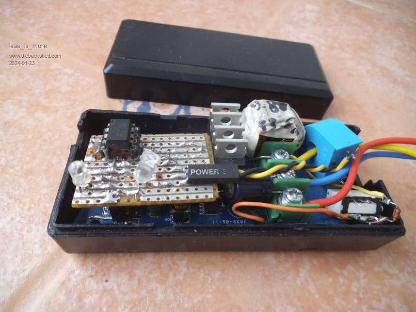

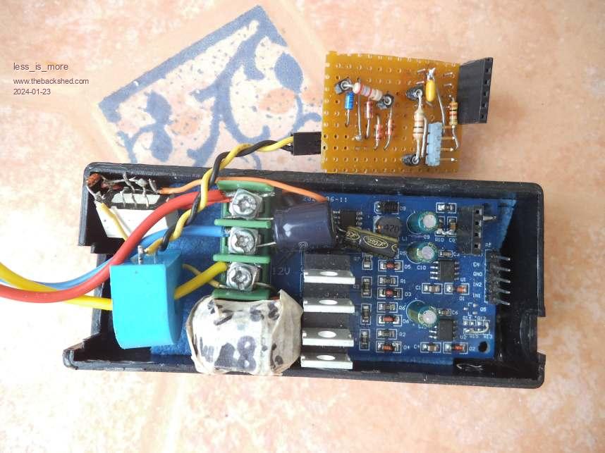

This is the resulting prototype.
It all holds in a 100*40*30mm volume. The plastic box is from a dead adaptator.
A little relay between 12V-24V has been added here, only for use on the car: this cuts the XL7005 supply when contact is off, shutting totally down the balancer.

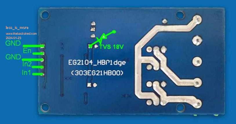

The powerboard has been a bit modified:
- a PNP transistor inverting the ENable signal and its resistors have been stripped to permit direct access to the 2104 shutdown pins.
- the 12V switching regulator has been modified to output 5V, its LED unsoldered to reduce consumption.
- the 2104 chips are now driven directly from the low side 12V battery.
- the MOT+ and MOT- screw PCB connectors are replaced by the common mode choke connected in differential mode to the 12V connector
      measured choke inductance is: 8mH , 33uH leakage
- added TVS/Zener protections on the 2104 driver supply and XL7005 supply
- added connector on the XL7005 unit to pass the 5V supply onto the attiny board
- added 220uF capacitor on 24V
The control board is realized on a stripboard which holds on 2 powerboard connectors. Another little plug brings the current transformer signal.
The attiny has to be DIP8 on a socket. You need to remove it for programming, to do on a HVSP programmer because the reset pin is also used.
(the programmer can be made with a nano on a breadboard with few components)
This mounting did'nt give any problem mounted on the car, but is well maintained in the box.

First of all, I found some more errors in the circuit, here is the corrected one:
balancer_circuit_V1.pdf
