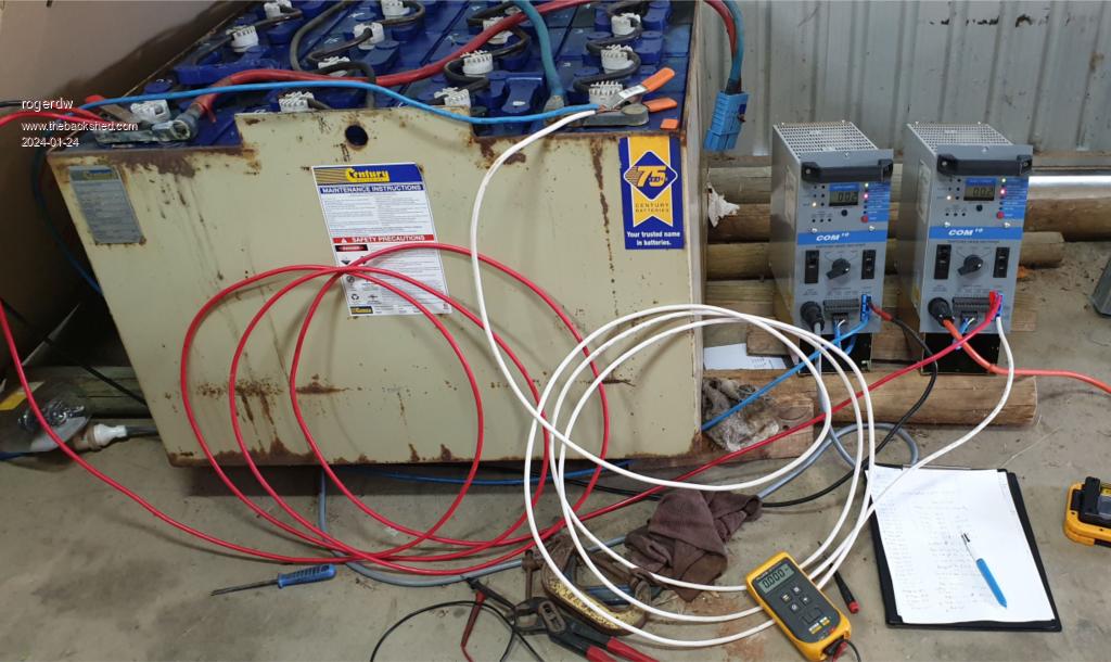

I’ve mentioned this guy before  …  the local forklift sales and service guy  …  and I’ve rung him a number of times and he always says he’ll look and get back to me  …  but it’s never happened. So after lunch the other day I jumped in the car to visit him.
He said that his supply has dried up and there was nothing around  …  but then he hesitated and said he did have one that he wasn’t sure about. Showed me this big brute, 48V and 980Ah and said he’d take it up the workshop and put it on charge and see what it was like  …  then let me know.
I asked how much and he said “$500 … scrap value”. Sounded reasonable to me. Anyway as I was driving home I thought I should have just taken my chances and bought it on the spot coz I figured I wouldn’t hear from him unless I kept harassing him  …  so as soon as I got home I rang him back and said I’d take it and take my chances. Hooked the trailer up and went straight back over.

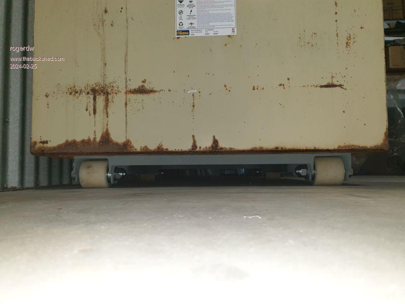

At 1,330kg it was a bit much for my 7x5 trailer but I got home okay via the back roads and keeping a low profile. He even left the lifting strap on it so I could unload it and I took it back in the morning. My poor old David Brown tractor (that’s even older than me), wouldn’t look at lifting it no matter what I tried, so I wrapped a chain around the two c-sections in my shed doorway and fitted a block and tackle. I also used a length of heavy 90mm square steel post to prop under the cross piece so I didn’t bring the roof down. It all unloaded okay, but made a bit of a mess of the c-section. I’m a little embarrassed about that too.
The battery was still sitting at 48.2v despite having not been charged and having been out in the weather for months. I gave it a charge using a couple of ex data centre COM10 battery chargers that I bought off Marketplace for $50 each. Good for up to 50 amps 45-54 volts  …  and 26 amps 55-65 volts (each).
Cheers,  Roger

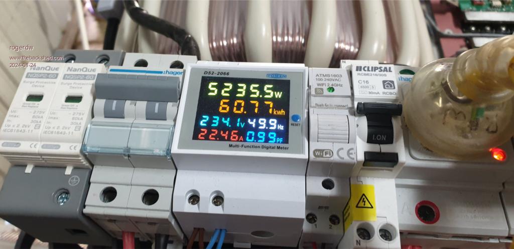

I finally had to bite the bullet and really try out the Warpverter to do a decent discharge on the battery  …  so I fired up the pool pump  …  and then the pool heater pump  …  1,800 watts combined. That’s the same pool pump that’s had a treadmill dc motor coupled to it and running directly from solar panels for the last three years.
I was really apprehensive when I switched on the first pump and wasn’t sure what was happening while watching the power meter. The numbers were all jumping around and I didn’t hear any changes to the slight buzz the thing makes while idling. Then I just plugged in the second pump and still no audible change. I had to run outside to hear if the pumps were actually running, which they were. Phew!
I ran it until the battery dropped to 46.3 volts  …  which took 12 hrs and 10 mins. Total kWh was 22.34kWh
I then recharged it again which increased the specific gravity only a small amount and the next day discharged it using the same pumps but also adding a 1,500 watt heater for a total of 3,300 watts. Of course it discharged more quickly than the previous test  …  and when it got to 46.4 volts I switched out the heater. The battery volts increased for some time with the reduced load, and then eventually dropped to 46.3 where I switched off.
Turned out it was virtually the same kWh as the first test  … 22.86
After another couple days of charging and trying to raise the voltage more, I did a third discharge test. This time I added a kettle and boiled that a number of times  ... bringing the load up over 5kW. I used Davo's trick of pouring boiling water over the weeds near my shed.
Total power was 25kWh  ...  though it could have gone longer if I was prepared to run the batteries lower.

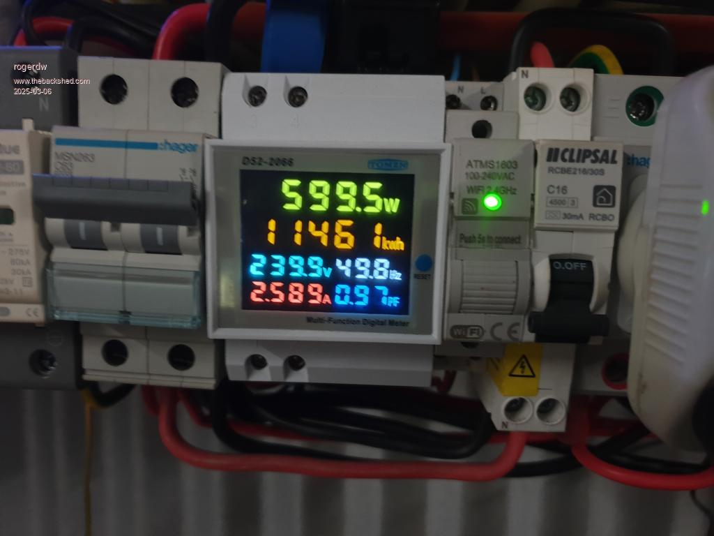

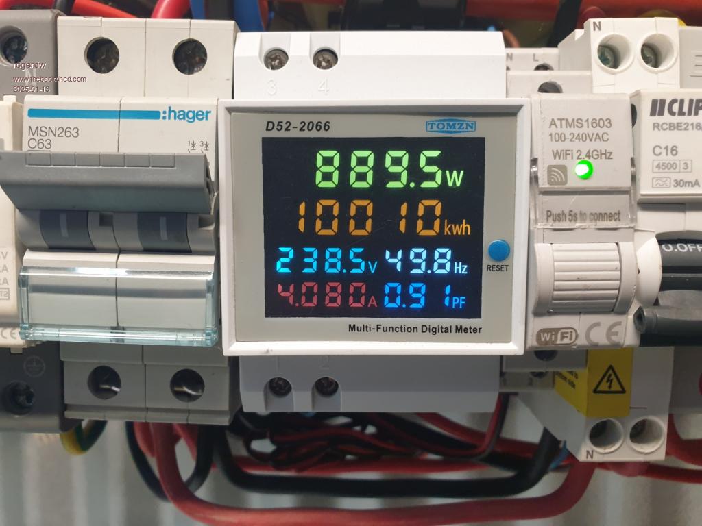

I'm not certain of the idle current now. One of the first things I did when I got it going was to measure the idling power  ...  and the control board and the 80-12V dc-dc converter and all the isolated supplies draw 6 watts  ...  and then combined was 31 watts  ...
...  but yesterday I measured it and it was looking more like 50 watts  ...  so I'm not sure what I'm doing different, other than running from the forklift battery and not just the small UPS batteries.

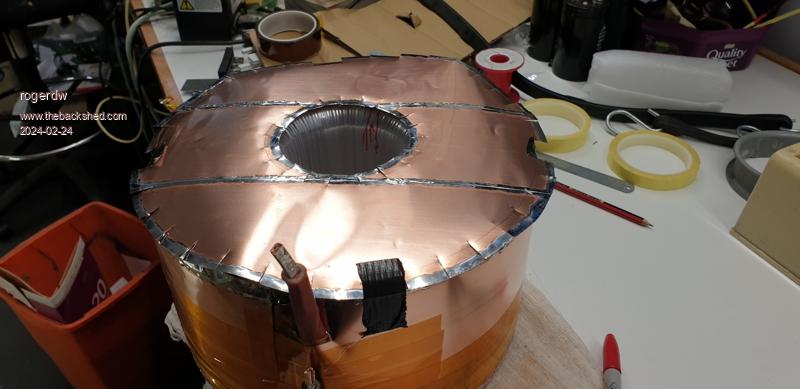

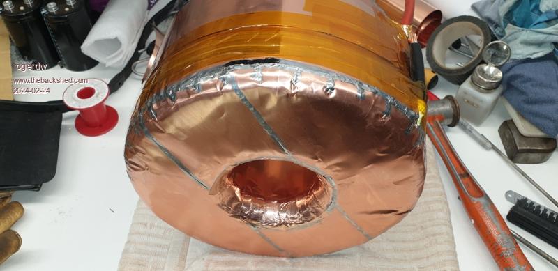

As I mentioned over on Alston's thread, I wasn't really sure if having a spacer between the core and the first windings (secondary) made much of a difference, but Tony is confident it will have reduced the spikes and inteference lines somewhat and was worthwhile doing.
There was still enough inteference that I wanted to address it still  ...  so before I just caved in and bought a 60 amp EMI filter I decided to try an electrostatic shield first.
I figured it should be easy enough as I had plenty of the shielding strip from the unwound Aerosharp toroids  ...  but as Tony pointed out  ...  putting a hundred turns around the thing is just like a hundred turns of wire and even with the earth tapped off near the centre, the ends would have quite high voltage on them.
Seems the only way to do it properly is to create a shield like Klaus and Mark did quite some time ago, out of sheet copper.

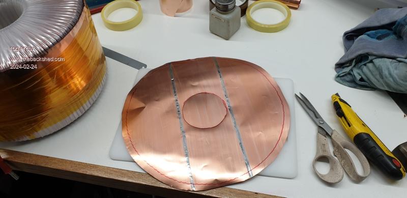

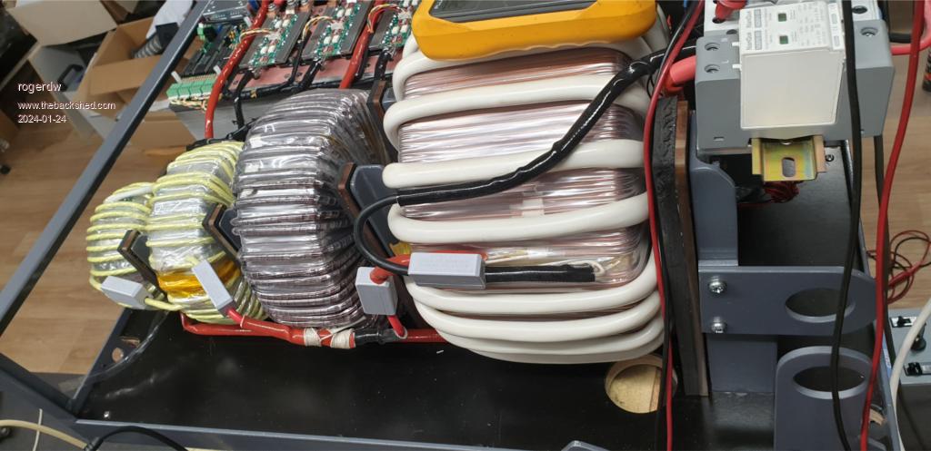

Anyway, I rolled out the big transformer and removed the primary winding and set about wrapping the thing. I'd bought a 3.5 metre roll 100mm wide by .1mm thick as well as 1 metre of 200 x .1mm off ebay.
I made two big "washers" by soldering three strips together and cutting out for the top and bottom. I cut tabs all the way around so I could fold over the edge and solder to a 100mm wide strip wrapped all the way around the outside.
So that I didn't create a shorted turn, I wrapped a few layers of mylar around the outer copper and then taped with kapton tape.
I used all of the 100mm wide sheet and then cut just a few narrow strips from the 200mm wide roll to join top to bottom through the hole. Because I cut and folded tabs there too  ...  there were a few minor gaps, so I covered them with some adhesive copper tape I had lying around.
Pre-tinning the edges made life much easier when I went to join them  ...  reheat with the iron and fold over with a heavily gloved finger, which kept it nice and tight
You can see the adhesive tape used at the exit of the centre hole which covered a lot of untidiness.
Cheers,  Roger

Edit: I forgot to mention I wrapped the copper in mylar before fitting the primary back on.
Then I had to rewind the primary  ...  22T of 70mm2 wire!!!
And of course the wire wasn't quite long enough despite my efforts at stretching it as tightly as possible all the way  ...  so I had to join on 5 inches to reach the terminal.
Fired it all up and really couldn't notice any difference to the output waveform. I tried a few configurations of where and how to earth it  ...  but it didn't change.

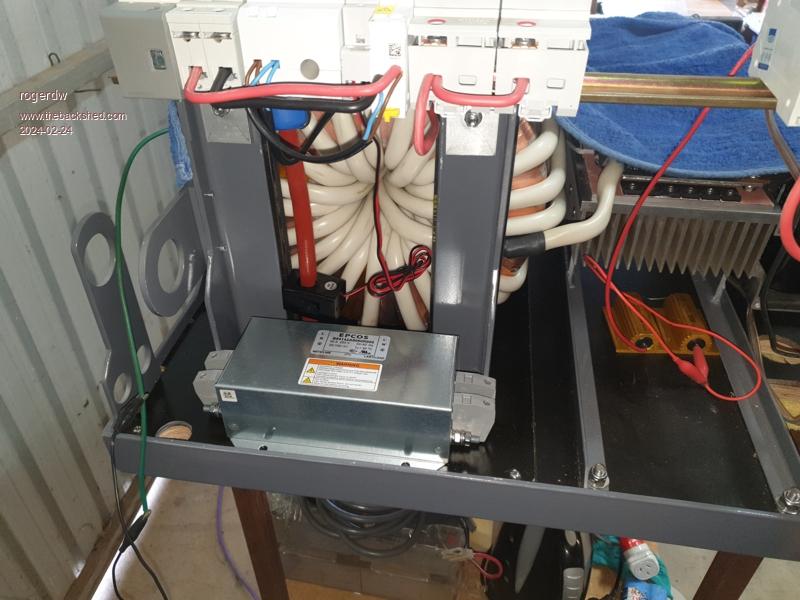

In the meantime I bought a 60 amp EMI filter from element14 and mounted it ready for when I try again. See here  ...
The element14 picture shown is of the baby brother  ...  the one I got was freakin' huge  ...  245mm long by 85 x 60mm. One good thing was it has terminals to suit 16mm wire  ...  so I didn't have to fit ring terminals and then try and insulate them to keep it all safe.
There was only one place that it could fit and it went in snuggly, touching all the way around  ...  but I still decided to get in there with the angle grinder and die grinder to create some clearance around the terminals. Fitted well in the end.

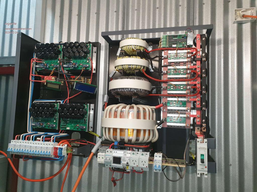

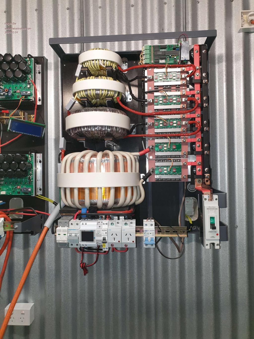

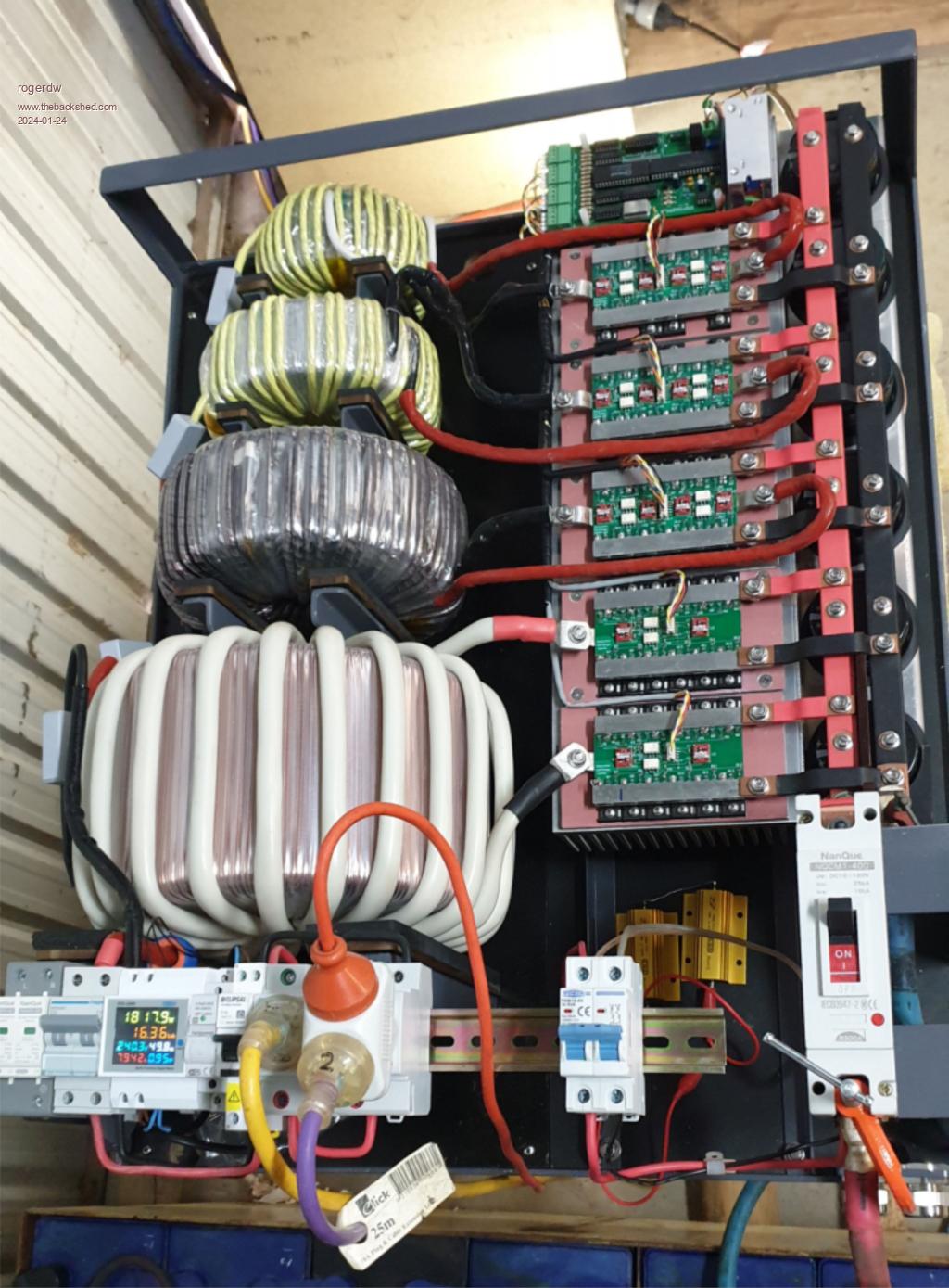

It's been a busy day today and I finally got the thing up on the wall.
I had my wife and lad out helping me too  ...  and you were right Klaus, it probably wasn't a good idea to mount it on the wall  ...  but it's there now.
I pulled out the largest toroid before we put it up  ...  and man was it a struggle even with that out. Then my wife went on shift so I lined everything up and lifted in the big one!!! 57kg  ...  and it's been years since I've been in a gym. Lucky there were no OHS floating around either.
The cables back to the meter box are routed and ready to be connected, so will call my electrician mate back on Monday. Getting close.

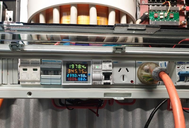

I've run it a lot already (before mounting it on the wall) and it's clocked up 350kWh so far. The pool doesn't know what hit it  ...  the pumps been run all day and almost every day  ...  and for the first time in 10 years I turned on an airconditioner in my workshop on a couple of hot days.
I still have to fit the fan  ...  it's one I pinched out of an old airconditioner  ...  a barrel fan virtually the full width of the inverter  ...  and will blow up through the toroids as well as through the heatsink  ...  but I don't think it will be needed very often because it seems to run pretty cool so far. In fact even on hot days I didn't measure anything much over a couple degrees above ambient.
Oh and I ordered a kilovac solenoid that I'll fit behind the circuit breaker as just one more line of defense if it needs to be shut down in a hurry  ...  and of course I'll need to build a controller of sorts for that too.

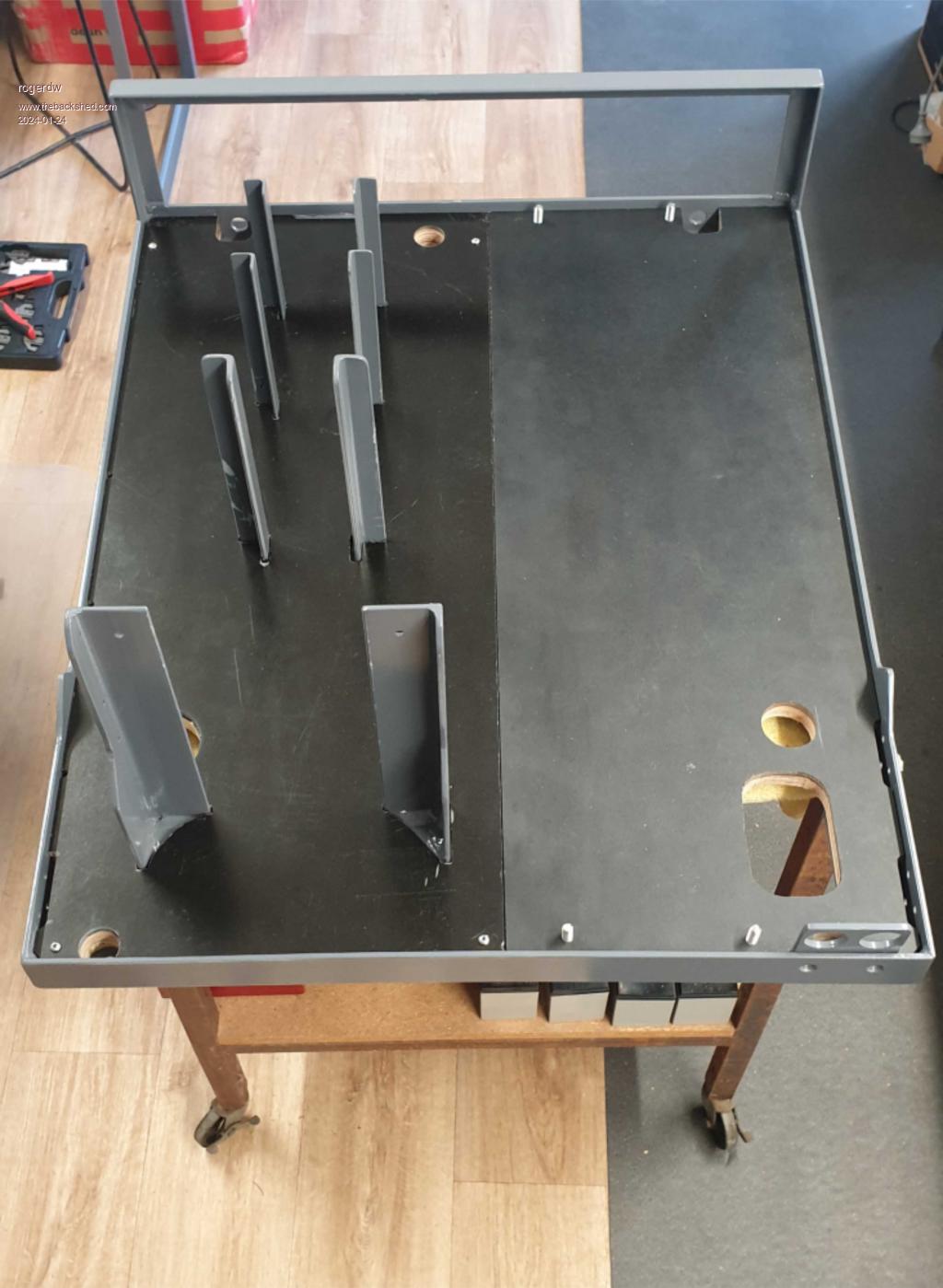

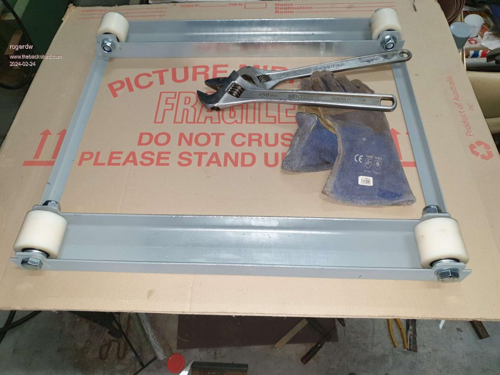

My batteries are definitely staying on the ground  ...  and I built a little dolly for them so they can be maneuvered around if necessary. They won't be steerable (unless I use the crowbar again) but they roll extremely easily. I'm quite amazed seeing they weigh 1,300kg. Pity I can't post a video.
It's bigger than it looks too  ...  they are 18" shifters.

Wow Well done Roger! I've been quiet over the last year as I have gone back to full time work. I thought I'd check in and see what's been happening. That is such a neat build. The half bridge boards, the welded brackets... Looks awesome!
Does your warpverter also sound like a robot when the load changes? Or is it a constant "standard" 50 hz hum?

Hi Phil, thanks for the kind words and good to hear you still visit from time to time.
It's finally all coming together which is about time  ...  too much time wasted on other useless stuff.
It has a fairly quiet 50hz hum/buzz which doesn't really seem to change when the load changes, though I did notice a slight change when I went from non loaded to 2.5kW of motors. It's going to live in the next section of shed on from my workshop, and even while it was in the doorway on the trolley I could only hear it if there was no background noise  ...  and when I slid the door shut I couldn't hear it at all.
I do hear the fan turn on in the charge controller, which I can just hear in the background. It's a little 12v barrel fan. So far it's been handy to know when the mppt's get warm enough to need a fan.
Are you still using your Warpverter  ...  and did you ever finish your 3 phase one?

Oh my Roger, you really went to town with your warpverter build   .
And I thought mine was elaborate . Well, since my warpverter no longer exists its yours that's on top of the hill now .
Regarding that copper static shield, again you have bettered anything I have seen. I did not think it had much effect on my warpverter but I left it place when I re wound the big transformer primary for an EG8010 inverter. As I already have a similar 6KW inverter with an almost identical toroid, but no static shield, I should be able to see if it makes a difference with interference when I compare those two 6KW inverters.
That is some time off as I'm still waiting for the PCB's for the second 6KW inverter.
I cannot see any chokes in your warpverter so I assume there are none? Most of the noise my warpverter made came from the big 'swinging' choke I put there on Tony's advice. I'll try that choke in the new 6KW EG8010 inverter.

Haha thanks Klaus, been a long time coming.
The shield was hard work and took some time but for a change I got stuck into it and got it finished. The .1mm was pretty thick really and it was good to work with because of the strength but it was nice to finish off with that adhesive copper tape being so thin and flexible.
I will be interested to see the end result of the test with your tx with copper foil and without. I do wonder how the originals get away with the long lengths of ribbon shield as against our single turn.
And you're right I don't have a choke in mine, Tony didn't seem to think it was really necessary so I didn't argue. One less task.
The inverter does have a bit of a hum/buzz but it's certainly not excessive so I'm not concerned. I spent some time with a stethoscope to find out and strangely the medium tx seems to be the louder (the outer primary winding)  ...  followed by the large one.
I'm slowly loading it up and hit it with the air compressor today. Was interesting to see the wattage creep up as the pressure built up.
The electrician called in to check it all out and will be back in a few days to hook it up. Moment of truth coming.
