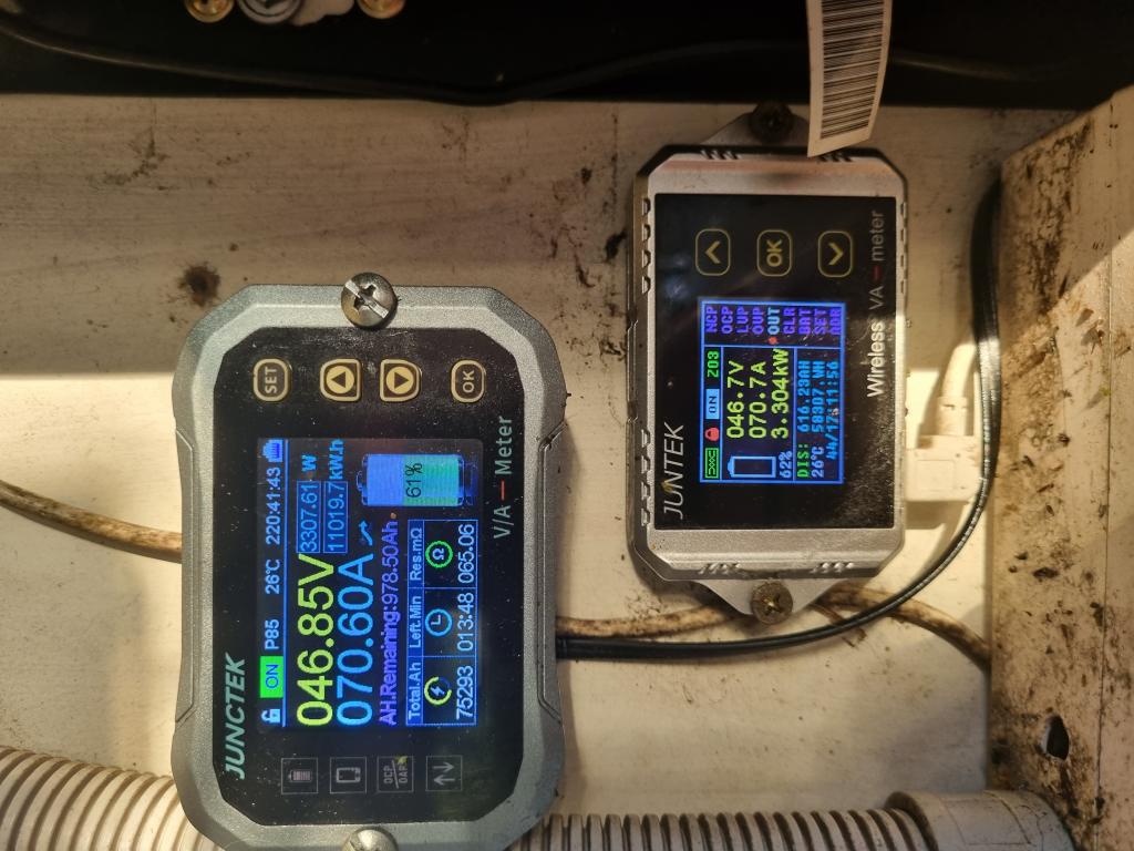

Ive attached a photo of my system after a night... they seem to be pretty spot on..
The one on the bottom is the original and is about 5+ years old, the top one is about a year old...

Thanks for the pics though! You also mentioned that you tried one of the "dumb" meters similar to my original suggestion - what was your experience with that?
As for the hours thing - I meant that in the manuals for both devices it says the time counter runs out / resets after 999 hours, which is 41 days. So I was wondering if the capacity count ALSO resets back to zero after 41 days, since it needs a time measurement to make that calculation.

No, the current measurements never " run out " .. ive never even noticed the " time " on them, as i don't use that feature. maybe its for people who track running time or something.
the other meter seemed quite good, just was completely useless to me as it ONLY recognises current flow, charging/discharging reads the same.
