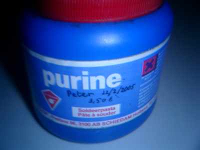

Know the stuff you mean, Bruce:
It's called 'Purine' over here, probably a local trademark though. I have a jar of I guess about 200-300 ml of it. The stuff isn't expensive either, but can make all the difference when soldering. The stuff I use is a grease-like substance though it comes in syringes too. Really handy when you have to solder or tin larger things where the flux inside the solder isn't enough for proper wetting. Of course, it's not a substitute for proper cleaning of the wires/joint...
I don't use it for soldering PCBs though, the flux inside the resin-core solder is usually plenty enough for that, plus I find that purine/solder flux does conduct some. Learned that the hard way... So if you use it when soldering PCBs, especially high-impedance circuits, it'd require very thorough cleaning. Keep in mind that there are also solder fluxes that contain acid (HCl), one well known product here is called 'S39'. avoid these acid-containing fluxes like the plague for anything but plumbing (though it's nowadays illegal to use the original S39 for that here too, but I understand they've changed the composition of S39 so it now no longer contains hydrochloric acid and is much less corrosive).
Just checked: I bought my jar of Purine on 22 feb. 2005 for E.3,50. And just noticed I don't have that much of it anymore... better get me a new jar soon. I usually refill a few smaller containers that I keep in the various toolcases and on the workdesk. Will probably fill a tube (as used for toothpaste; you can get them from a pharmacist) and a syringe as well, for easier dispensing.
I'd be handicapped if I didn't have that stuff anymore....
Flux paste/Purine is normally available in every hardware store over here, I'd be very surprized if something similar wouldn't be available in Australia too. Did you try googling for 'solder flux'? If you really can't get it over there anymore, let me know and I'll fill a film-container with the goo and send it your way.
