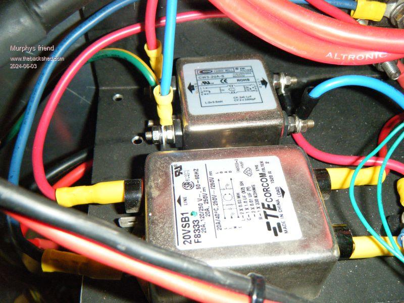

First my 2x20A interference suppression modules:
Doing that increased the idle power to 22.8VA

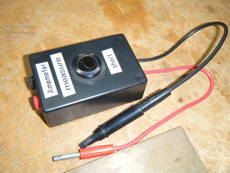

On another matter, I'm sure I'm not alone in having to swap blown multimeter fuses by forgetting the inrush current can be many times the running current of things containing transformers or capacitors .
For the above tests I used this cheap little home made gadget:
The multimeter, set to Amps, is plugged in at one end. The 2 leads from the box then become the multimeter leads.
Switch it to 'short' to connect up and power up. When running, switch to 'measure' and read the milliamps that the meter fuse easily can handle
