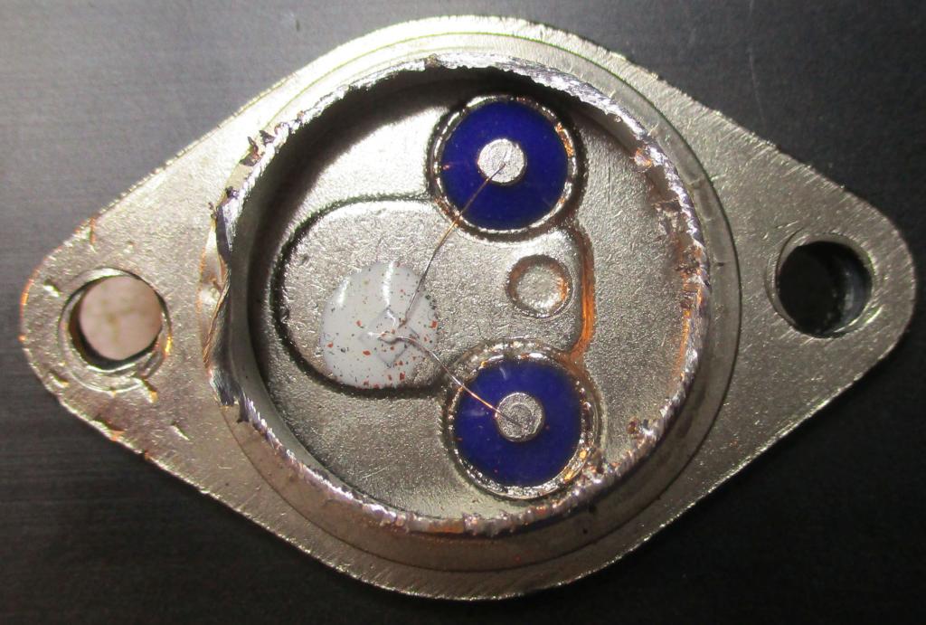

I cut one open to see, and......there is no way the wires from the die can handle 10A!!!!
This transistor is capable of 10A continuous, and 15A peak.
The BASE current can be up to 2A, and I doubt these wires can even handle that!
These are the linking wires inside the TO-3 can:
FAIL.

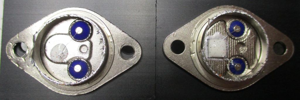

UPDATE:  Here is a photo of the fake on the left, compared to a genuine one on the right.  I sacrificed one genuine transistor, as I wanted to see the internal difference.
Check out the MASSIVE die-size difference!!!!!
The connecting wires from the die, to the base and emitter pins are still thinner then I thought they would be, but my guess is that these wires(on the genuine part) are some special kind of linking wire with very low resistance, and can obviously therefore handle the rated current of the device.  Might even be pure silver or something.
But that die-size difference!

Wow Grogster, that is a massive difference in die sizes.
As you say the wires are not much different but the die certainly is.
I wonder just how much money the counterfitters are saving by making these copies. Surely they would have to sell thousands to be worth the trouble and to make much on them

Posts: 10070
Posted: 06:49am 17 Jul 2024
They're not "Making" the copies, they take either reject product, or a totally different product that LOOKS the same, and then they thwack a new label on it, saying that it is something it is not.
There is basically ZERO cost to them to do this, as they get the factory rejects at a rock-bottom price per unit, or sometimes for nothing at all.  Then they slap the new part number on the top, and sell it as if it is the real thing.

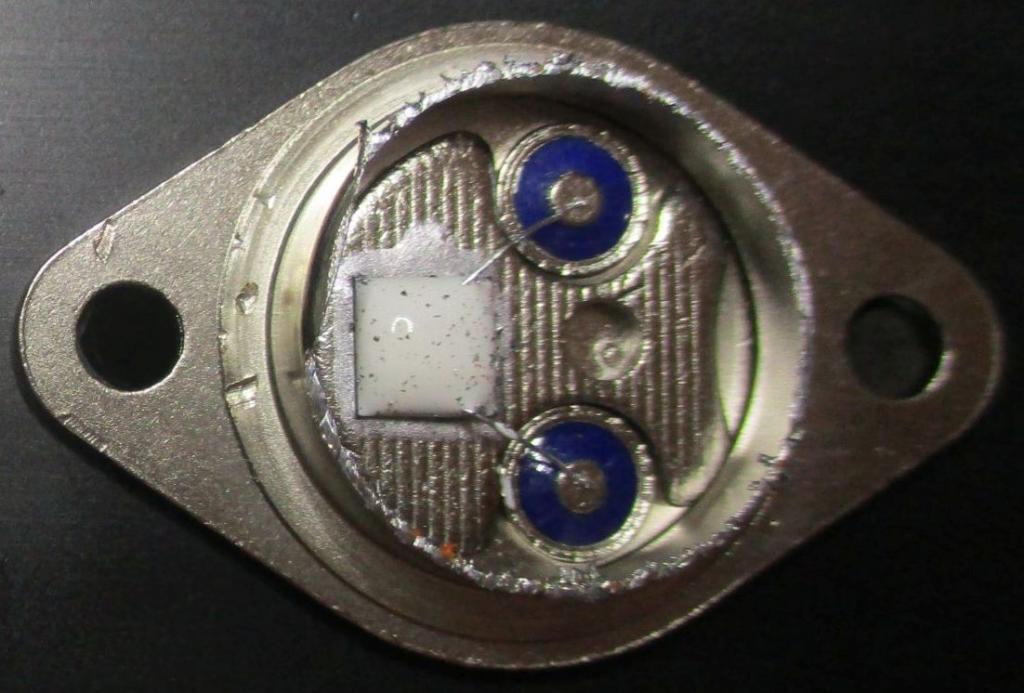

EDIT: I also note, that in the genuine transistor I cut open, the die is bonded to the TO-3 case using some sort of silver-paste-glue-stuff.
It it hard to the touch, and you can't just scrape it off.
But it sits between the bottom of the die, and the TO-3 case.
This will be the AUTHENTIC thermal bonding of the die to the transistor case.
Something that you can't even see if it was done, on the fake.

Posts: 10070
Posted: 06:57am 17 Jul 2024
Here is a closer look at the genuine part I cut open:
