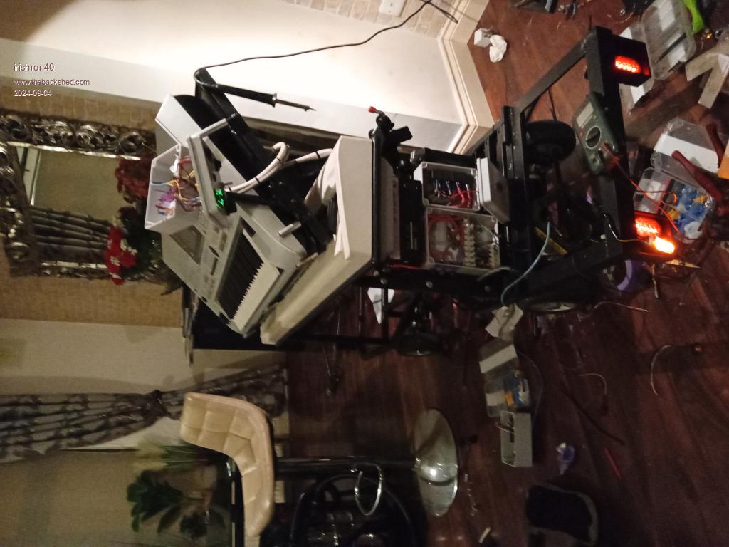

Motor is 24vdc and consumes about 12 A
But prefer if I can build a wee circuit
I do lot of busking with piano and keyboards, but due to my health lifting those and then also depending on parking ,I build this type of mobility scooter.  I have two 12v batteries and can switch with a button from 12 to 24 volt.
I use the 12 we hen playing music as also my inverter is 12vdc.  When I leave I switch to 24 and that will power my motor and steering motor. All I have to do is park it at ge location and switch keyboards on.😃

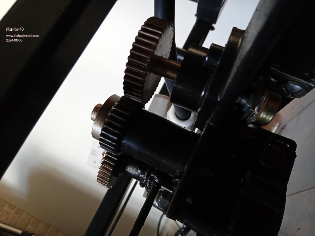

I also want this cart to be driven remote controlled as it's Easter for me to drive it in and out my van.
I have a wiper motor installed and also a potentiometer connected to the wiper.
I bought a transmitter and receiver which I also will post photo off.
I also do have a small servo, from which I intend to remove the circuit board and install that inside my wiper motor.
To make this steering work I'm sure I am missing one or 2 parts. I believe I also need a h bridge. But which one ?
As my help greatly appreciated
