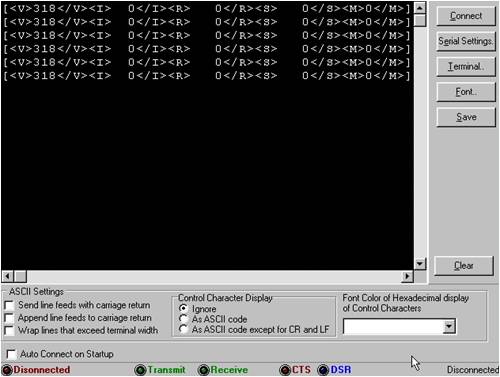

Good news!
No modifications needed because is working ok. The pulse counting wasn't accurate until I used (on breadboard) a optocoupler between TTL pulse generator and microcontroller pin to kill the noise.
Glenn please, if you want, make a software version for this logger output.
It output <A>,<I>,<R>,<S> and <M>
The Gill's breadboard for circuit testing:
Here are a 7805, a 4N35 optocoupler, 74LS00 as pulse generator, two voltage dividers, serial comm. cable and pic12f675
Oops! Javascript resizer didn't worked?
P.S.: This controller is the result of this topic.Edited by vasi 2009-05-26
