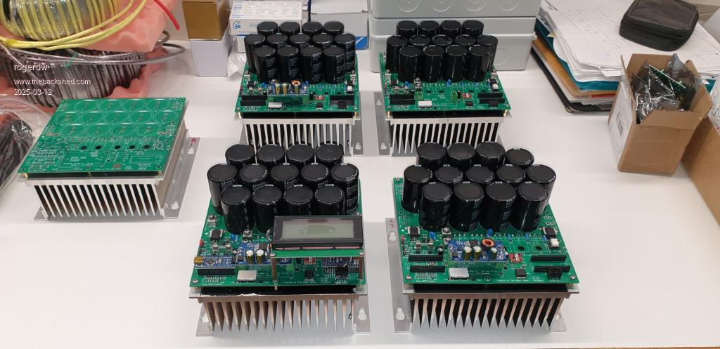

I also use the same supply on my MPPT controllers. I fitted plugs and sockets so they can be swapped out easily.
I managed to blow up a few early on until I learned you shouldn't power down an MPPT without first shutting off the solar input. I bought some of the regulator ICs off ebay and fixed them up. I know they're cheap and I have spares  ...  but I hate loose ends.

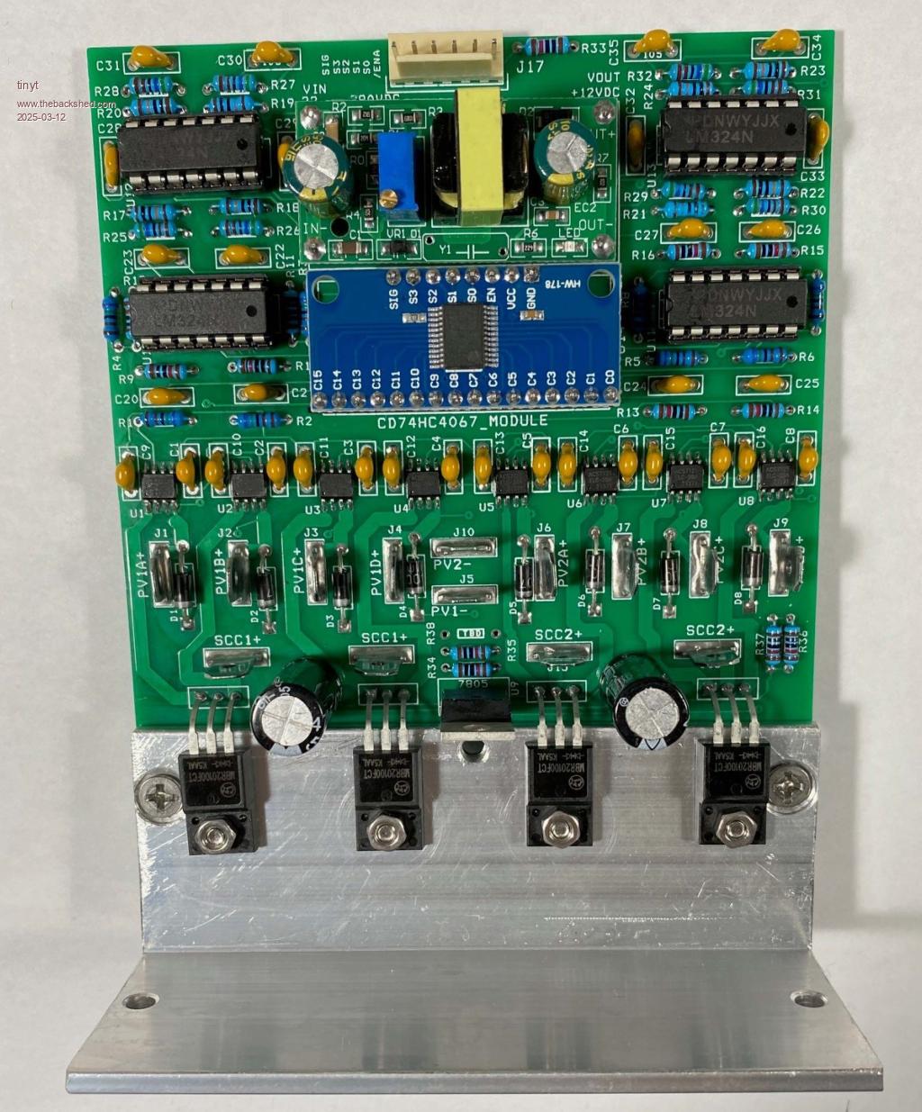

tinyt
Joined: 12/11/2017
Posts: 564
Posted: 01:05pm 12 Mar 2025
  rogerdw said
  oreo said  I have been using these and found them to be reliable for me.
Adjustable output, but lower current
Isolated 22-290vdc to 3.6-15vdc buck converter
I hadn't seen these before, they could be quite useful. I might get a handful for a rainy day.
I have been a bit doubtful of the usual 240v plugpack type boards because some of them don't start reliably at lower voltages  ...  and I'm running 48v, so it can be close.
I did just use one on the new control board for the Warpverter  ...  but I checked it over and over again to make sure it would always start from about 46v and upwards.
That is what I also use in my PV Combiner Monitor board (Solar array is 21 panels with VOC of 109 volts) for my latest 6KVA solar project. Running for two months now, so far no problem yet.
