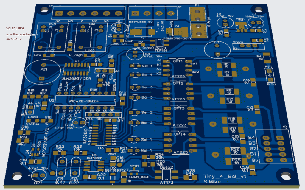

I have some small 4 cell 10-20 AH batteries (4s - 12V) out in the field and require a simple BMS to keep them in tune, there are inexpensive off the shelf products available, but I prefer something I can fix if there is ever a problem, so DIY it is.
This simple design uses inexpensive high current opto mos switches to both sense the cell voltages using a resistive divider and to apply a small 350 - 700mA resistive load for cell balancing. These switches have a 1.5A current rating and a very low on resistance. Serial first 4 bits select cell voltages, remainder select the load resistors.
An 8-bit serial constant current led driver is used to address the mos switches as required. A single mos switch coupled to a TL431 acts as a reference for calibration.
Voltages are measured with an MCP3221 12bit I2c A\D.
Two isolated relays used for over\under voltage output, a high current high side mosfet is used to switch the battery load (up to 10 amps) or turn on a large DC contactor relay when voltages are in limits.
Will get a board made up, test and report back here with a circuit and software.
PCB is 100 x 97mm

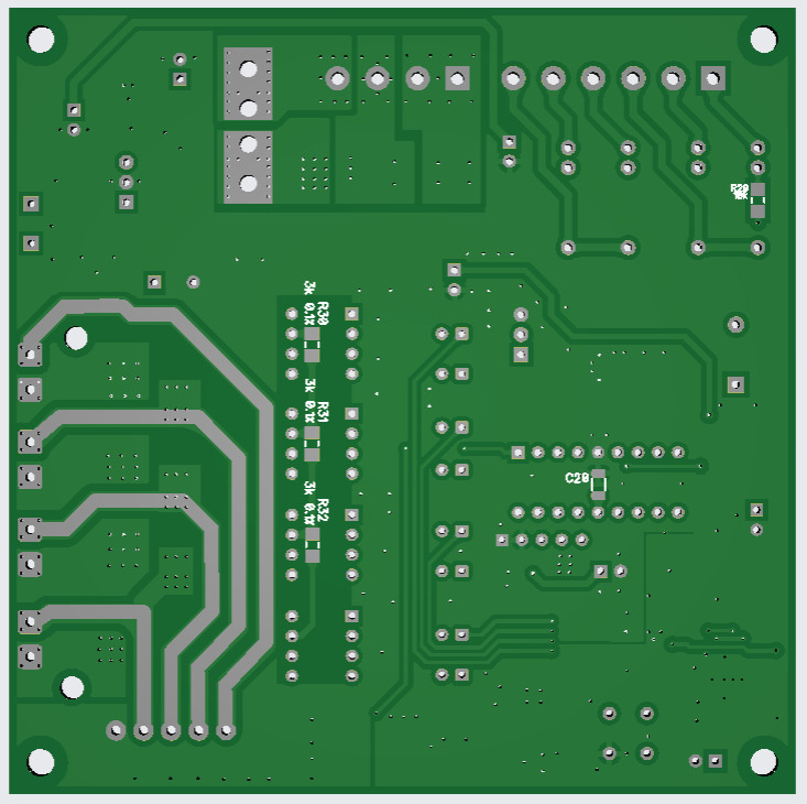

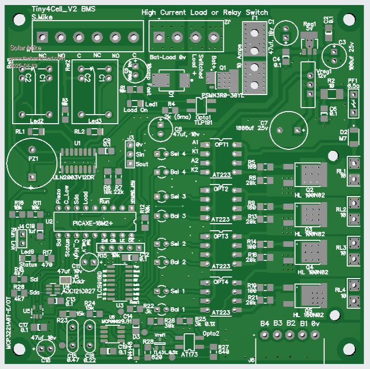

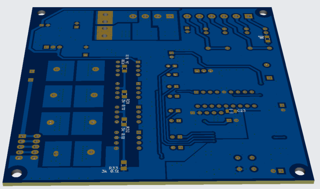

The design would work better for these larger cells if the load resistors were mounted externally an a small heatsink, even better, would have the balance currents increased to several amps. To that end I have altered the pcb some what to have low RDson mosfets driving the loads, the optimos switches now power the gates rather than the full load, the HL100N2 mosfets wont even get warm and work down to 2.5v gate drive.
Here is the new pcb, sending off today, same size 100 x 100mm
