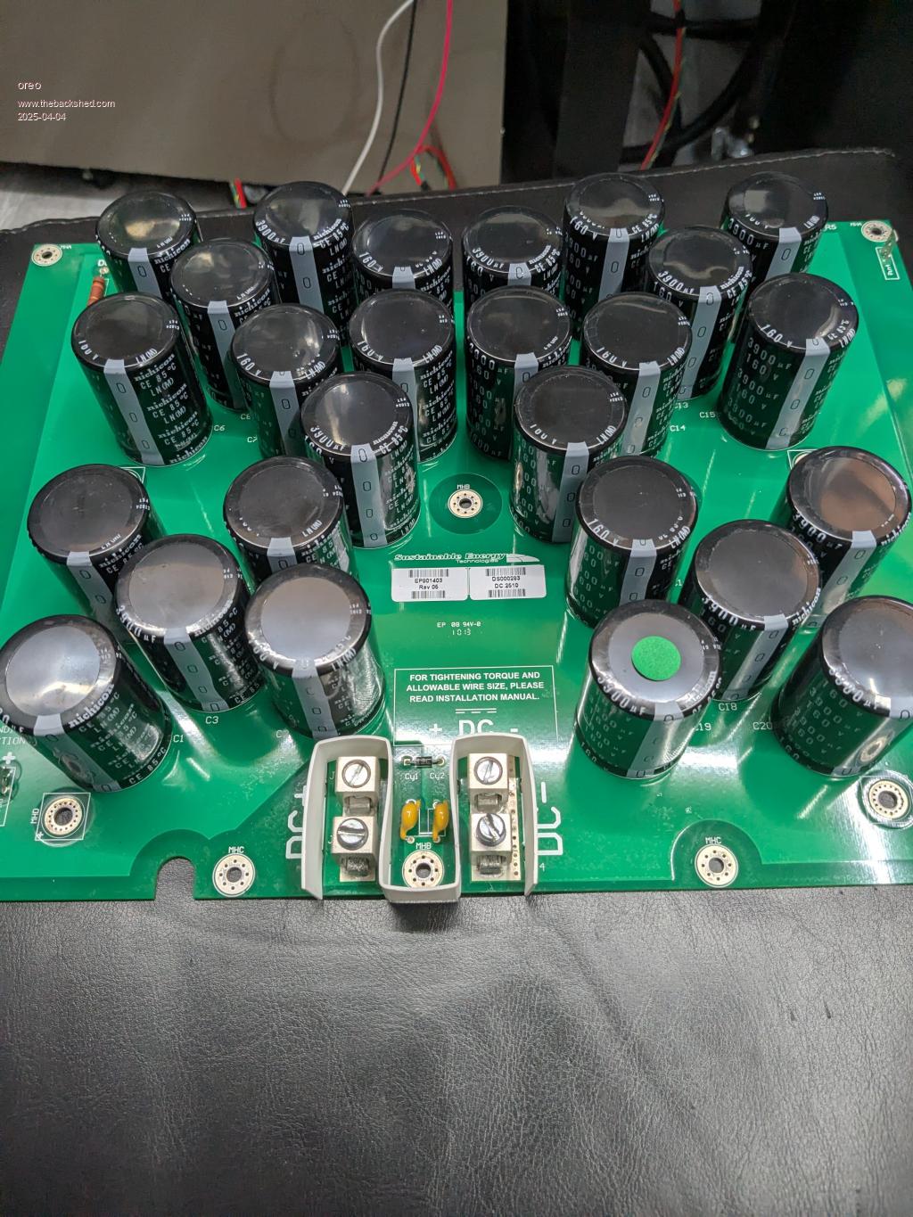

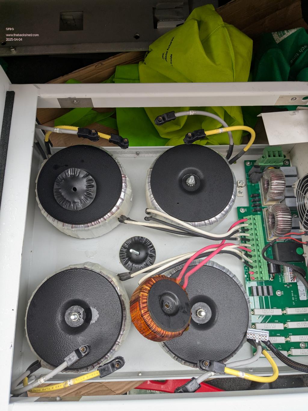

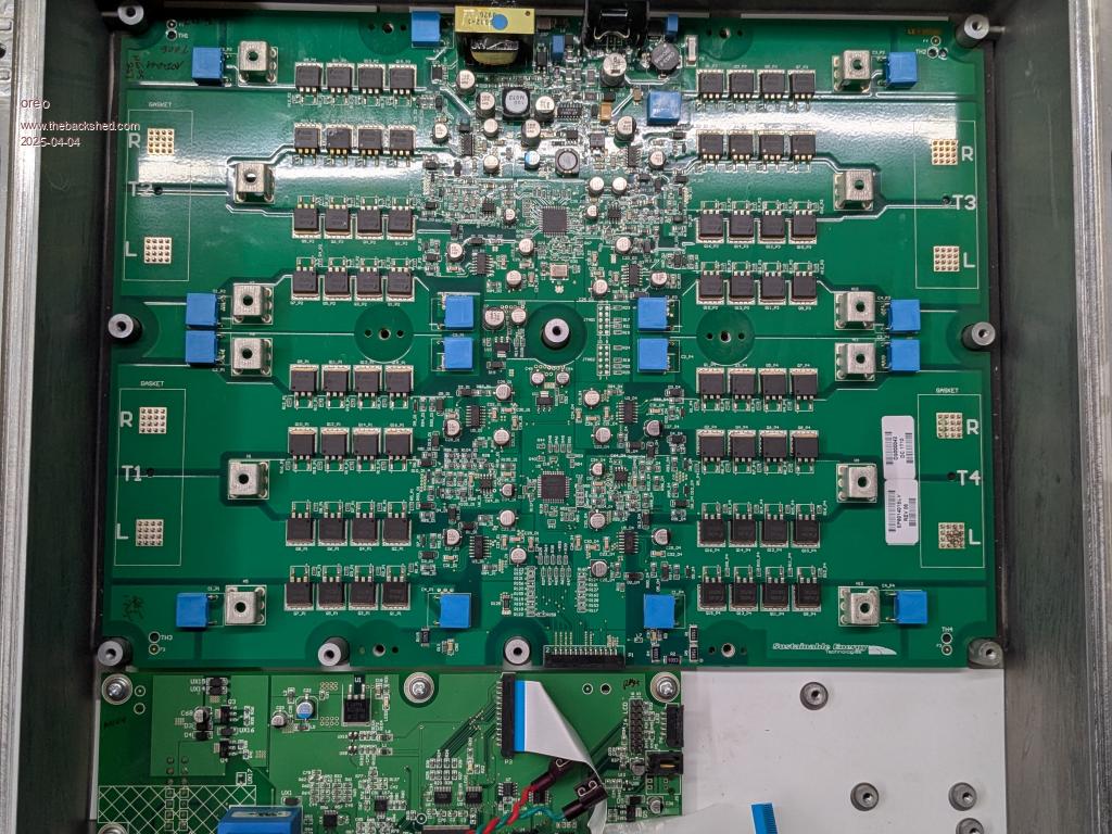

It has an all aluminum chassis and is made up of:
An input capacitor board with 25pcs of 3900uF 160v
A board with 4 inverter sections, each using 4 sets of 4 150v 180a mosfets.
And a transformer section with 4 toroid transformers and 2 1mH chokes and a filter board.

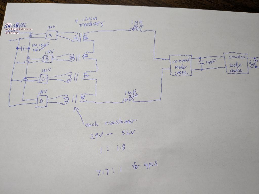

And now the interesting part (s).
1. There are 4 separate inverters (ok, maybe not that interesting)
2. The transformer outputs are connected in series (not parallel)
3. Between the inverter output FETs and the Transformers, there are no inductors!
I jotted down a block diagram/schematic.
So they put the inductors after the transformers but before the filter capacitors.
I have not see this before.
Maybe it only works with smaller power transformers IDK.
Thoughts?
Greg

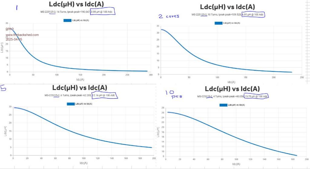

I threw one of the 1mH/25A inductors on my saturation tester, and it saturates pretty hard at 36amps.
Honestly, the inductor selection is a bit of a mystery for me right now.
After reading a lot on this forum, I see that over the years the design thinking on what the core should be has changed.
A number of years ago it was #1 and today it is #3.
1.  Gapped Amorphous Nanocrystalline cores (Aero-sharp) measured so they absolutely won't saturate while in operation.  (note I am guessing the makeup of these cores based on description)
2.  Gapped ferrite measured so they absolutely won't saturate while in operation.
3.  Sendust (Kool Mu) toroidal cores
I have been using the Micrometals design tool, "Inductor Analyzer" to run simulations on multiple core sizes, materials (Iron powder and Sendust) and stacking, to see what the effects are.
I have built 3 different chokes using a 3 stack, a 4 stack and a 5 stack, and measured the inductance at different currents on my saturation tester and have found that the program mirrors what I am measuring in real life. (Eureka)
You probably already know this, but here are some of the results.
What happens when you use a core with 60 vs 125 permeability.
(You get more inductance per turn with the 125, but if both cores start at the same inductance, the 125 perm unit will have less inductance at 100 amps.
What happens to saturation when you stack cores and keep the same inductance.
(As you add cores, the saturation improvement becomes less.  With 1 core you have 4uH/core, with 2=3.5uH/Core, 5=2.5uH/core and 10=1.7uH per core)
If you are doing this with 40 permability cores, it gets worse.  With 1 core you
have 4uH/core, with 2=3.0uH/Core, 5=1.7uH/core and 10=1.2uH per core)
Note that after I ran these simulations, I realized I had the frequency set wrong.  Setting it correctly changed the ripple current, but not the inductance.  (less than 1% change)
Greg

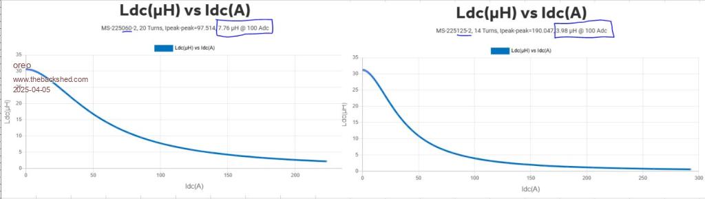

maybe that was a bit overboard, but anyway back on track now.

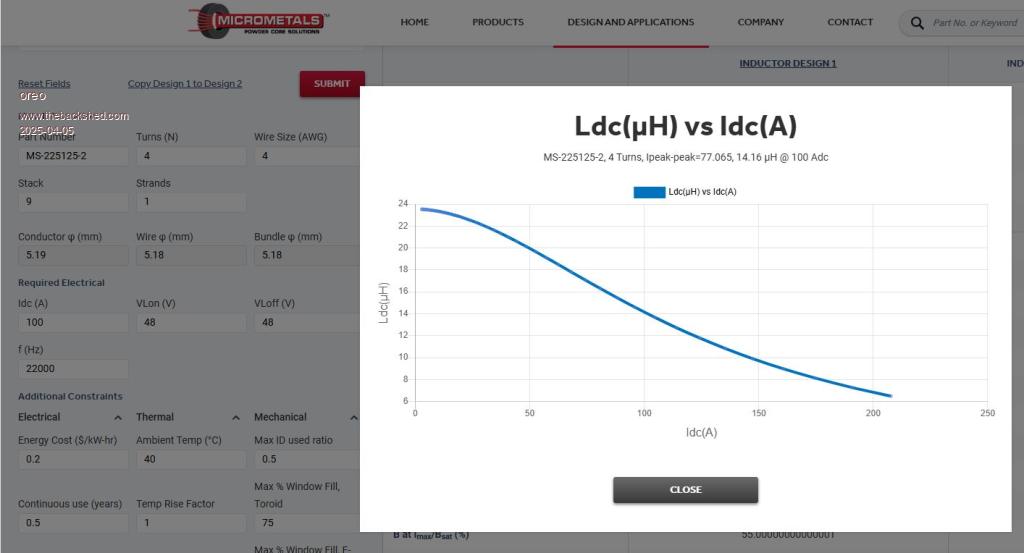

So if we look at Keepis build (also Mike?) we see he is using stacks of 9 pcs of A225125 cores (MS-225125-2 equivalent)
Here is what this looks like in "Inductor analyzer".
Now I understand that he has a mixture of cores being used, with some MS-226 sized cores which are 1mm larger in diameter and with a 10mm smaller ID, but largely these only measure slightly better than the above.
So Keepis is running his inverter with up to 400 peak amps.  At 200 amps he has about 7uH x2 =14uH.  At 400 amps he has about 5uH.  That is not much, and his system has been running like a top.
Any thoughts on why this is?
1.  Maybe full saturation is really bad, but near total saturation is ok?
2.  Maybe the new inverter design is so robust that having low inductance at high currents won't kill it?
3.  Maybe the toroid design used by Keepis is less inductor dependent? (I read that the amount of transformer coupling there is can affect inductor requirements, but am unsure if the way they are stacked results in less coupling or not)
For my intended upgrade, I need something on the inductor front.
I found some 90x60x20 Amorphous Nanocrystalline toroid cores on Ebay, which if gapped at 1.2mm and 2 groups are used stacked 4 up will result in a saturation current of >200A with 60uH  (72v Battery).  I would need to buy 4 more cores so another $18usd to get them into Canada.
Amorphous core sold as "Ferrite"
Alternately I see some cores on Alibaba, similar to the ones Dex has used.  These are slightly smaller (MS-520075-2) at $10.40us each (min 1).  Using 2 stacks of 2 would result in 60uH, dropping to 30uH at 200A.  Alibaba is saying my first order would ship free, but IDK.
Pretty massive Sendust cores
Or maybe TOFTT and run secondary inductors which I already have?
Greg

  Quote  So Keepis is running his inverter with up to 400 peak amps.  At 200 amps he has about 7uH x2 =14uH.  At 400 amps he has about 5uH.  That is not much, and his system has been running like a top.
Along with the smaller Choke inductance at high currents, the lenght of each choke winding combined with using slightly smaller gauge cable.
This results in an additional small resistive loss at normal running loads, but one that really comes into play under very high current short duration events, thus helping the FETS survive switching into the extremely low impedance Toroid primary.
I may have to do some measurements on my test setup and try secondary chokes and a filter. I'm sure if Wiseguy gets the time he likely will do the same, just need to find the time.
BTW with the dual inverter load currents are halved, 400A with two power stages each stage with two chokes and each handling 200A.
EDIT:
  Quote  Maybe the toroid design used by Keepis is less inductor dependent? (I read that the amount of transformer coupling there is can affect inductor requirements, but am unsure if the way they are stacked results in less coupling or not)
There is no coupling and the choke works exactly the same on a single Toroid, and is also the correct (sweet spot) value for that single Toroid.
Edited 2025-04-05 16:09 by KeepIS
oops, I must have misread that.  (I really wanted you to be pushing 400a through each power stage though!)
Anyway so with 200amps, your inductance is at a much more reasonable value of about 14uH.  Ok so this is making more sense.
Thanks for your comments!

Greg FYI I ran some calculations on the KeepIS chokes and this is what I worked out.
I was looking at their values at around the Bsat point but note the Bsat was at 400A for the blue but only ~ 200A for the black ones.
2 x blue stacked 276Al, Ae= 4.5742sqCM = 4.4uH for 4Turns and 415A at 1T Bsat
4 x Black stacked Al=1148 Ae=9.1484sqCM = 18.5uH for 4Turns 198A at 1T Bsat
Intuitively a total of 22.9uH @ 198A @1T reducing to ? at 415A a bit more than 4.4uH
a lot less than 22.9uH
As you have two of these the 22.9 doubles to 45.8uH @ ~200A, but reducing to maybe 10 to 15uH at ~ 400A
I did these calcs quite a while ago, it is not too dissimilar to your work despite the inductance being higher for when he was running 6 cores not nine, so why were they not higher for nine?  My Al values were for Molypermalloy (MPP) which are normally Blue, for the Black I used KoolMu data. After re-reading this not sure if it is helpful or not....
Edited 2025-04-06 10:10 by wiseguy
