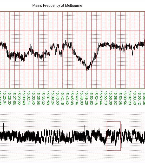

I store the measured mains frequency and phase once a second into a database.
check out http://1eq2.cc/f3.html  for a view of what it is at Notting Hill, VIC.
I show a phasor too, which gives an idea of how fast mains frequency phase
changes over time.Green is a fixed reference, Blue is what it was a second ago.
Wiseguy in a recent post wrote about mains freq stability.
another thing I made shows the entire 24 hours of data, you can select recent days.
see http://1eq2.cc/f5.php?ddate=20260128 for instance. it takes 10 seconds to show the data
so give it time.
Today's data will be a bit wobbly due to my calibration and testing, in preparation for this
post here. there will be some spikes and other rubbish in it.

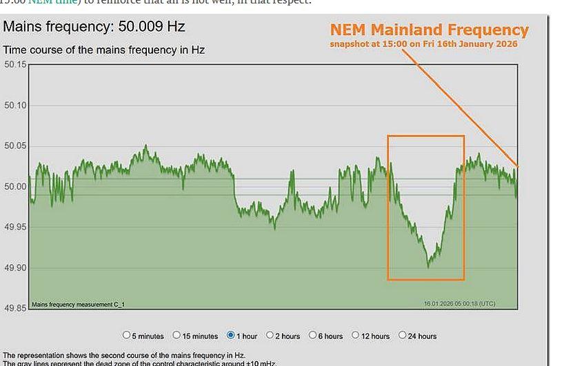

here is some "proper" mains freq data, from https://wattclarity.com.au/articles/2026/01/16jan-frequency/
and my data

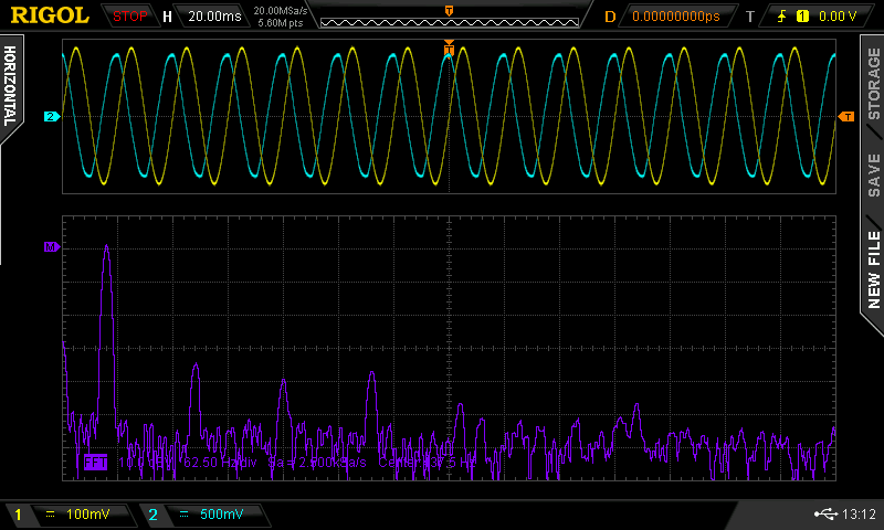

before filter:

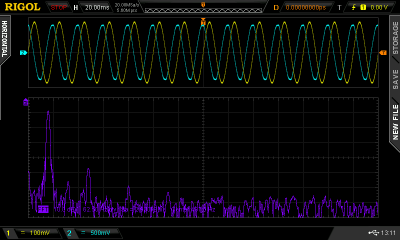

after filter:
so the 3rd and 4th harmonics of 50Hz are low less. I wanted the 100Hz harmonic to be

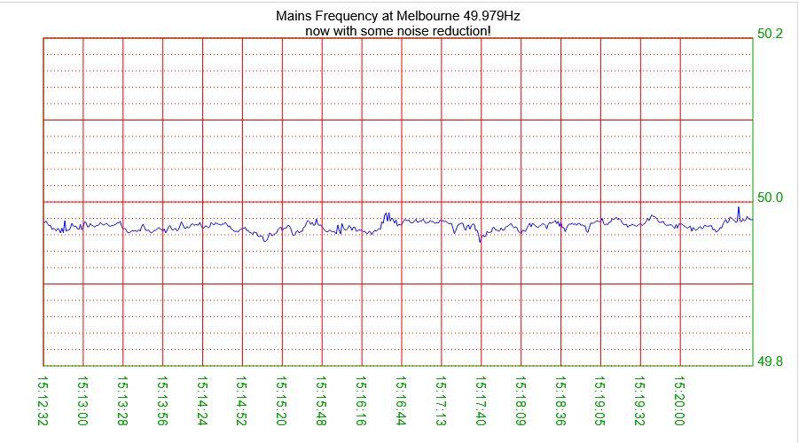

reduced too but it seems not much was done to it.
the resulting frequency graph is a lot cleaner though.
