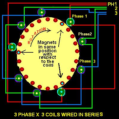

If the F&P Had a radius of 3.5 inches, 24 one quarter inch magnets, a .6 meter blade diameter How would you begin to achieve the 14 volts with a bit of current to charge a battery and not overload the little blade. the above given can not be changed. I would like some specs on your first test coil.
I omitted an item in my original post which i will now edit. I used 3 coil's per phase (9) total, this has a three point cog. where a 3/4 ratio (18-24) has 6.
A note about this drawing, the Coils are not equally spaced, you will notice the phase's 1,2,3, are grouped
close and then a wide space, the pattern repeats.
In this way 9 coils can replace 12 or 18 and reduce coging and inductive reactance and lessens the load on the small blade

Greenbelt
Joined: 11/01/2009
Posts: 566
Posted: 01:04am 01 Feb 2010
GWatPE This is what got it started, The project is not mine. The man wanted some help on flux and wire turns relationship. Some time in August he made a request
fluux and turns of wire
Drawing by MacG
But I saw none offered other than suggestions to change his plan , do it different make it like my F&P or axial flux, Never use iron in a coil Melt your magnets down in a pot of aluminum . Perhaps the man would prefer to do it his way. I tried in my limited ability to give a basic accepted way to wind coils with known values of flux for Iron core coils. This is what he ask for.
I understand the suggested extra copper and modified Loading, I presume air core coils or non magnetic core material would enhance efficiency though I have no way to verify it, I would be confident that you have ben there, done that. I also believe additional Iron C-coils will not give any improvement.
