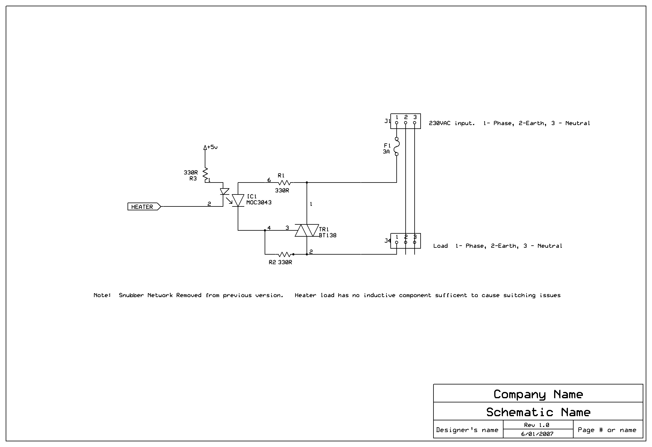

Posted: 10:41am 09 Jan 2007
Suggest you use a MOC3043, almost the same as the 3041, but it only needs 5mA to turn it on. If you have an inductive load, you might want to put a 39ohm resistor and .01uF Cap in parrallel with triac.
You can use the FETS you suggested in a similar way.   I've got lots and lots of mains switching being done this way of a PIC (picaxe).
Just be careful. The mains bites.
