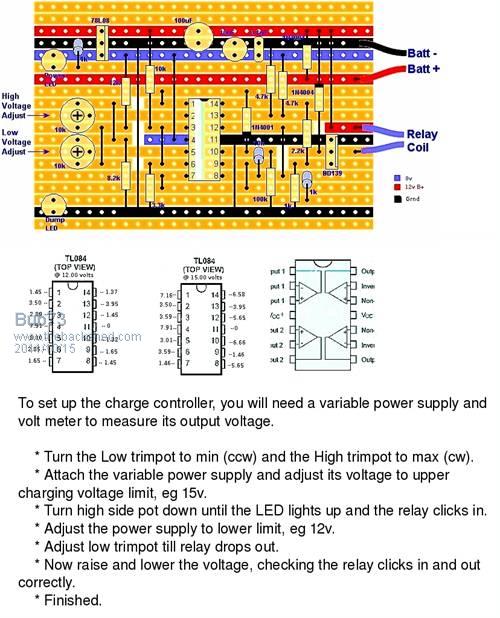

Posted: 07:16pm 13 Oct 2011
Hi, everyone! I'm a newbie here and would like to try the charge controller circuit linked above. I'm just wondering if anyone can show me calculations made for the op amps?
Thanks,
Joseph
Bub73
Joined: 10/12/2009
Posts: 116
Posted: 04:03pm 14 Oct 2011
Welcome to the forum jjbob27,
Maybe this pic will help if not do a forum search for TL084 controller should bring up lots of hits.
Bob

http://www.thebackshed.com/Windmill/articles/TL084-Controlle r.asp
Here's the full details from the site. Welcome, and have fun. I'll be finishing mine up in a few weeks after I've done my finals. Will try and do a bit of a write up as I go so people just starting have an idea of some of the pitfalls you can fall into that these crazy experts don't get stuck on. ;)
