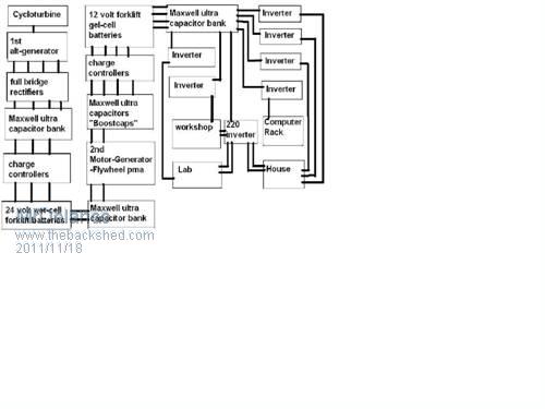

I use the cycloturbine to generate the motion to run the 1st alt-generator. From the 1st Alt-Generator the output goes into a bank of four(4) full bridge rectifiers. I rectify the voltage and charge a Maxwell ultra capacitor bank setup to 24 volts. From this I enter the charge controllers that charge three banks of 24 volt wet-cell forklift batteries. From this battery bank I use a bank of Maxwell ultra capacitors to run a 2nd Motor-Generator-Flywheel pma that charges a bank of 36 Maxwell ultra capacitors "Boostcaps" before entering the charge controllers that charge another battery bank of seven(7) 12 volt forklift gel-cell batteries. From the 12 volt batteries I use another bank of 36 Maxwell ultra capacitors "Boostcaps" before entering the inverters that are used to power the house. Each Maxwell ultra capacitor is 2.5 volts 2600f at 8000 joules, there are 6 banks with 6 caps in each bank to build a voltage of 15vdc. This gives the bank of three(3)10,000 watt inverters a stable current input to handle multiple start-up loads and places less of a strain on the battery cells. There are two(2) more 6,000 watt inverters that run my lab and workshop. and another 6,000 watt inverter to run the computer rack.
To keep the Maxwell ultra capacitors "Boostcaps" from charging over 2.5 volts in the center of the stack, I built a charge equalization circuit for each row in each bank.
Ultra Capacitor video
Here is a block layout of the system.

One question:
Why the conversion from 24V to 12V?
Thanks,
DaveEdited by davef 2011-11-19

  daveF said   One question:
Thanks,
Dave
Hello Dave F;
I was only able to obtain 12vdc-120vac 10,000/20,000 watt inverters that were not working from the recycling center, I repaired them to working order. The Mosfets were burned up and a few resistors from a lighting strike so I repaired them and used them. There did turn out to be a plus side to this the mill charges the 24vdc bank and that bank supplies a constant current into the 12vdc side, it was also easier to monitor the gel-cell battery bank in smaller units. There are seven(7) banks of gel-cell's made up of 12 cell units in each bank, I separated them to a 12volt setup of 6 cell units in each bank for the 12 volts per rack, this gave me 14 racks at 12vdc and a charge controller is on each rack with a charge equalizer for each ultra cap stack.
I used what was available to me. The other inverters came from the same source.
I did have to separate the neutral and feed into separate circuit panels, two inverters can not be joined together. I split the three breaker panels into two units each. I was building a match transformer to tie all into one feed, but one inverter went down and I realized that if they were into one feed i would not be able to just share that load into another inverter. Now if one inverter fails I just switch the load to another inverter with a knife switch and that load is back up and running while I repair the failed inverter. I also installed a 220vac inverter to run my central air and oil filled baseboard electric heaters.
Regards Bob.

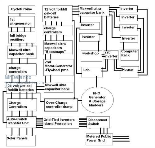

BOOSTCAP ultracapacitors can be discharged extremely quickly. The peak current is limited only by its internal resistance. Inadvertent short circuits are not fatal to the ultracapacitor. The actual limit is dependent on the size of the ultracapacitor cell. For matched loads, small cells can deliver over 10 amps, and large cells in series can deliver over 1000 amps.
My power system setup showing most of the sub systems and how the ultra-caps are utilized in the system.

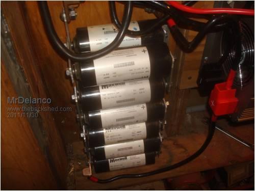

Ultra Cap bank on one inverter.
Battery Storage
Edited by MrDelanco 2011-12-01

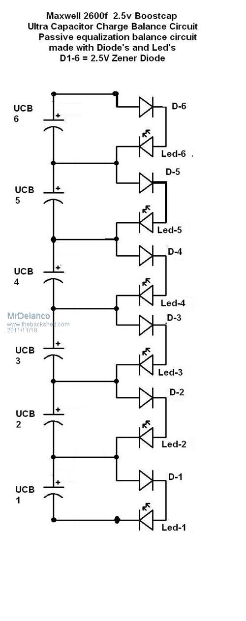

Mr Delanco, one thing that does puzzle me with your voltage equalizer circuit is why have you connected the zener diodes the wrong way round?
I always have them connected reverse biased to use their designed avalanche region zener effect.
Or did you mean just ordinary diodes and forgot to correct your parts description?
The way you have them connected they behave like ordinary diodes, perhaps that is why the LED's light up. Most LED's have a higher (than a ordinary diode) forward voltage so with just 2.5V available you might need 2V (depending on the LED colour) of that to light them.

  Tinker said   Mr Delanco, one thing that does puzzle me with your voltage equalizer circuit is why have you connected the zener diodes the wrong way round?
Hello Klaus;
Nice to hear from you.
I do not understand what you meant with this statement, "(depending on the LED colour) of that to light them." the led is on or off.
To answer the other parts of your question;
As the 1st ultra-cap attains full charge of 2.5 - 3.0 volts the zener diode allows the higher voltage to flow through lighting the led and balancing the charging of the 2nd 3rd 4th 5th ultra-cap's and so on down the line.
The led's light when the ultra-cap's is fully charged and the current is moving past them. An ultra-cap will take a fast charge this circuit was designed to move the extra current past the ultra-caps when fully charged and balance the charge in the center of the ultra-cap array. The extra current is channeled right into the charge controller's. Without this balance circuit the ultra-cap array would be in an uneven state of charge. As an ultra-cap's charge is used or drops below the 2.5 volts the led will turn off and build up the charge to balance the voltage in the under charged ultra-cap in the ultra-cap array, this happens very quickly and a visual scan of the panel shows what state of charge the ultra-cap array is in, when a load is being drawn the center section is blinking off and on as the charge in the ultra-cap array is balanced and in a ready state of charge.
Regards Robert.Edited by MrDelanco 2011-12-07

Tinker
Joined: 07/11/2007
Posts: 1904
Posted: 01:15pm 06 Dec 2011
Hi Robert,
Maybe you need to read up a little on LED forward voltage drop .
Simply put, assume you had a DC power source that can be increased from zero up and you had connect your LED to that (output set to zero).
Now, increase the voltage to the LED slowly until it lights up, that voltage is called the vorward voltage drop. It is different for different LED types and, from memory, the green LED had a considerably higher FVD (forward voltage drop) than a similar size red one. Once your power source has passed the FVD threshold you need to apply current limiting before turning the voltage much higher or the LED will burn out.
In your ultra capacitor case the capacitor itself acts like the above mentioned adjustable power source as it starts charging up. I do know how capacitors work BTW.
The LED would light once its FVD is reached at, perhaps, 2V. You can increase that level by introducing an additional series diode to give you an extra 0.5V (or 0.2V with a Schottky diode).
This is what you appear to have done.
But you call this additional diode a zener diode when clearly it is not functioning as such. Zeners are used reverse biased and would not work here as the lowest available zener voltage is too high to be useful in that application.
So, to make me happy and your circuit correct simply replace the word "zener diode" with the word 'diode', leaving the circuit as is.
As to your statement "designed to move extra current past the ultracaps", this sounds a bit joking as the LED requires perhaps 15mA to light up nicely and trying to pass much more than that destroys it quickly. So, the tens or perhaps hundreds of Amps arriving at the cap would *never* get "bypassed" through the LED.
All it does is indicate when the ultra cap has reached a certain terminal voltage - this also being an indication of the state of charge.
There *has* to be a separate means to limit the charging terminal voltage to the cap bank - a battery bank would do that nicely.
I know its nit picking but you came across as someone who knows this stuff and that slip puts a dent in that image .
Klaus

Hello Klaus;
You are not understanding the circuit design correctly.
The circuit works in my system as it is designed too balance the Ultra-capacitor.
An Ultra-cap is not the standard capacitor, and the zener diode is only allowing an over-flow of trickle voltage above 2.5 volts to pass and balance the Ultra-capacitor array, any other current is channeled through the ultra-capacitor's and passed down the line. The circuit is operating on one side of the line only.
Hope you didn't burn out too many led's or standard capacitor's.
I am not changing the circuit to make you happy, The circuit works as it is designed. Don't be unhappy.
I have posted the information about the ultra-capacitor's.
There is a subsystem not shown before the ultra-capacitor's which regulates and limits the input voltage to the array. This post was about the 2.5 volt ultra-capacitor's ability to enhance a wind system electrical output in low winds. Individual cells are rated to 2.5V each. There is no limit on the number of cells that can be placed in series to attain higher voltages using a 2.5 volt charge. Ultra-capacitors from Maxwell are rated at 2.5V each. They can be charged to higher voltages, but it should be noted this would effect the useful life of the product. Maxwell Technologies does not recommend the operation of the ultracapacitors above 2.7V.
This circuit diagram was shown as a passive equalization balance circuit for the Ultra-capacitor. With 2.5 volt zener diode's .
Regards RobertEdited by MrDelanco 2011-12-08
