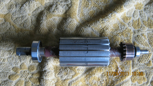

Posted: 06:08pm 29 Nov 2011
This is the armature i am working on. Thanks for the reply, what would the outcome be if I could add say 10 turns with 20 gauge for a total of 27?

Posted: 10:54pm 29 Nov 2011
What we need to work out is volts per turn. At 750 RPM it reached 13.5 volts with 17 turns, so thats 13.5 / 17 = 0.79 volts per turn at 750rpm. If you can fit 27 turns, then 27 X 0.79 = 21.4 volts at 750 rpm.
Then divide it down to a lower rpm. 750rpm / 21.4v X 13.5v = 473rpm.
So you will need 473rpm to reach 13.5 volts. Still very high. What about a slightly smaller wire? If you can fit 40 turns instead of 27, the rpm drops down to 326, which could work.

Posted: 11:15pm 29 Nov 2011
Hi Glen, I want to thank you for the help with this. You mentioned 25 gauge in your first post, I would think I should be able to wind 40 turn's with that, based on what you see in the pic. how much wire should I buy? There is a coating on the ends of stack and some of it broke away taking the wire off. Can I just lay a bead of epoxy down over this area? Or is there some other goo that is needed?
