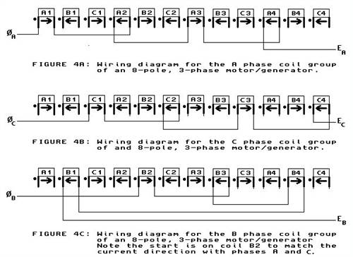

I think I found what I am looking for polyphase motor/generator the "how it works" section explains things how I see it in my head.
image owner Alan M. Swithenbank http://www.stanford.edu/~hydrobay

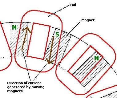

Looks like there are a couple of errors on Alan Swithenbank's poly-phase generator page. He has written the start of the 3 phase explanation while still thinking about his single phase build. So the reference to 8 magnets and the formula for calculating the number of coils needed is not correct, he is clearly using 16 magnets and 12 coils, equivalent of the bog standard otherpower.com axial flux machine.
However the process of creating the diagram to show the current flow in the coil is what I was missing.
Seems like the key is to draw the coils as in the diagram I posted above(minus the arrows), then looking at the rotor fitted to the stator with a north pole at 12 o'clock at the start of coil A1, draw the arrow to indicate the direction of the current flow in that coil. Then working clockwise around the coils, looking at the magnets over the coils and decide the direction of current flow and draw the directional arrow for each coil into the wiring diagram. This becomes the template for wiring the stator.
This is image is how I am looking at the current flow in the coil.
