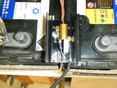

My battery bank here is 24V, made up from 2x 12V, 100Ah deep cycle batteries in series. There are 4 sets of these at the moment and they are connected to my new LIPO battery bank.
The LIPO takes much of the load now so the charge in the LA batteries gets only drained if an exceptional heavy demand from my 2 inverters is called.
Recently I have noticed on a routine battery terminal voltage measurement that one pair of LA batteries had a very uneven voltage. One was reading 14.5V while the other only showed 12.4V, taken while they were being charged and all other batteries were just about full and reading13.3-.4V each.
So the low battery actually never gets a full charge due to the unbalance, no good at all. I recently removed one LA battery pair as I thought one of them died of an old age (4 years) but I now think it suffered a similar fate.
What to do about it? Here is my solution and it appears to work, at least after one day of good charging @27V the battery terminal voltage was equal.
Its a simple shunt regulator, made from a heavy duty Zener, 5A diode, Transistor and a couple of power resistors. The shunt cuts in at about 13.5V so its heat sink gets barely warm during charging and there is no power drain overnight when the battery voltage settles to around 12.8V. The two leads have clip on battery connectors so the regulator can easily be moved to any other low reading LA battery.

Its still doing the job Russ, maybe a worthwhile gadget for your many batteries. I'll take it off that battery in a week or so to see if the recovery is a lasting affair.
I found all the parts for it in my bits'n pieces box so it did not cost anything.
Klaus

I would expect the battery is already shagged and the result will be short lived once the device is removed and the battery is cycled.
But worth a try for what its costed you.
In most cases its better to charge all the batteries in parallel for a period every so often to equilize them, although easier said then done in many cases.
Watching with interest, but my gut tells me its just CPR to a near to death battery.
Pete.

Maybe a poor connection or oxidised terminal in that bank. I see that a lot in parallel banks, particularly lightly loaded ones.
The symptoms for high resistance connections under load and a dodgy cell are pretty much the same.
